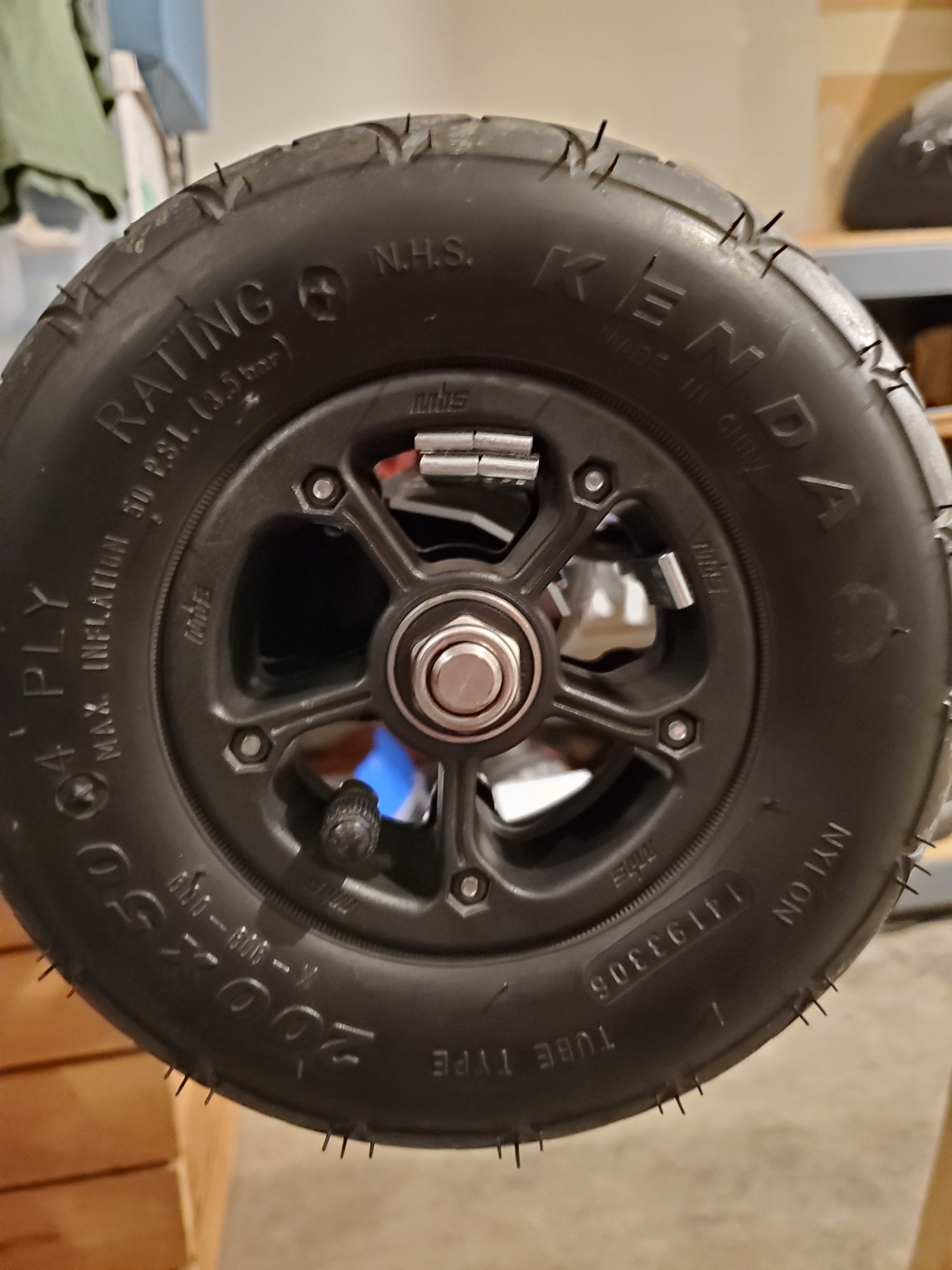

If i look on its side, it goes up and down. If i look at the top i see the same up and down movement + the tire wobbles left and right. It was way wore earlier but i disassembled it and remounted it, made it a bit better.
If you take the tire/tube off, does the rim wobble too?
Haven’t tried to be honest. I know the part where the bearings sits is wobbling a bit but the rest seems normal.

Man, I am having a hell of a time getting these Haggy wheels right. It seems the 5g weights are either just a little too much or a little not enough. Got any tips or tricks @avX?
I ended up cutting one in half with a Dremel and that got the pendelum motion greatly reduced, almost non existent. Gonna test ride tomorrow to see what effect it has had. Only did the two front wheels so far. Burned a couple hours…
Yup, cut them or use Sugru to make up the difference.

I used two 5g weights per Berg in an approximate triangle configuration with the valve stem. Took quite a bit of experimentation to find the right location for each weight and it varied by tire, but they balanced perfectly.
Currently balancing my mbs rockstar pros. Damn, one hub needed 1x 5g weight, the other one 5x 5g.

@Kellag you can probably rotate your tire 180 where the heavy spot is opposite your valve stem and could possibly lose a few of those weights.
