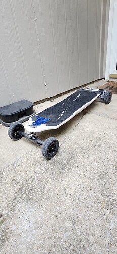

Ares X3 has either faulty battery or bms short, worth salvaging or what?
I bought an Ares x3 2nd hand from an esk8 online group. My credit wasn’t the best at the time or else I would have went through Acedeck officially with Klarna. I already have a frankenstein project board with fixing my Propel Pivot with a different Gear Drive. Is it really Worth to try and salvage and save this board from 2023?
I get 12 miles of range out of the board. Im 190 Pounds, Its supposed to be a 777wh battery. Ive gotten the same amount of Range from Isinwheel, and Tynee Stinger products and those boards were severly cheap on the quality side.
The seller laughed at me when I expected actual decent range “From a race board” and now I’m pissed I’m out $850 on a board he knew wasnt that good. My propel pivot with a 864 wh battery Genuinely gave me 35+ miles of range so I know I’m not being entitled for being ripped off here.
What’s your average riding speed when you’re getting 12 per charge? It is a 4wd board so it’s powering two sets of motors, and it’s only a 14s3p P42A battery.. 740wh max/635wh nominal. If you’re riding at decent speeds (20+) then 12mi sounds realistic. Don’t ever believe any range estimates you read from most board manufacturers out there.
No, this is the gear drive 2023 version with 1 set of motors. Im not going any faster than 18mph but around the 11 or 12 mile mark, the board shuts off a few times trying to fling me off and then burns out with an Overheating warning. If my 864 wh battery can give me 35+ miles of range and my tynee stinger with 544wh can give me 26, this Ares 775wh battery giving me 12 miles is total garbage.
Ah ok, I thought it was the previous 4wd X3. 12mi does sound low for a 14s3p 50S pack on thane wheels, but again if you’re ripping speeds a fair bit it will kill your range big time. I could kill my old Zealot 12s2p pack in 7-8mi by riding at a constant 20~
if it’s throwing an overheat warning I’d maybe pop open the gear drives and see if there’s anything in there causing excessive drag, which will hurt range and heat up your motors.

So small update on my ares for you. My buddy assessed the battery pack since i was having similar issues like you where my boards charge would drop dramatically. For my a board with +700 wh capacity should be me over 20 miles with AT tires and i had the 5 inch hoyt in it. The range dropped to 1 bar and projected my range to be 15-17 miles. Way less than what I’m suppose to get. So my buddy looked at it and found the the batteries were really unbalanced meaning the bms sucked. He’s changing the bms out and hopefully they should fix it.

On another note, my friend did sort of a bms swap on the ares battery. He couldn’t take out the original bms bc its soldered on to the pack but he managed to put the new bms on there and set the discharge bypassing the bms which helped a lot. The jerkiness really toned down. But the original bms is still running on the pack but only for voltage cutoff. Otherwise its just chillin in the pack rent free. The charging is set through the new bms. If you got someone that works on battery packs, i highly recommend it.
The last few weeks of using the Ares to get to work after getting a ride from the bus was so miserable, the BMS short was getting worst and I was getting less and less mileage per charge. What used to be a 5.5 mile ride 1 way turned into me needing 2 fucking bus trips or else I’d have to do the walk of shame 2 miles away from home in all that heavy gear and a leather jacket while the desert sun beams down on me at 8am when I get off work. I threw that shit away as soon as my Stella Pro got here…..97 MILES LATER, NOT EVEN A WEEK, AND THE STELLA PRO GEAR DRIVE IS BREAKING ON ME. It’s so hard to not hate this industry and hobby with how dog shit and expensive the barrier to entry is for a good reliable board

I’m so fucking mad, the screws securing the gear drive to the hangar are fucking coming apart and this shit leans to the left when I ride now, not safe at all! Like this thing has the same quality of cheapness that I felt when I rode my Tynee Mini 3 SL when that thing broke apart at 600 miles. I wasted $900 on this board and I feel safer taking the bus back And forth to work until mid April so we can waste more money on Linnpower products instead of Acedeck as the revolving door of shit hits mach 3
Motor on the right is loose and there’s only like 4 curbs and sidewalk ledges on my route to work that weren’t 100% comfortable but I think it’s pretty laughable to call it abuse when I avoided most potholes and shit that would take me out just to still have my electronics break on me because $1000 price point isn’t reliable :angry::angry::angry:
Ngl that looks beat to shit. But linn power and acedeck are basically the same company or owned by the same company if i recall. Fuck man, sorry you’re dealing with that. I definitely get your frustration and been there. Diy is definitely a better option but i have had and is currently having issues with some of the well known diy guys. So now i got a board that practically sat a year and a half with maybe motors installs as oppose to a complete esc and battery upgrade.

It looks beat because I live in Las Vegas, a desert environment with dust, trash, constant construction and I have this 1 street that has nothing but construction cones so I hang in the middle lane instead of walking over all the construction littering the sidewalk. I promise you I haven’t had any off roading or funny business, it’s just how dog shit and cheap these electronics are man. I’m pretty much convinced if I don’t save up for a Funwheel, my problems are just going to continue
