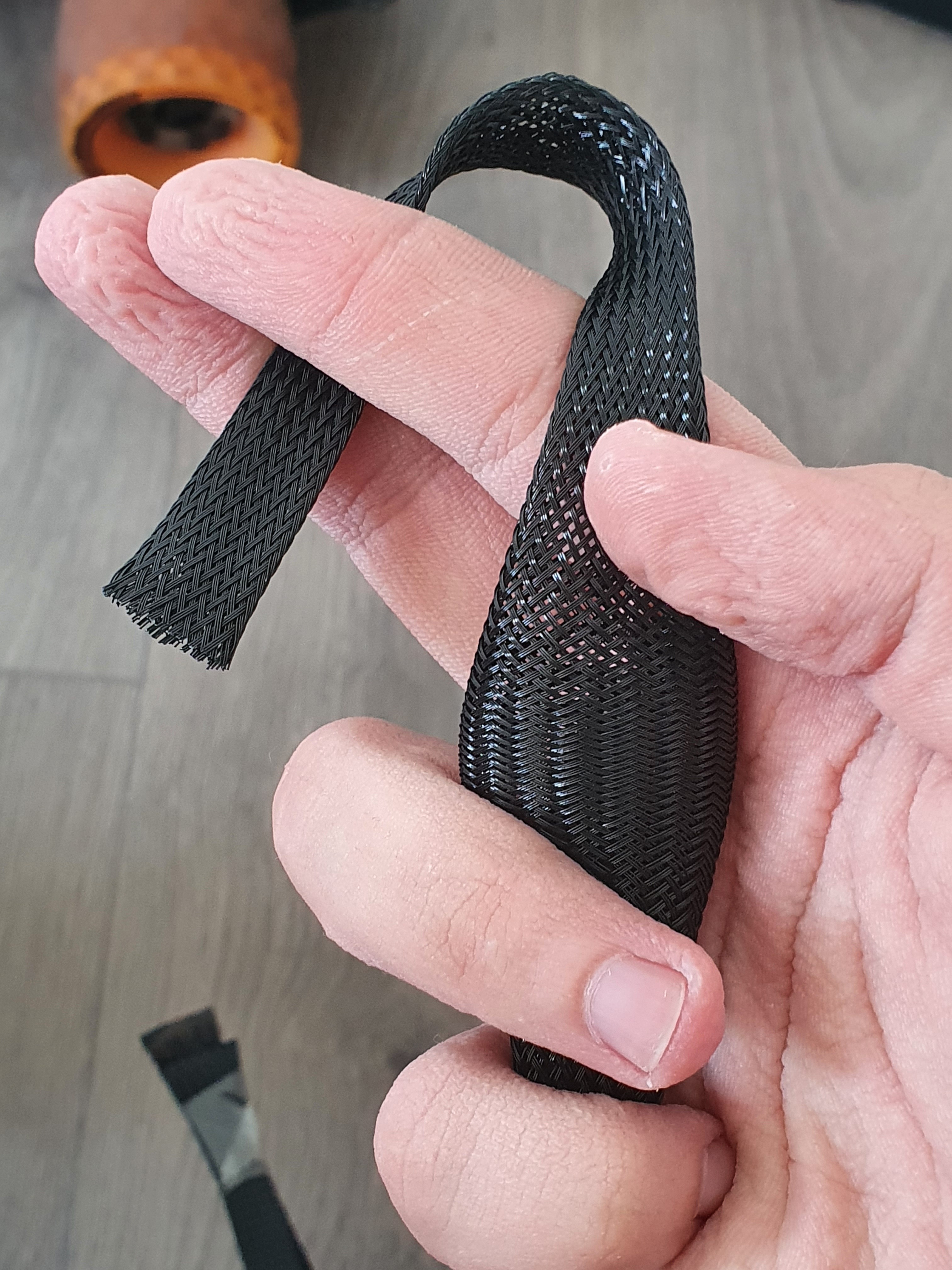

To anyone wondering how wide braided sleeve can be:
Easily double the flat width. A 12mm one fits all 3 phase wires and sensors with no effort

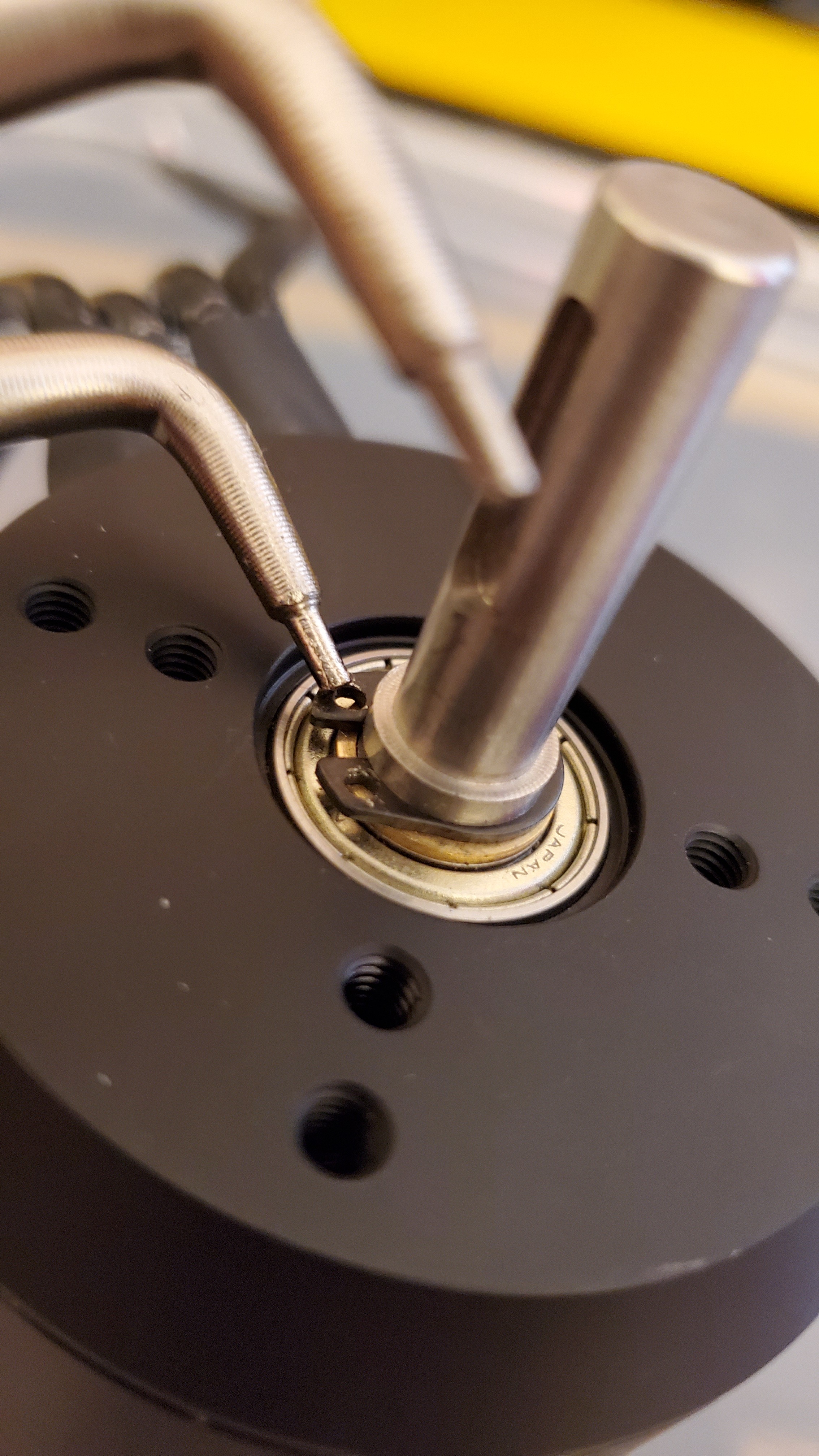

so got some loctite 243 on my motor bolts
trying to remove motor from mounts
whats the best way
thanks
Use a hex key, preferably a Wera Hex Plus, and don’t strip them. Turn counterclockwise to loosen and clockwise to tighten.
soldering iron to the bolt then unscrew.
by the time it falls to the ground it would have cooled down i promise
gotcha
sadly they are already stripped so its gonna be a hell of a time trying to put them in
phillips head though
in that case i’d just use a cnc laser to disintegrate the bolt
