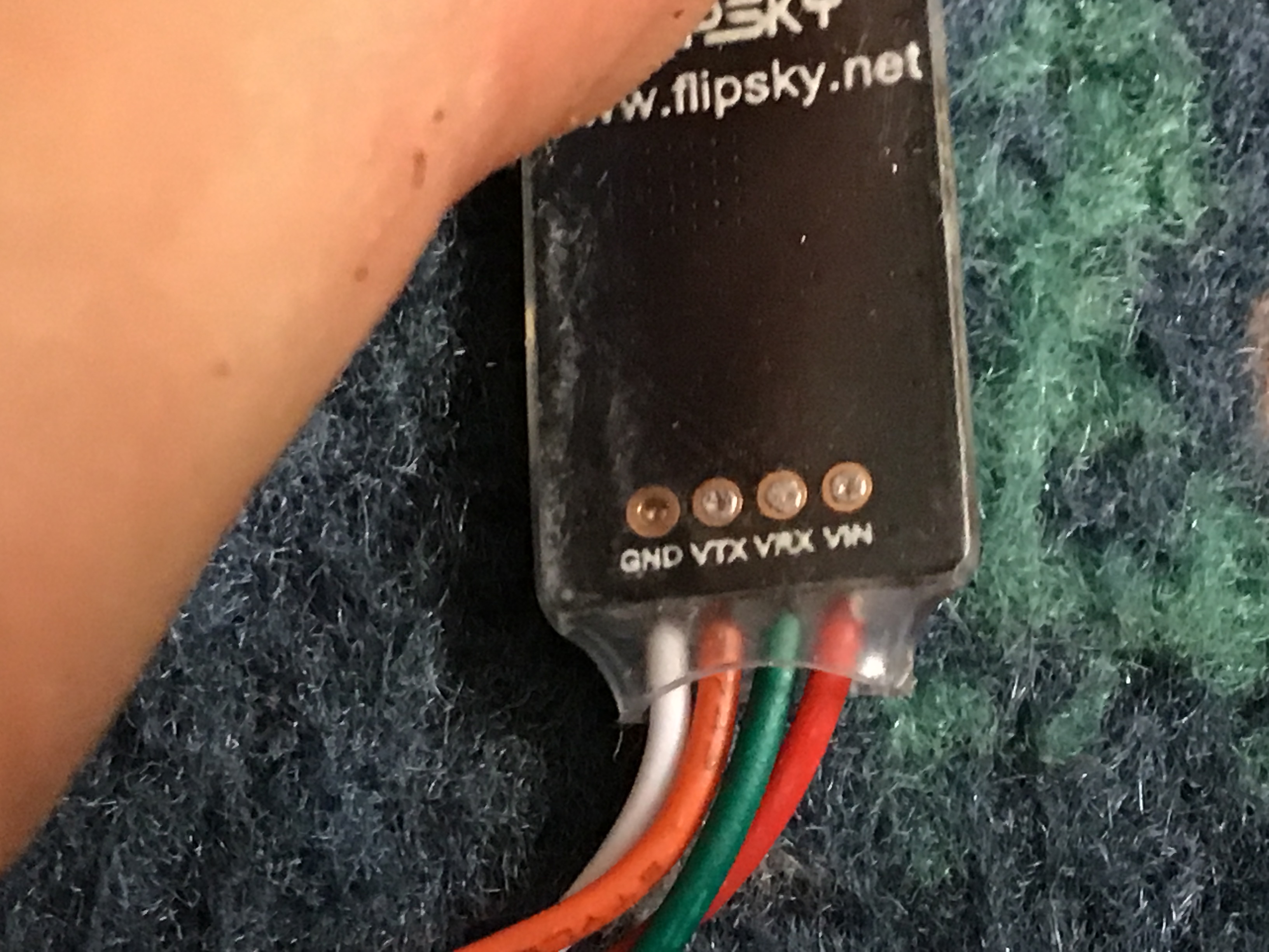

I wired it gnd, tx, Rx, 3.3v
Was I supposed to wire it differently as it doesn’t go on

Many times tx goes to RX and RX goes to TX for UART pairs that’s said usually get some sort of light on so long as gnd and power/3.3V in this case is connected. The GND connection on the flipsky board side looks pretty lacking in solder but hard to say.
Yeah gnd does look like there isn’t any solder

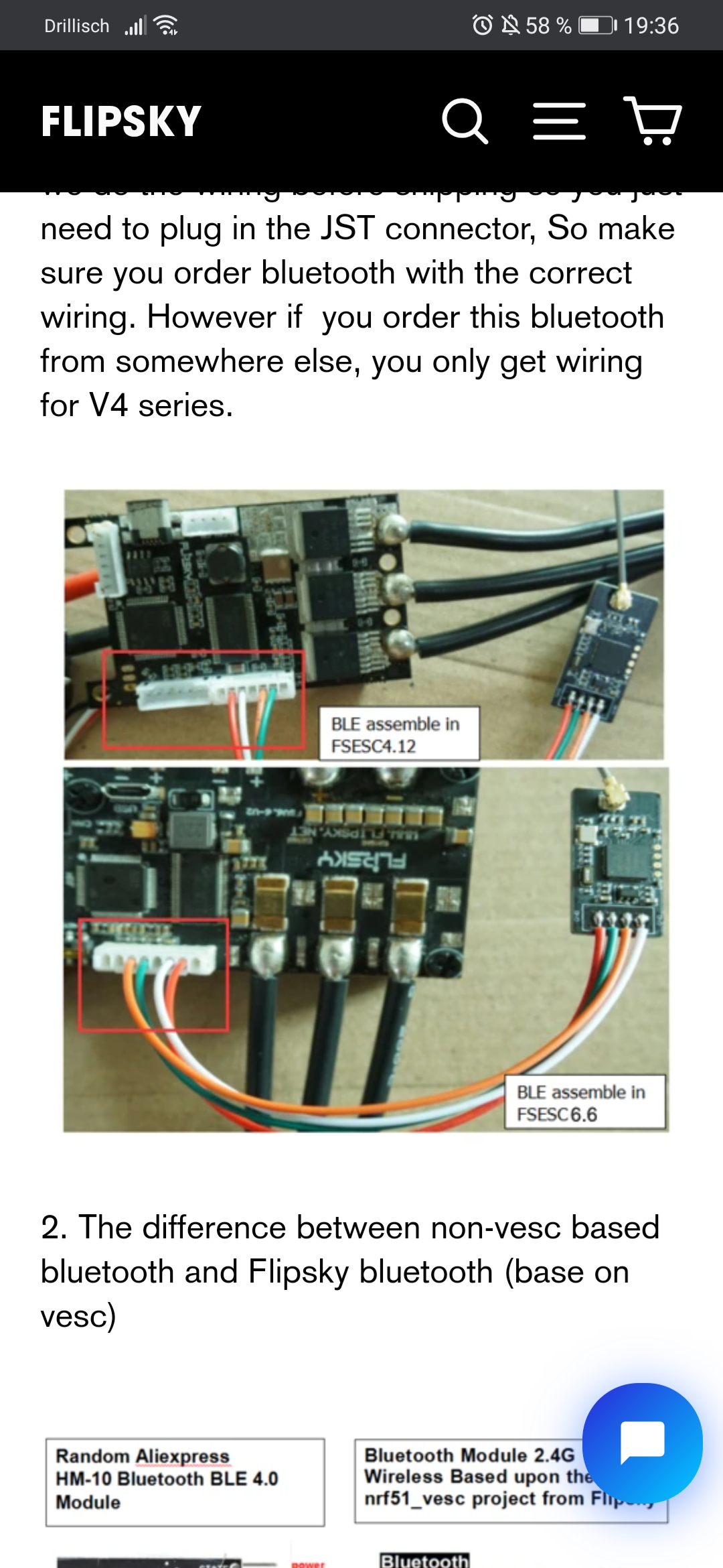

On flipsky website it shows vin doesn’t go into 3.3v?
What does vin mean and we’re does it go?
Also @wafflejock on flipsky website they show vin going into 5v could that be an issue if my vesc doesn’t have one there
Yah “Vin” on pcbs just generically means “voltage in” but doesn’t tell you it it is 3.3V or 5V tolerant. Lots of integrated circuits (ICs) and microcontrollers (MCUs) will operate at one of those two voltages but sorry not sure with flipsky what it expects. The vesc should have GND and 5V by the PWM signal connection since receivers commonly use 5V, the regulator that supplied 5V to that pin can only deal with like 1A of current but should be plenty for the Bluetooth module (assuming it needs 5V)

So I guess I need to solder the gnd and that is the issue
Thanks a lot
@wafflejock soldered the gnd a bit better and still nothing
No idea what the issue could be
Is there any chance that there is no led on this one?
Suppose it’s possible would have to take off the heatshrink and start probing around carefully with voltmeter or oscilloscope to say for sure. Had weird issue yesterday where one esc on my quadcopter kept getting into some reboot but worked sporadically, ended up replacing once I verified the signal going into it looks consistent.

Flipshite likes to do tx-tx and rx-rx for some reason. Try that

Note, that the pins are labeled VTX and VRX which could stand for VESC TX and VESC RX.
So wiring is in fact
GND - ground
VTX - TX
VRX - RX
VIN - 5V or 3V3

Yeah I know but nothing on the module lights up or shows that it is on

There seems to be no leds

First off, this will only work with android phones
Here’s the wiring:
