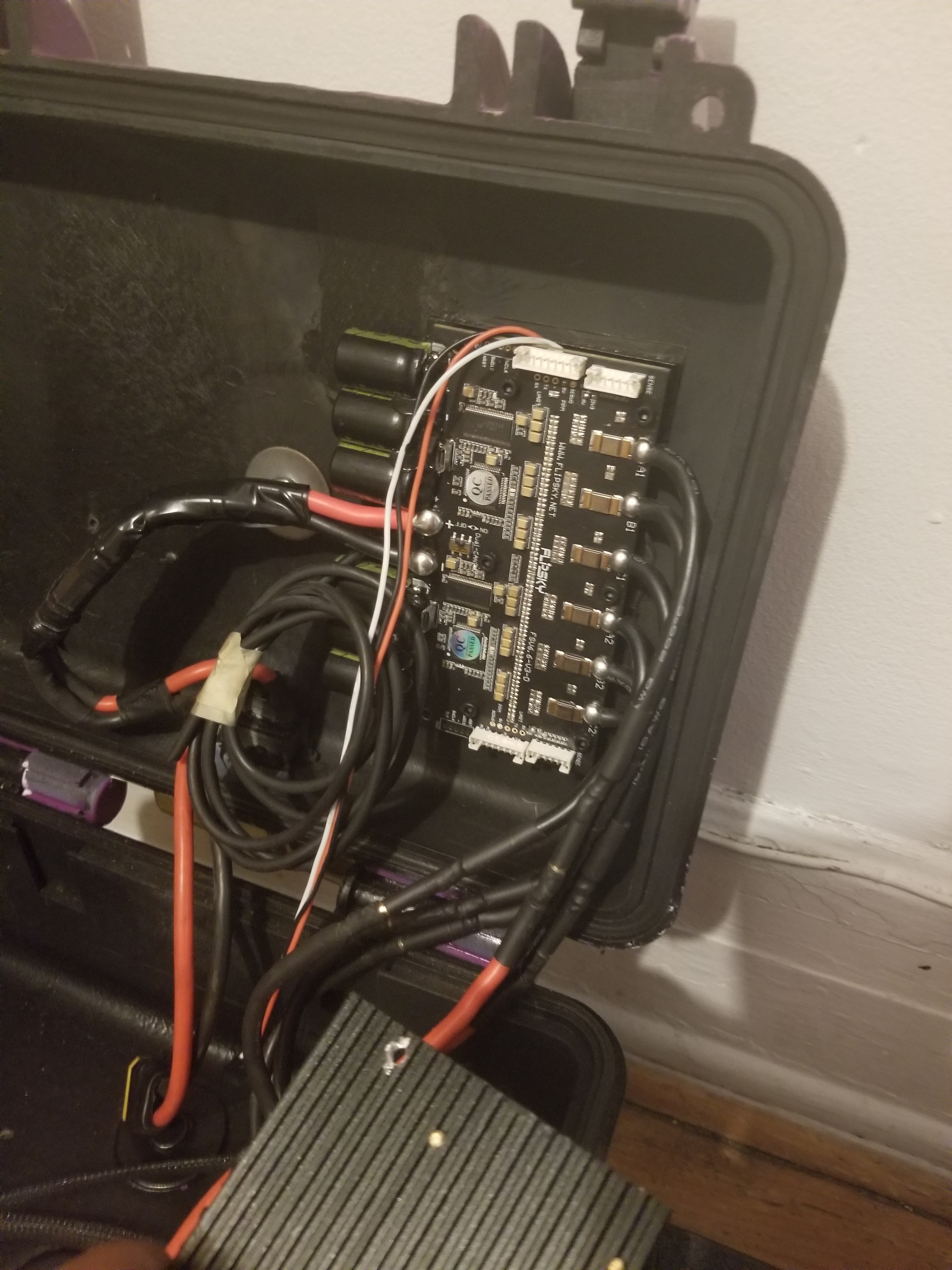

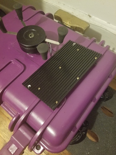

How would one make a flipsky6.6 dual hold in the top of a case while having the heatsink on the outside? I only have one shot at this and don’t wanna mess up
Use the bolts that hold the PCB to the heat sink to bolt throught the enclosure, and bore a hole in the center of it. The metal should be exposed but secure. Ideally get some silicone or a rubber o-ring so it doesn’t get wet
Not sure i get what you’re saying I should do
Replace the bolts that hold the PCB and heat sink together with something longer, make that same bolt go through the top of the enclosure, and cut a hole above it so the metal can be seen through the hole
Oh… in that case, it’s you who doesn’t get exactly what I want to do
I want the esc on the inside
But I want the hest sink to be on the outside
(Using dead esc heatsink to show)

Make some aluminum spacer blocks to go between the heatsink and the PCB, and make holes for the spacers to poke through your enclosure.
