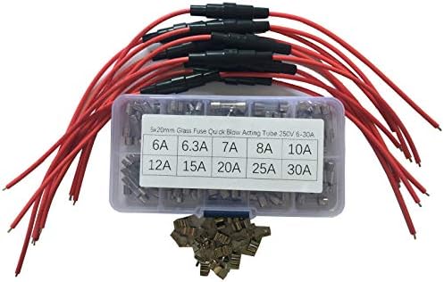

How to fuse your charge port for dummies?
Since I’ve never done it before I would appreciate some guidance. Maybe someone could do a quick write up? I have these parts:
8A Fuse
Silicone/copper wire
And later on perhaps another epic @b264 tutorial like this one:

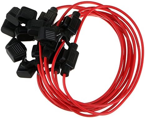

Don’t use those fuses, they break really fast from vibrations. Use car fuses, they work much better
Agreed with @KaramQ, you need a blade type fuse to solder onto. Those can work but suuuuck to solder on.
  1. make sure power is off
  2. snip red wire where you want fuse to be
  3. apply loose heat shrink tubing to cut wire before soldering
  4. cut a few mm of wire sleeve off to expose wire from both ends of snipped red wire
  5. put some solder on each end of the snipped red wire
  6. put some solder on each end of the fuse
  7. solder red wire - fuse - red wire
  8. let cool and make sure the connection is strong enough that you can’t pull it off by hand using normal strength
  9. slide heat shrink tubing over fuse and both red wire solder points
  10. lighter or heat gun the heat shrink until taut

I’ve been using these for over 200 miles. They are holding up so far. It’s in a housing though.
