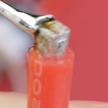

It was 300 degrees Celsius :frowning:
I guess it really is the missing Flux / rosin
Trust me, I held it to the bullet connector for minutes :confused:
The solder just will flow over it, like a raindrop over an umbrella
When i solder bullet connectors, i set my iron between 370°C (small bullet) and 410°C (big bullet).
It allows for a quick heating of the connector.
The spike speaks for itself : it’s not hot enough.
I tried 400 degree to, with a flat tip to help spread the heat…
My soldering iron is pretty bad though… Just uses a pot to set temperature… Don’t know if it really was that hot, but it made the wire ends dark/black :sweat_smile:
IMG_20200521_223456
I have this problem with more or less each wire size etc… As said:
In most cases it doesn’t end up like this, the solder just flows off the connector / wire like a raindrop
I use lead free solder
I sadly only have soldering fat, which is not usable for electronics but copper bars

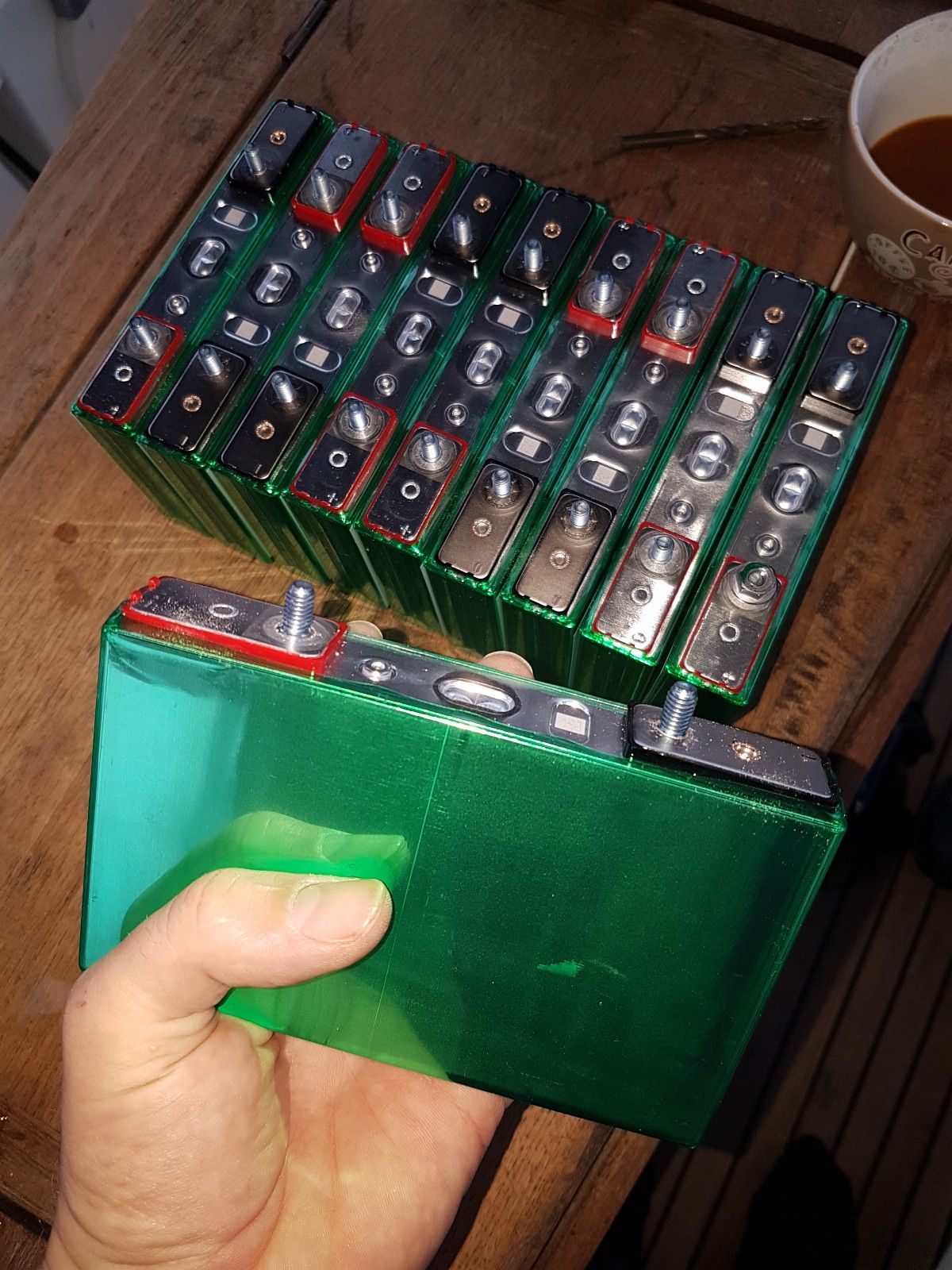

yup 10amp rated… them are the good ones…
what I’ve done lately is to use the 2.1mm for 12s boards and 2.5mm for 10s boards… that way I can’t fat finger a 12s charger into a 10s board when I’m fukking having a blonde moment…
What cells are those? Look great for emtb if the amp draw rating is genuine

You HAVE TO use rosin core solder like this
https://smile.amazon.com/gp/product/B07BGY99SN/ref=ppx_yo_dt_b_asin_title_o06_s01
The part needs to melt the solder, not the iron. Think about that, and understand what it means.
