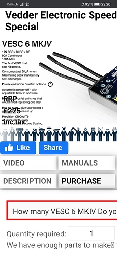

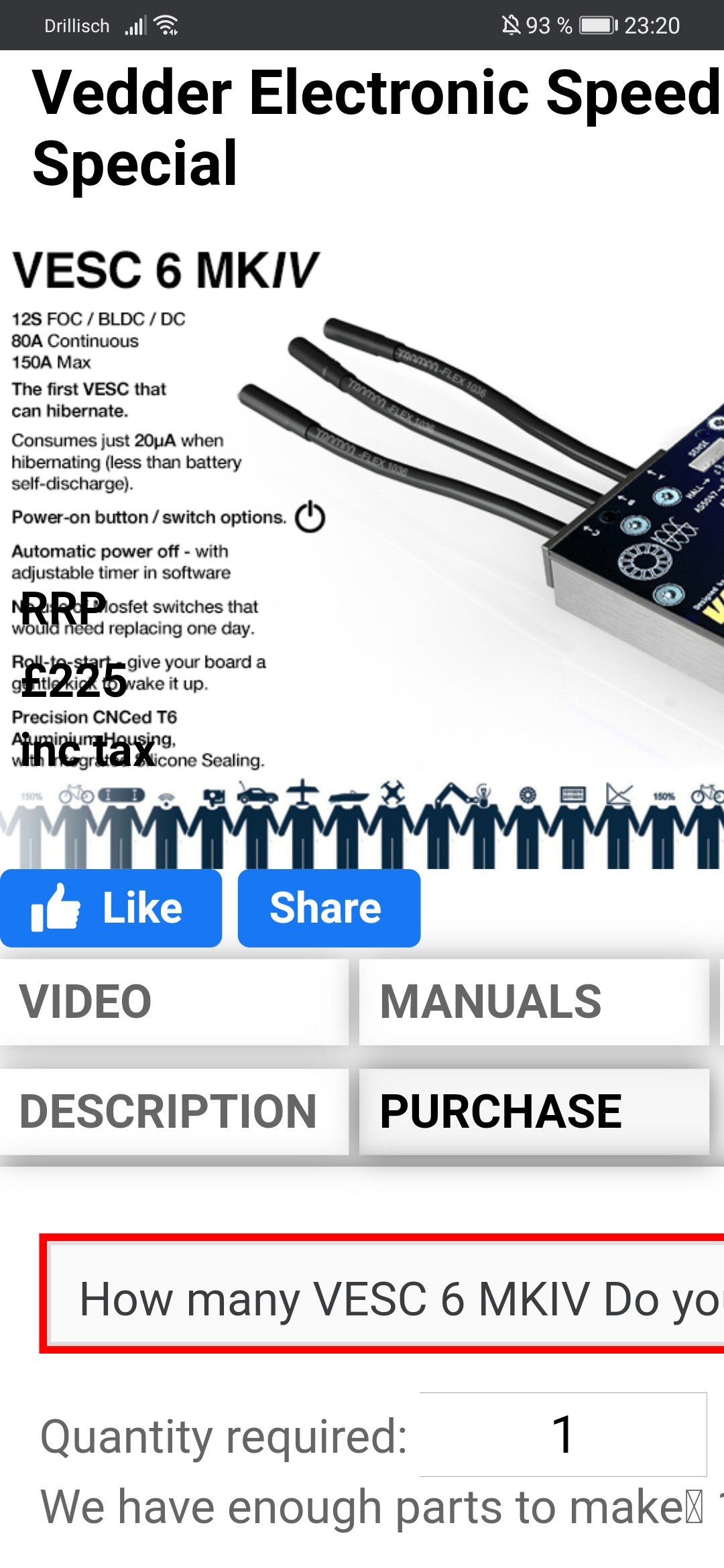

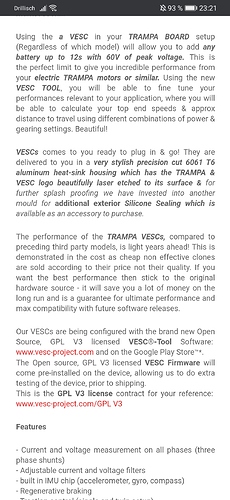

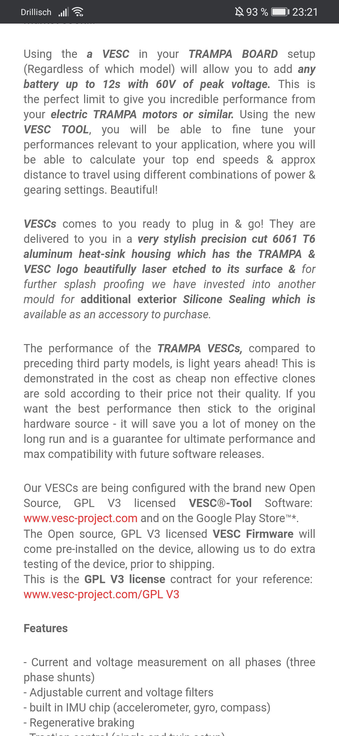

So trampa vescs are rated 60v
I asked can I run 13 or 14s li-ion 54 or 58v around
He says no cause of voltage spikes
How much are the voltage spikes on those respective batteries
@Halbj613
I found that I get voltage spikes when breaking. For 30V it had spikes up to 45V, I immediately stopped braking when on my lab bench psu once I noticed it since it’s rated 30V Max.
Of course the spikes could have been even higher, the refresh rate of the segment display on these lab bench PSUs are lazy
So what do you expect is in theory the max voltage you could run on one of them
13s ?
52v?
Please ask someone more experienced than me for specific answers :slight_smile:
I would feel bad just throwing my assumptions at you…
K get you hopefully someone else can shed some light
Lots of people run 13s on a unity which I think is also 60v?
Well, there is a 75V rated one… But that one scares me off.
The 60V one should be used with up to 12S batteries. If the website of the mind behind all VESCs says so, I would believe his words :slight_smile:
