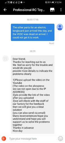

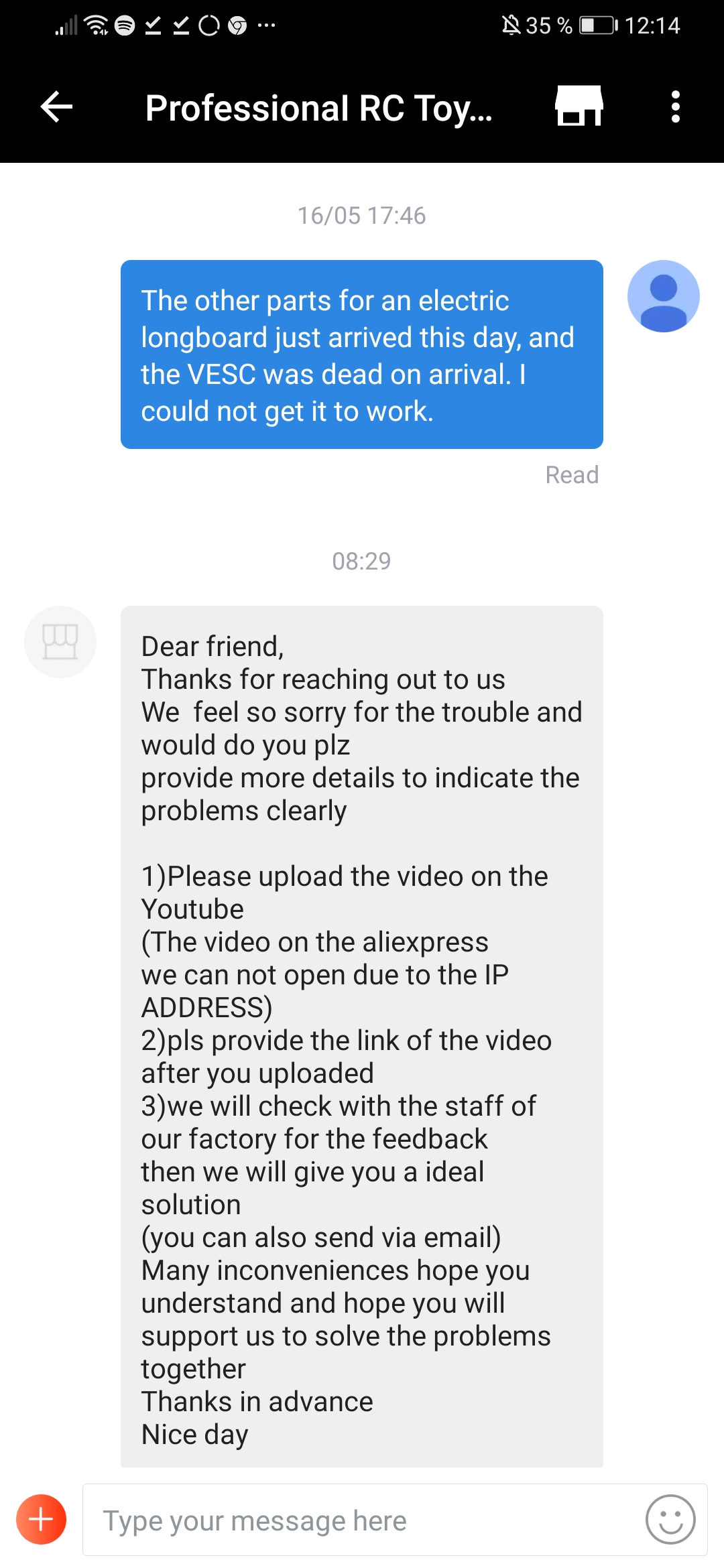

I know this isn’t quite the right place, but I want to adress as much people as possible, also I don’t really know where a better suited place would be:
I bought a defective 4.12 VESC from AliExpress. I confirmed receiving the order which sadly starts a 15 day countdown after which you can’t open a dispute anymore.
I reached out to them anyway, thinking it was just a waste of time - I really didn’t expect anything from them.
But!!!
No matter how this will turn out - I’m really happy with this experience. Remember - they are doing this voluntarily now! I will hope for the best :slight_smile:
All they’ve done so far is reply to you. They won’t be replacing your unit, they will string you along then blame it on you. I wouldn’t bother
I had to file an Aliexpress dispute only once for a defective pair if cheapo bluetooth airpods.
Although the seller was an asshole, aliexpress stepped in and decided completely in my favour.
This is different though since the 15 day limit has expired but you never know.
