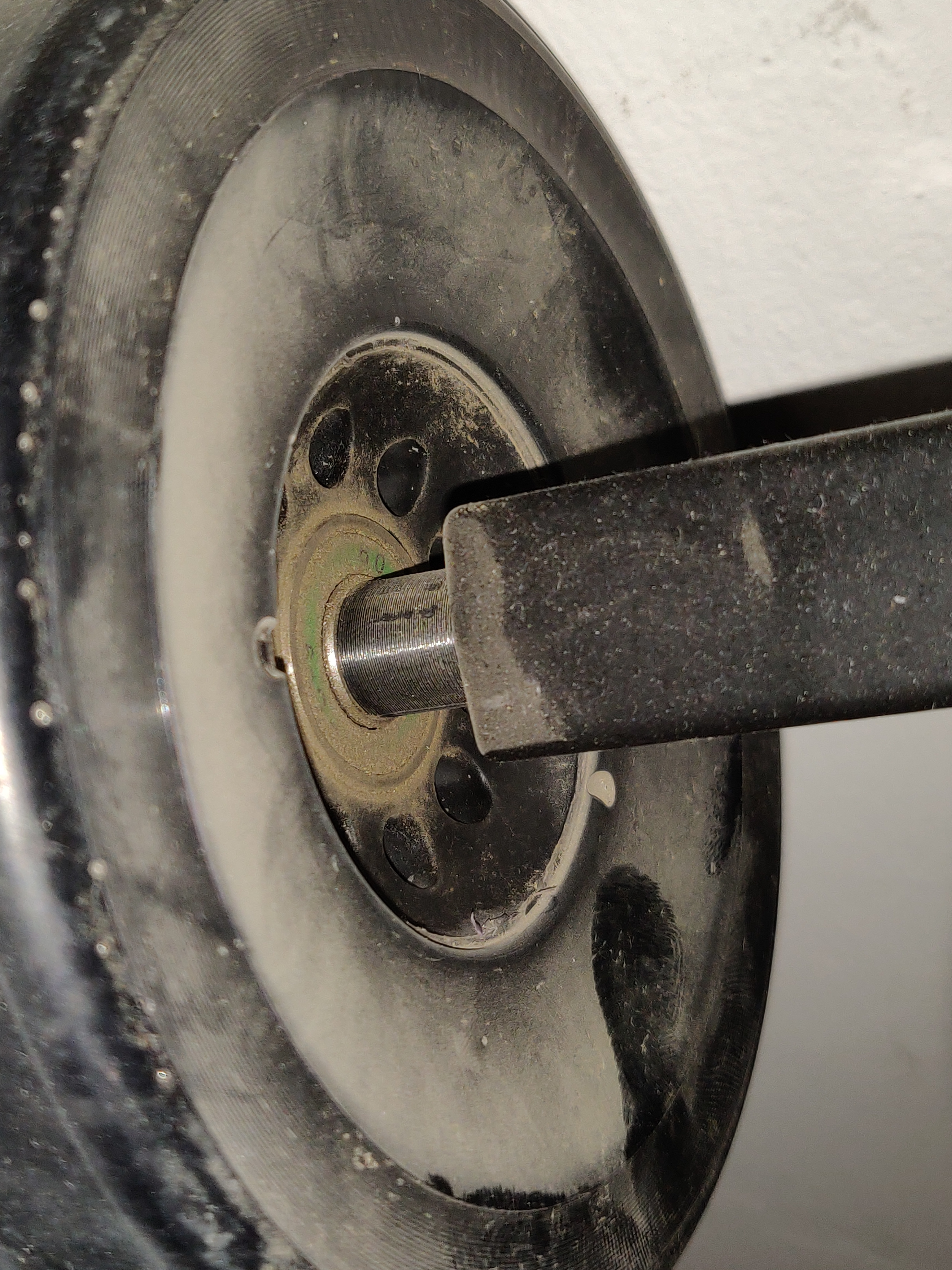

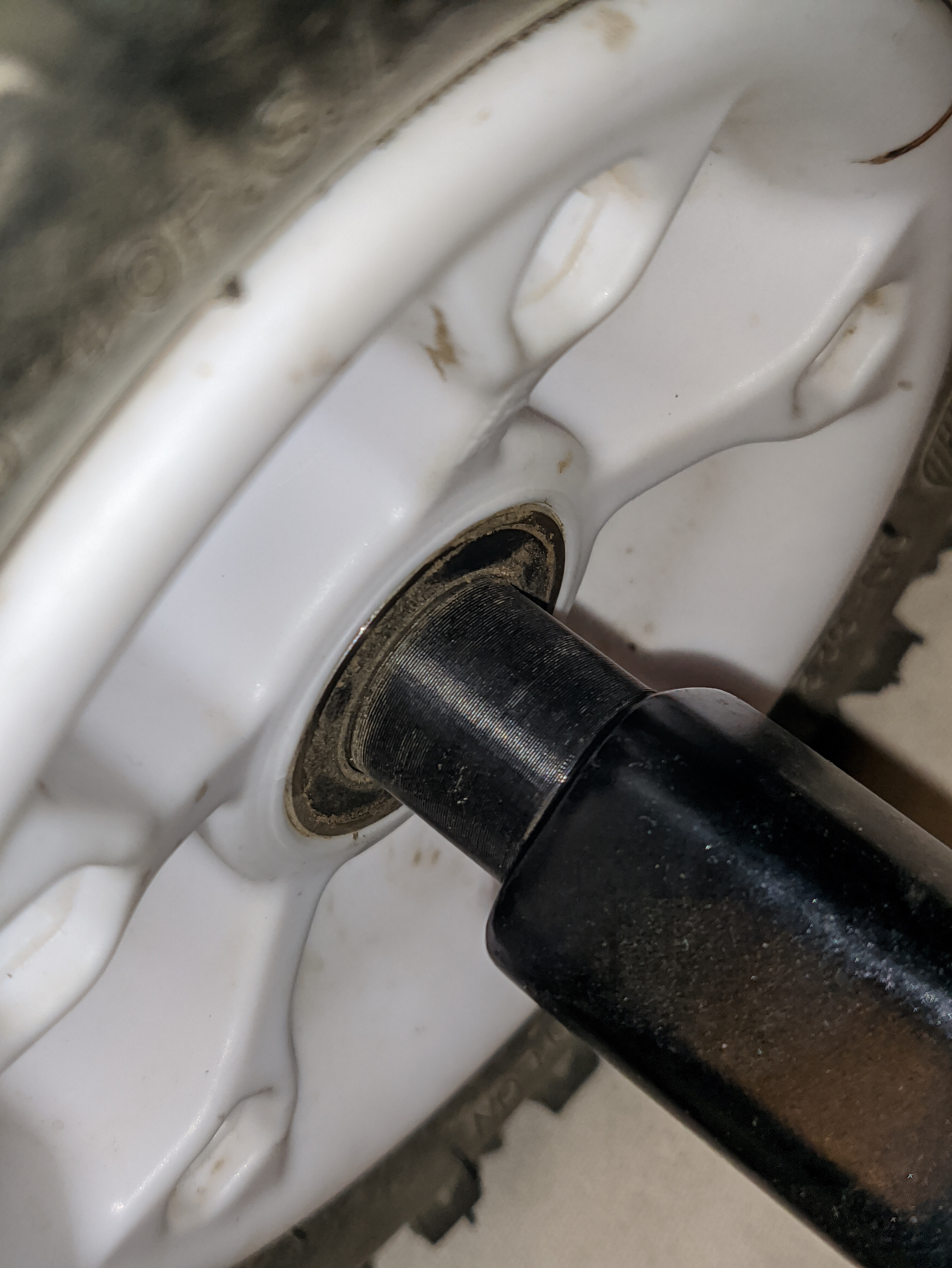

I use wheel spacers on my trampa truck because the provided metal ones were too long.
I also use them on my tb 218mm trucks
what material did you print them in? I’m thinking a stiff material but PLA creeps over time with constant pressure.
↑ :wink:
Thanks that looks awesome!

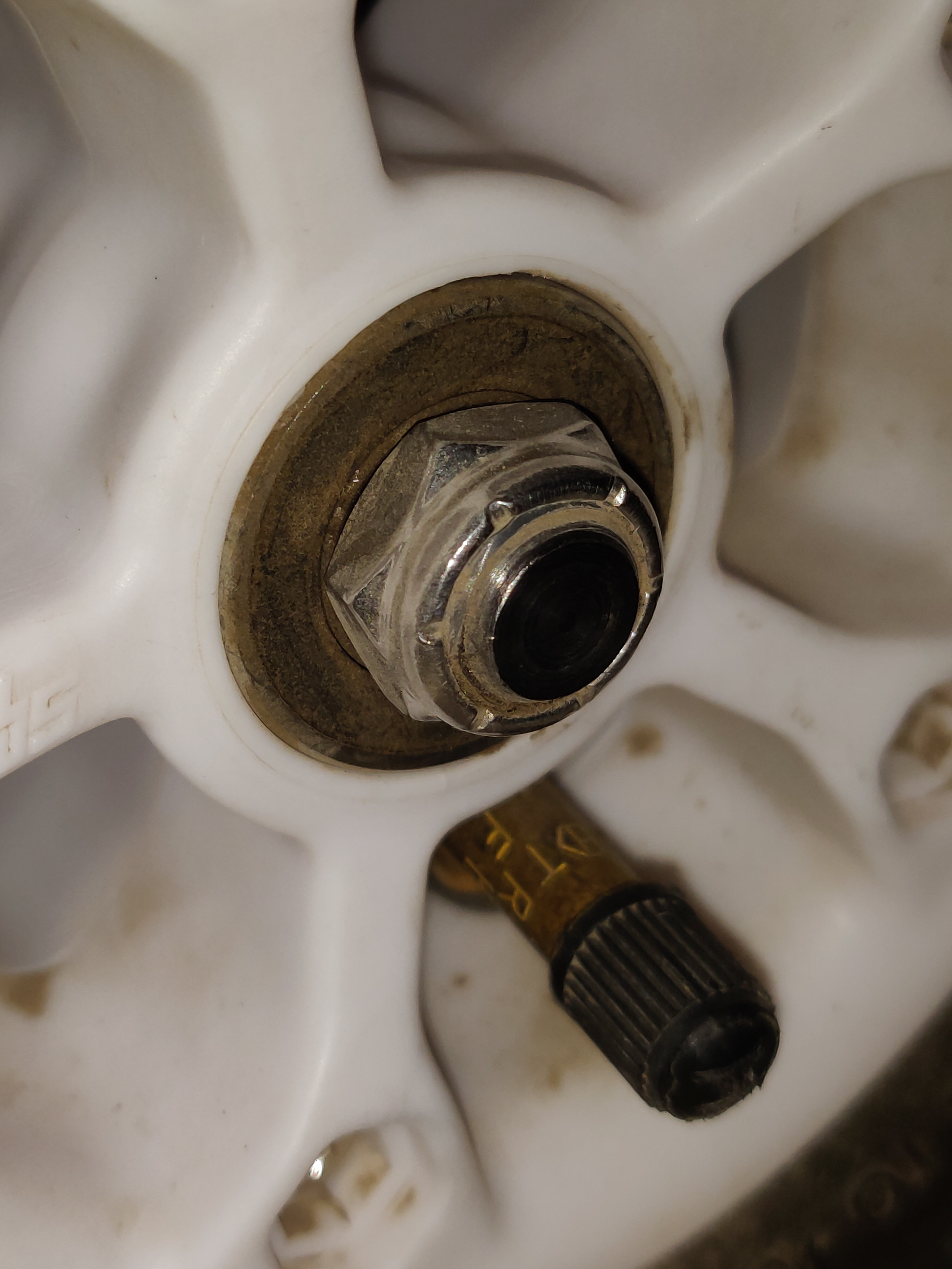

how hard do you crank down the axle nut?
Strength wise so hard that the wheel basically won’t turn.
When the wheel is normal tight its like this. It currently has a tiny bit of slack. If i want the nut further in, i just trim off the spacer
Yah have used the same. I know with heat and pressure over time the PLA will give out eventually but it’s like a 10 minute print so honestly not worried about it, I think chances of this breaking and resulting in catastrophic failure is pretty low but I always treat intersections and traffic as though my board is about to go full throttle and thermonuclear at any moment :slight_smile:

just a heads up, if you crank down the nut and the wheels spins with a higher resistance as a result, that means that the spacer inside the wheel is too short and you are putting constant lateral forces on the bearings, which is not a nice way to treat your poor bearings.
now thinking about it it might not be the best idea to have printed spacers in between the bearings as they will most likely be compressed a slight amount either by the force created by the axle nut or the compression created when riding/carving. I guess you could take the compression into account when designing the spacer so that it get’s roughly in the right ballpark. :woman_shrugging:.
but using it like you have in the photo above shouldn’t be a problem unless the spacer itself dies.
Nothing to worry about in my case. I don’t use spacers between bearings. Not on the urethane wheel nor on the Pneummies… I get what you mean tho.
