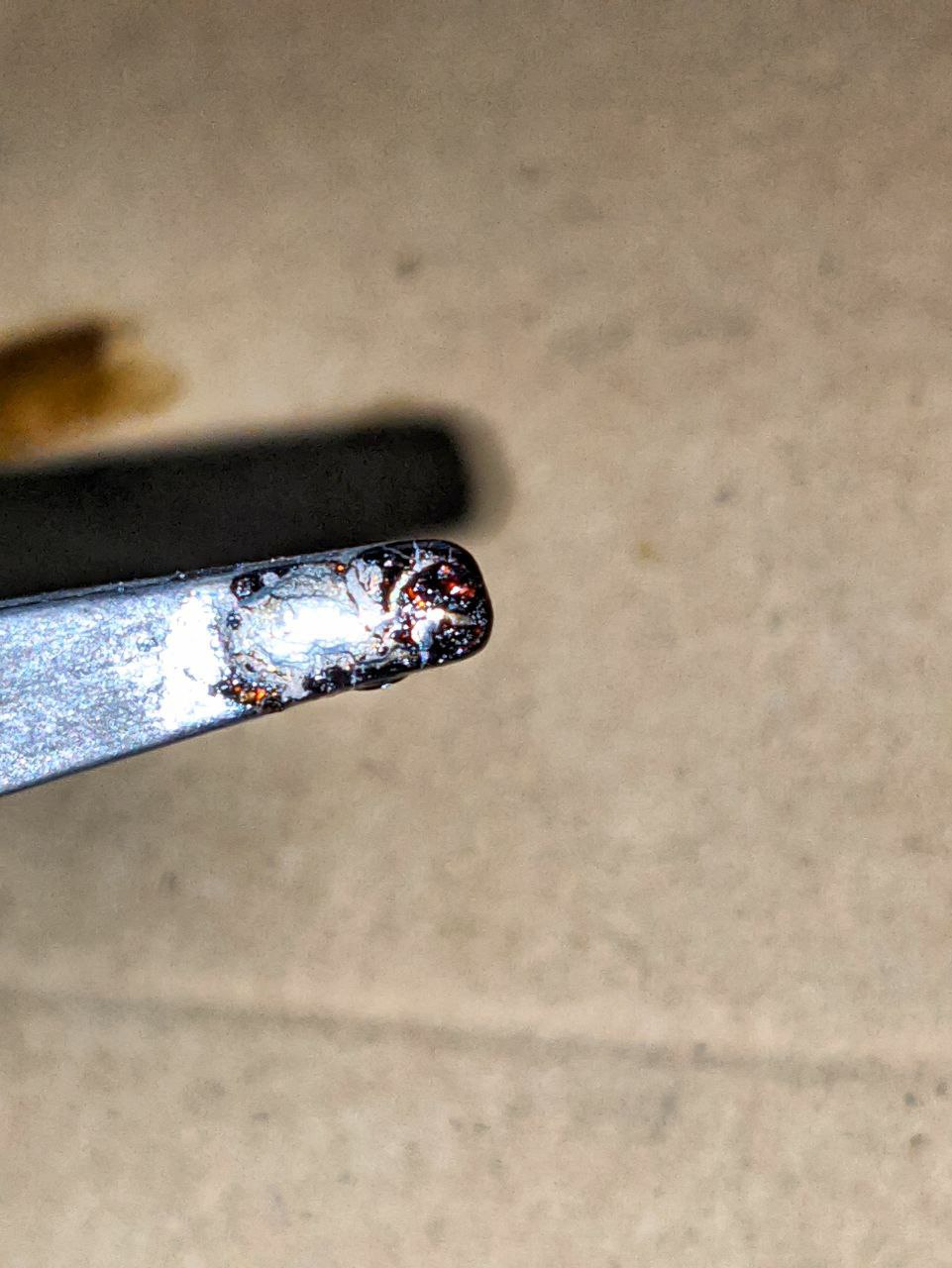

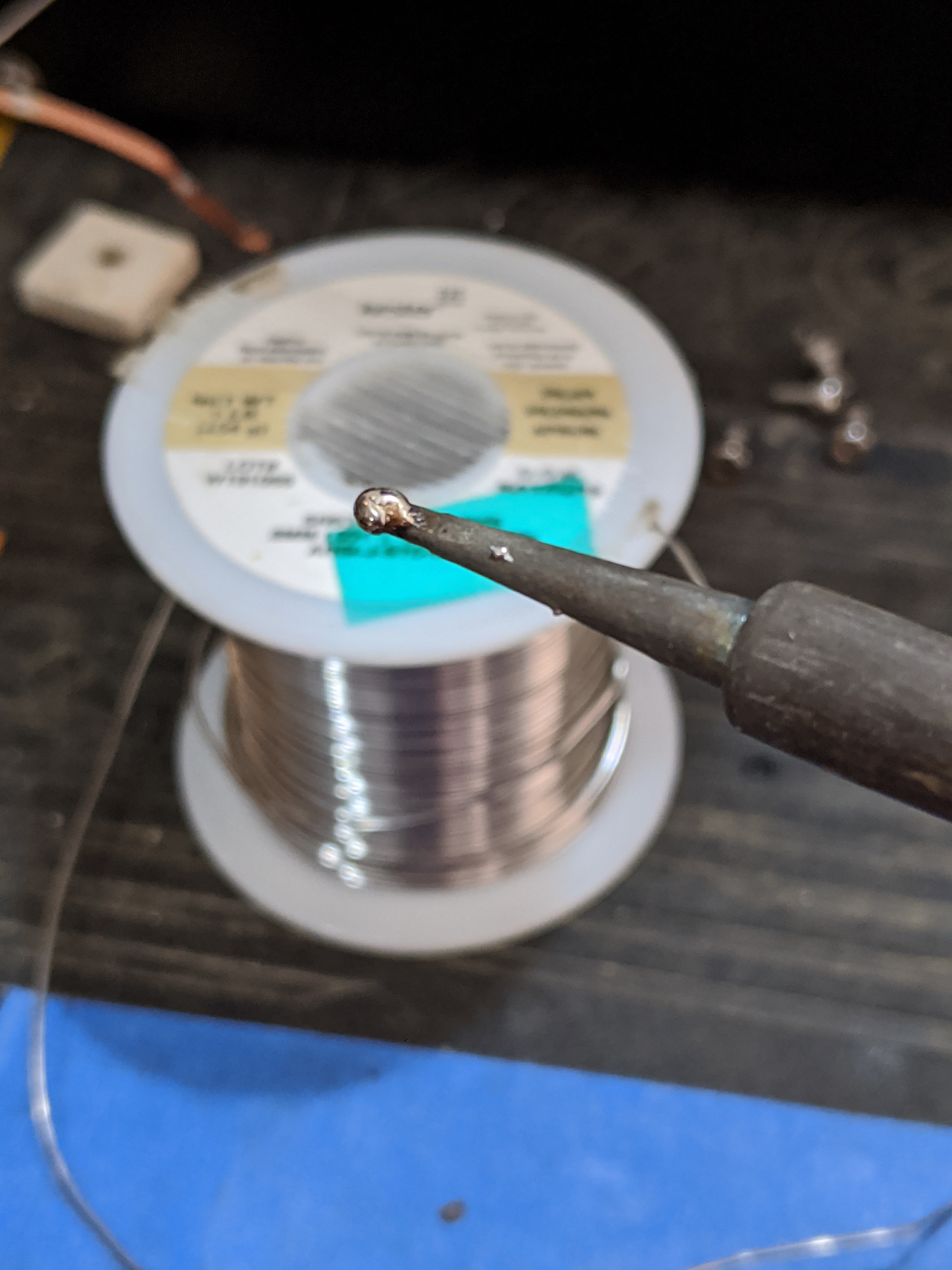

Very nice write-up. I’m buying seperate flux soon because the rosin core sucks ass (at least for me and my iron) due to the heat burning up the flux and leaving black dirt behind.
Huh I haven’t seen that with the Kester stuff but I’ve only used this one spool of it and some other tiny spool I had before this but don’t recall if that was a problem with the other stuff either. I do have some flux remover that does seem to do a good job with a q-tip or the like for cleaning up any residual funk. Only kind of black stuff I’ve seen in solder has been from melting some of the plastic on wires into the solder but could be just cooking something in the rosin like you said too. I have flux for some aluminum solder I got for repairing lipo cells but really wouldn’t recommend doing that it failed on me a few times after that and is just a PITA (trying to solder onto broken tabs of the cell package).

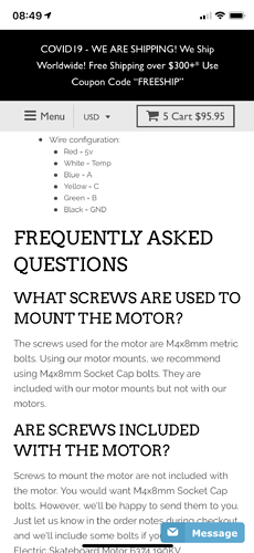

Does anyone know what length bolts I should use on TB motors? I know they are M4 but I am not sure how long they are meant to be…:
I believe on their site it’s m4x8mm. But then again we can always summon @torqueboards and ask for advice that’s not related to TB130s :eyes::eyes:
EDIT:
It depends on how thick your motor mount is? I use shorter bolts where the screwhole near the phase wires is. 8-10mm is probably the right fit. I can measure it later if needed.
Sweet thanks!

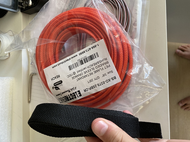

On another note… not really noob question but which motor sleeving :rofl:
depends on how the rest looks :smiley:

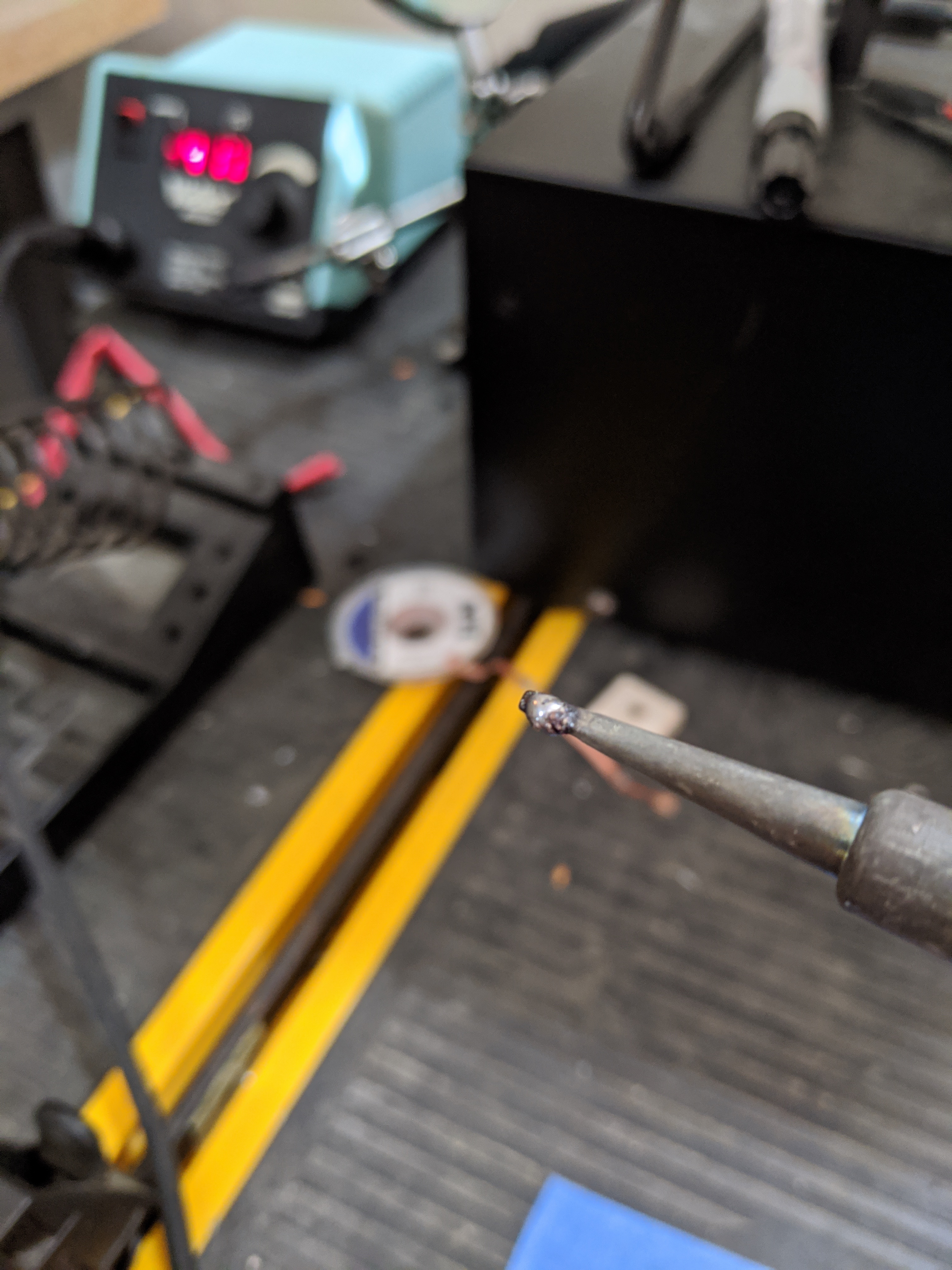

this is by the way how my solder looks after a few seconds on the iron.
Ewww yah that seems bad… Let me try the same here
Yah I don’t seem to have that happen here maybe just bad rosin in that particular solder?
