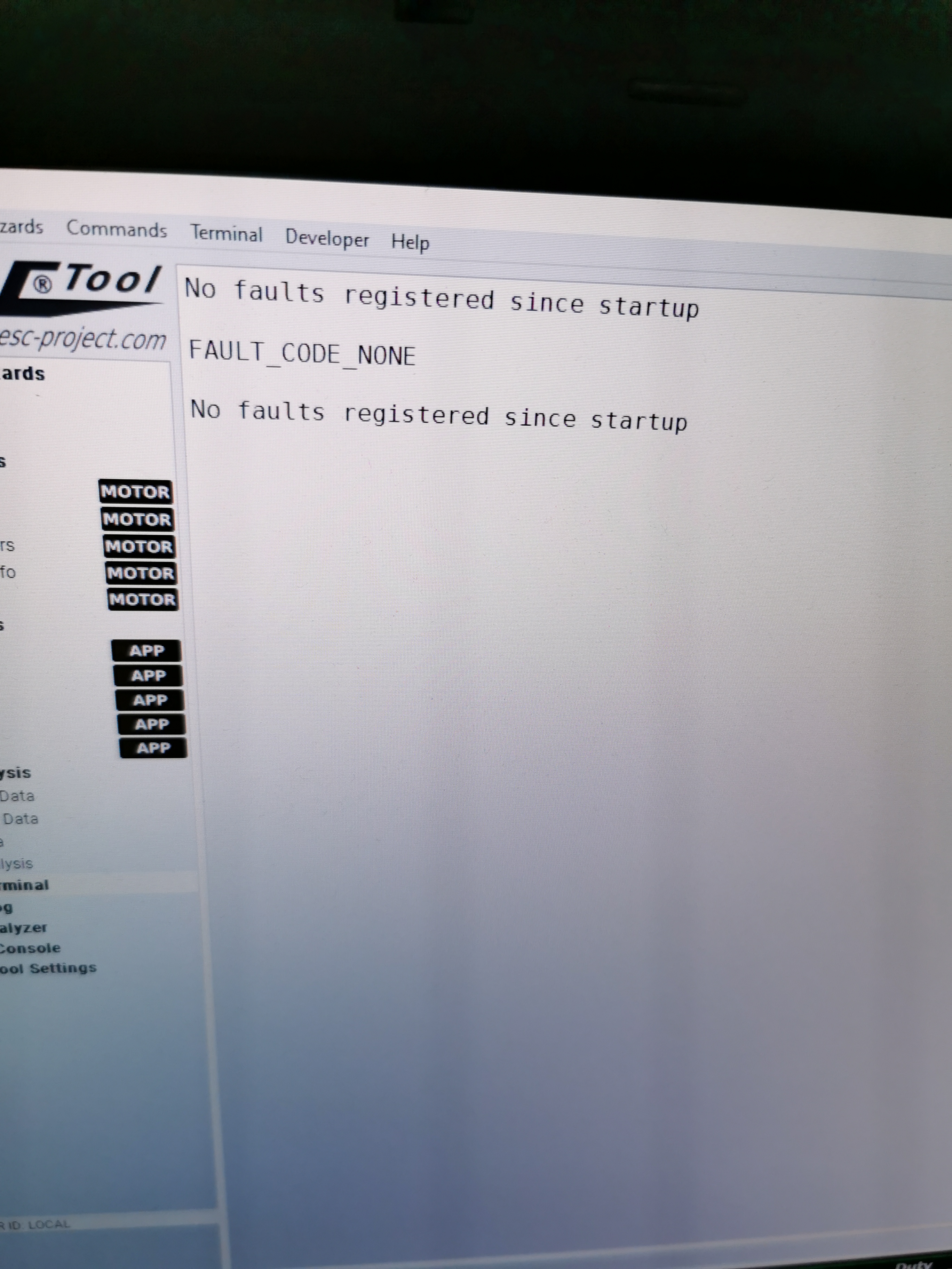

When trying to throttle with the remote, there’s three red blinks each time
I’ve read that means a defect DVR?
Do you not see the red led flashing?
Go in the terminal tab and type “fault”(current fault code). If it’s empty type “faults”(all faults since bootup). By the sound of it something is toast
@Athrx
Yes I do, thought it was normal though :frowning:

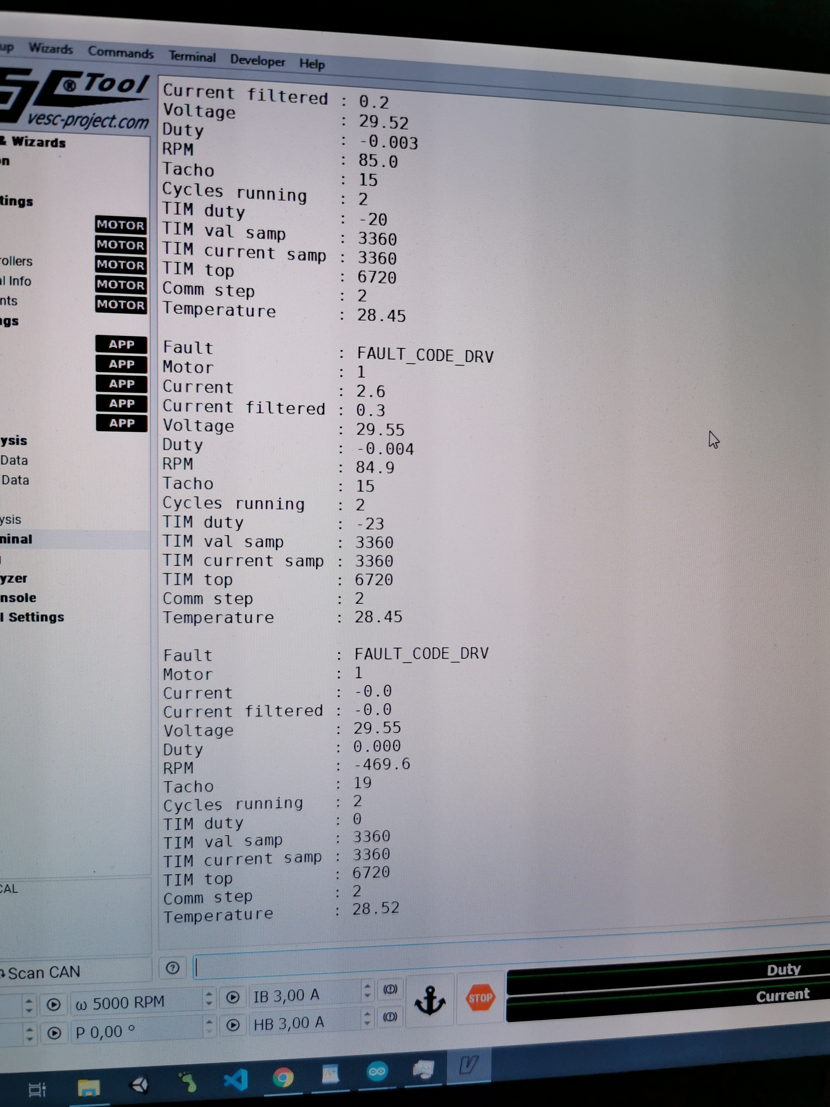

It seems like everything is okay, Ibe updated firmware on the 4.12 VESC to 5.1, it cant detect any values. Blown DVR?:sob: I have a second one here… If that’s dead too… :dizzy_face:
Type it in after you get a fault. Not fresh after you turn it on.
Aaand, no, red led means disaster strikes. Consider it the blue screen of death in windows
I’ll run Motor R/L detection now and type it in the terminal after that
So it starts blinking red 3 times in some sort of period… Blue and green are constantly on. I got a really weird low pitch sound for 1 sec on the motor, THEN VESC Tool said Could not measure the motor resistance and inductance
Im about to cry…
I’ll try the second vesc… Will have to solder bullet connectors to it first
I’ll open a dispute with the seller right? Nothing else left to do :frowning:
