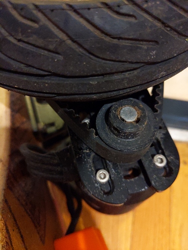

How do keyways work on motors and their gears? Are you meant to locktite them?
Nah they go between the pulley and motor and stop the pulley from being able to spin free of the shaft because half the key sit in the pulley and half the key sits in the motor shaft (it basically makes a little lever that is stuck in/on the shaft).
How does it stop the gear from sliding off?
It doesn’t the grub screws in the pulley stop lateral motion but the belt tension mostly holds it from sliding around on the shaft as well. The keyway just makes it so when the motor turns the pulley must go with it.
Some keyways may be so tight with the pulley they hold it on to some degree too but all I’ve seen also have grub screws in the pulley to hold it on the motor shaft.
Makes sense! Thanks
I would suggest loctite on the grub screws and anything else with a thread, I believe others have added loctite on the shaft as well I guess it probably can’t hurt but never had an issue with it here.
