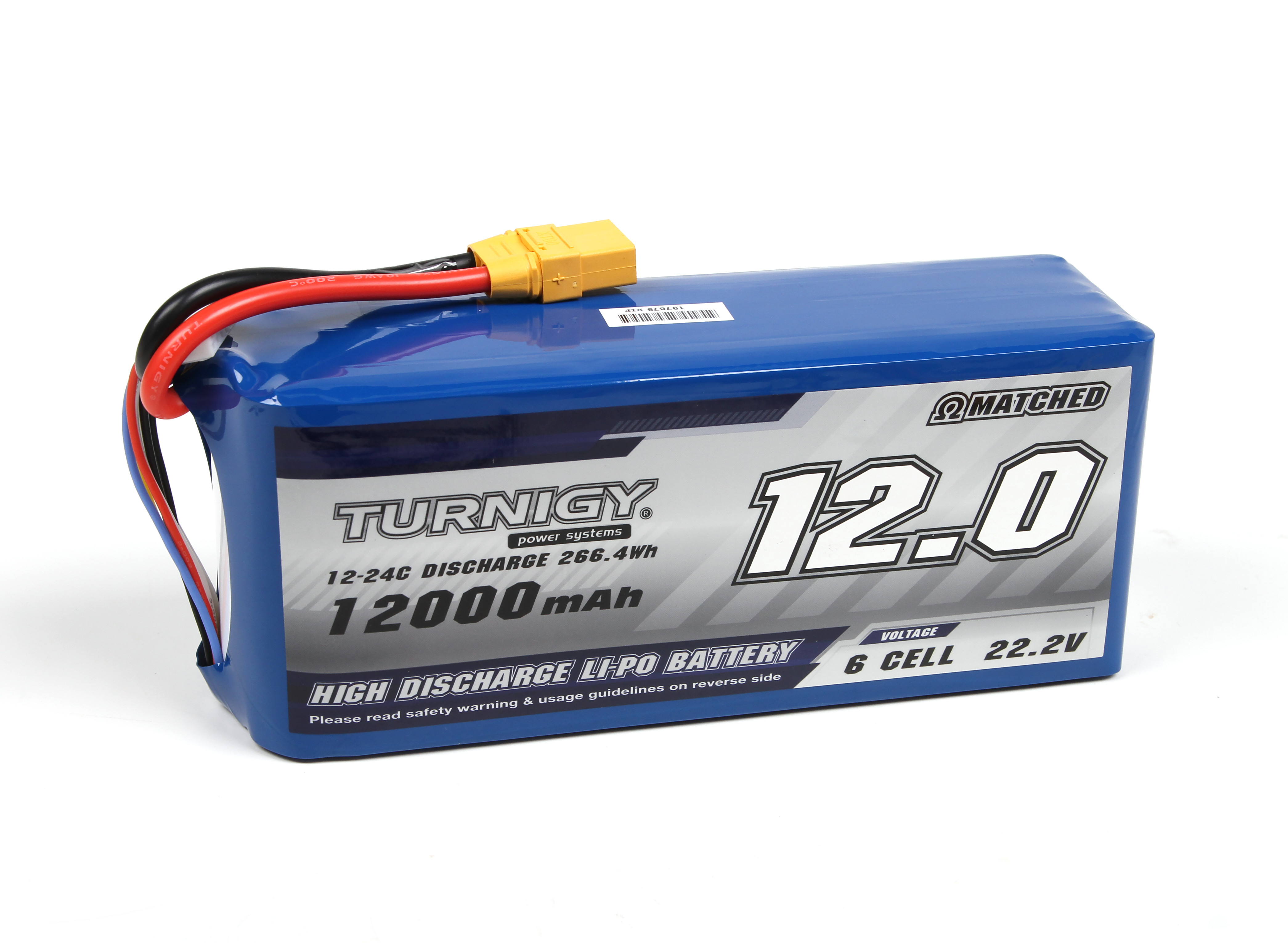

So would dual lipos push enough Amps out?
The science stuff is what im still wrapping my head around here. How many amps should I be looking for?
Hope you can at least fit two of those in your enclosure. you’re gonna be real disappointed in 8.8ah and 30A of discharge on pneumatic tires.
Yeah dual lipos would be good enough. That tattus that I’m lookign at are 14A rated for 25C so in theory you can discharge up to 350A in a burst
yeah.
for 8" pneumatics, 30A a motor min, imo. How much do you weigh?
Im about 180 pounds
These are the ones Im looking at. So 12 times 12. for 144 Amps That helps a lot. Now im starting to understand that
Is 350A over kill haha?
When you connect in series (the positve and negative terminals connect to each other), the current isn’t additive, the voltage is. So 2 * 6S in series is 12S voltage but current stays the same. 144A is plenty though.
When you connect in parallel (the positive are connected to positive and negative connected to negative), the current is additive but the voltage isn’t. So 2 * 6S in parallel is still 6S voltage but current is now 288A.
Btw, those are “low” quality cells. You might experience puffing after some use.
C ratings are often inflated. Sometimes they aren’t though (lol). For example, those 14ah tattu packs in 12S are solid for 100a cont, 200+ burst. You might not damage them if you pull 350A from them, but I’ll bet you reduce their life, and better stick to 100 or less cont.
another example… the 50C rhinos from hobbyking are spot on their C ratings.
The rule for “low quality” or “unknown” lipos is divide your C rating by 5.
