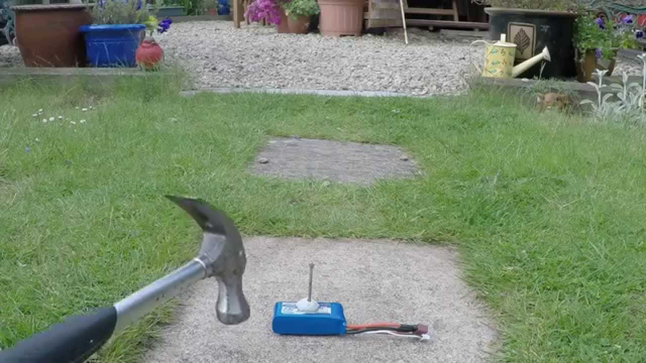

What build are you going for? Generally, pouch lipos aren’t recommended. We tend to like 18650 or one of the bigger variants because they’re safer

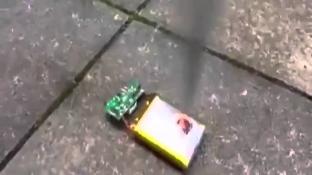

They’re susceptible to punctures and deformation and have much more violent response.

Pouch lipos refer to the form factor. Any lipo where the chemistry is located within a pouch is considered a pouch lipo. Graphene is not form factor but a variant of the chemisty. Other form factors are the 18650 or cylindrical cells. Think AA and AAA batteries.
