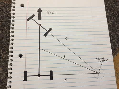

Here’s a simple question that doesn’t require its own topic.
Been trying to learn some Skate Math.
Getting into some graphing and modeling, ran into an interesting question.
Which one of these is the turning radius, A, B, C, or Other.

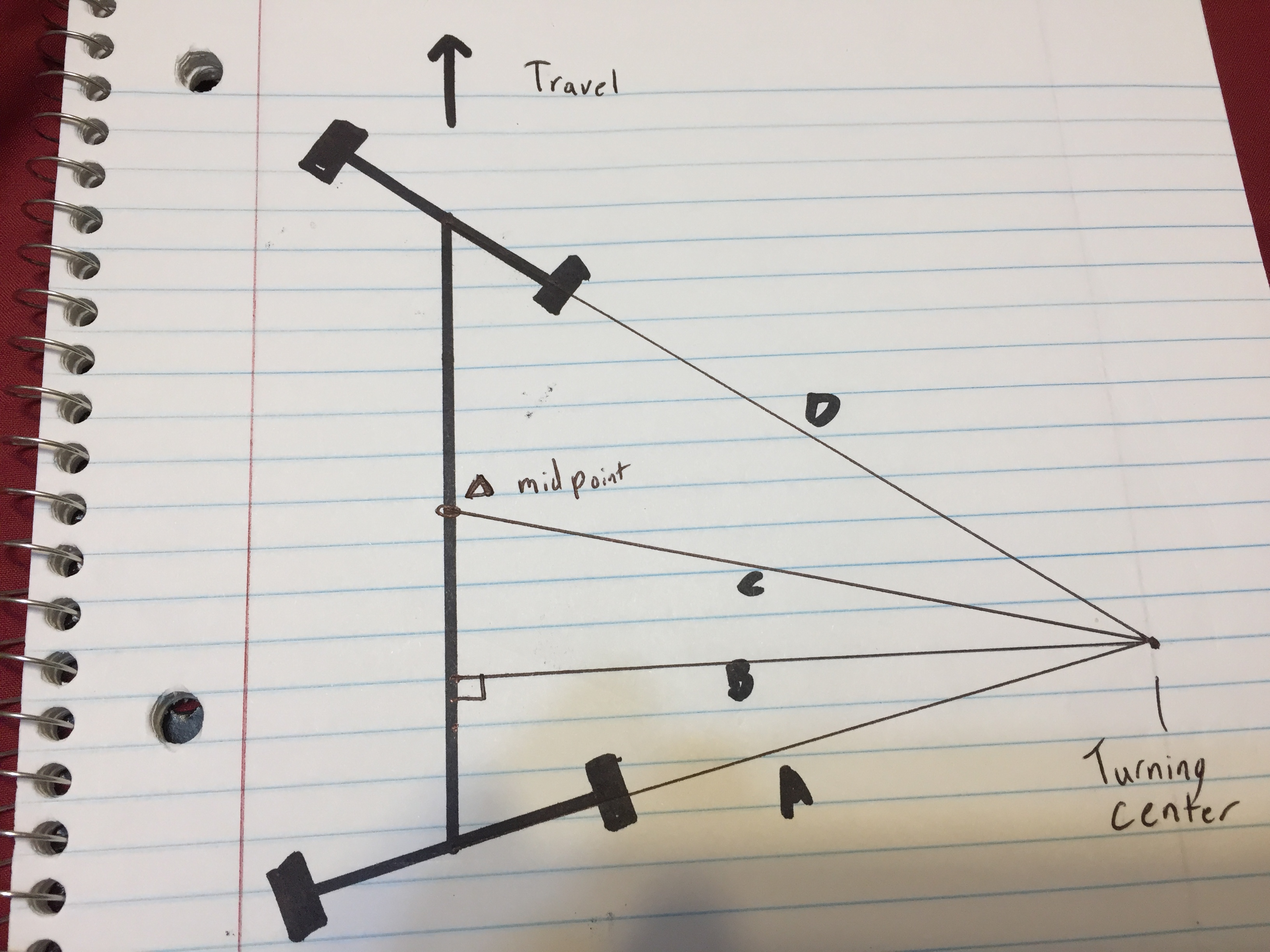

Edit:
Realized I had an important distinction that was ambiguous in the last drawing.
So in this one its A, B, C, or D.
My running assumption has been that its B, the angle that’s perpendicular to the board.
But now I’m thinking it might be A, because of directionality.
In the Nelson turning radius calculator, he uses D. But it also only assumes symmetric basepates.
https://nelsonlongboards.com/pages/turning-radius-calculator#sthash.qFQbCgnd.fvu3pF08.dpbs
Maybe its the average of A&D?
I don’t know, but I’d suspect B in the first diagram and D or A in the second diagram.
But if you have split angles like 44° / 50° then I suspect it gets really complicated really fast.
Maybe easier to measure it empirically? Also, what is the lean angle? That’s a big variable…

Oh, its easy to figure out which path any wheel will follow. They’re just going to be circles around the turning center.
The issue is they’re all different lengths.
With the mathematics of it though is where it gets weird. In math you reach the extremes like having turning angles near 90 deg. And you also have weird conditions like what if you have higher turning angle in the back because you’re riding switch or you’re a psychopath or something? Should the turning radius of a setup be different just because you turn the board around?
Anyway, I did try visualizing it with Fusion360.
A and D are represented by the solid blue circles, and B is represented by the orange dotted circle.
I think B has to be the option because it not only represents the smallest possible radius, but is not direction dependent.
Or the average of A & D.
If its B than the theoretical minimum turning radius is 0.
If its the average the theoretical minimum turning radius is half the wheel base.
I’m not sure which gives me a better feeling or correctness.
