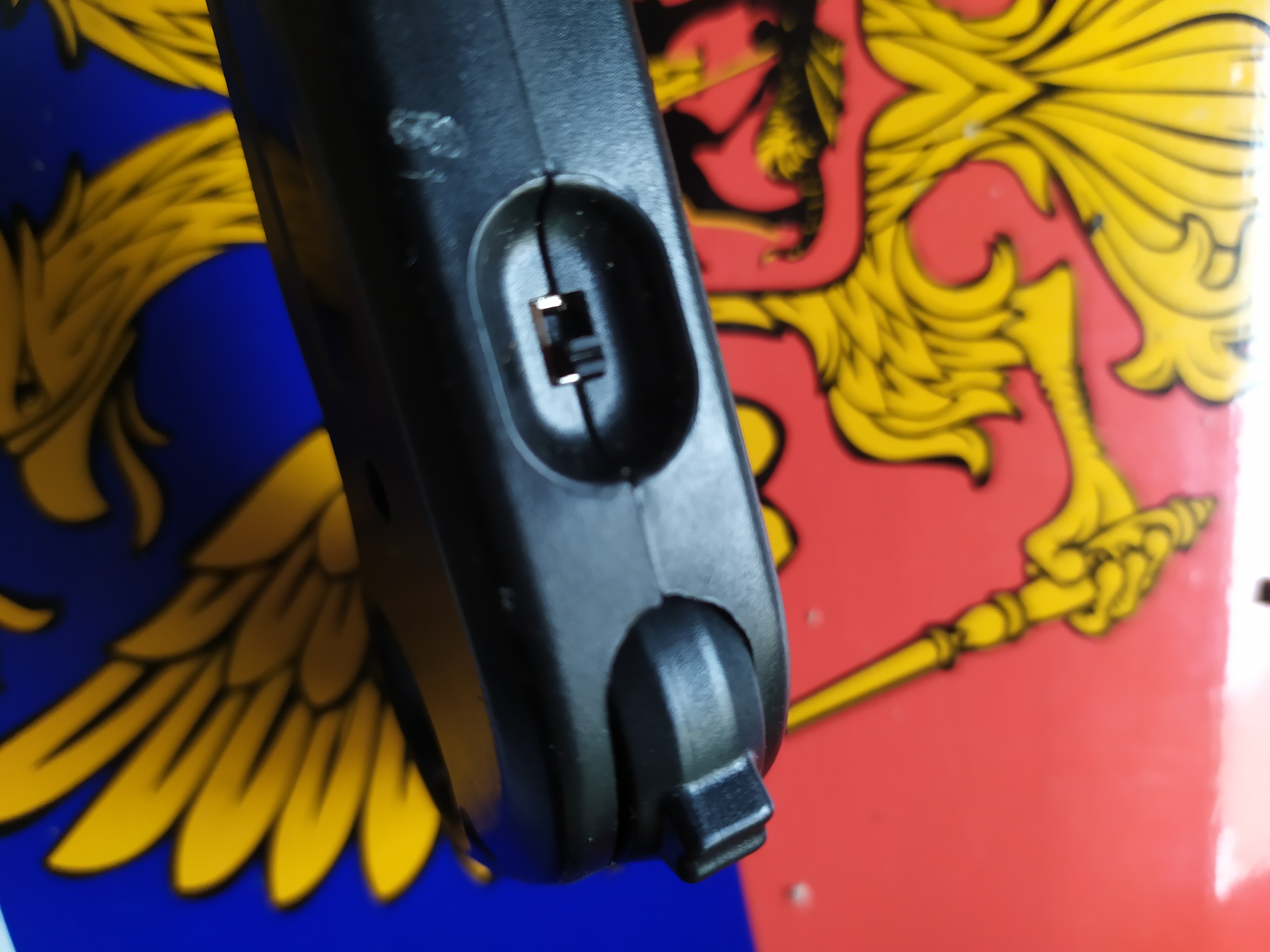

How could i use this switch on my remote that controls channel 2 on the receiver to turn on lights on my board?

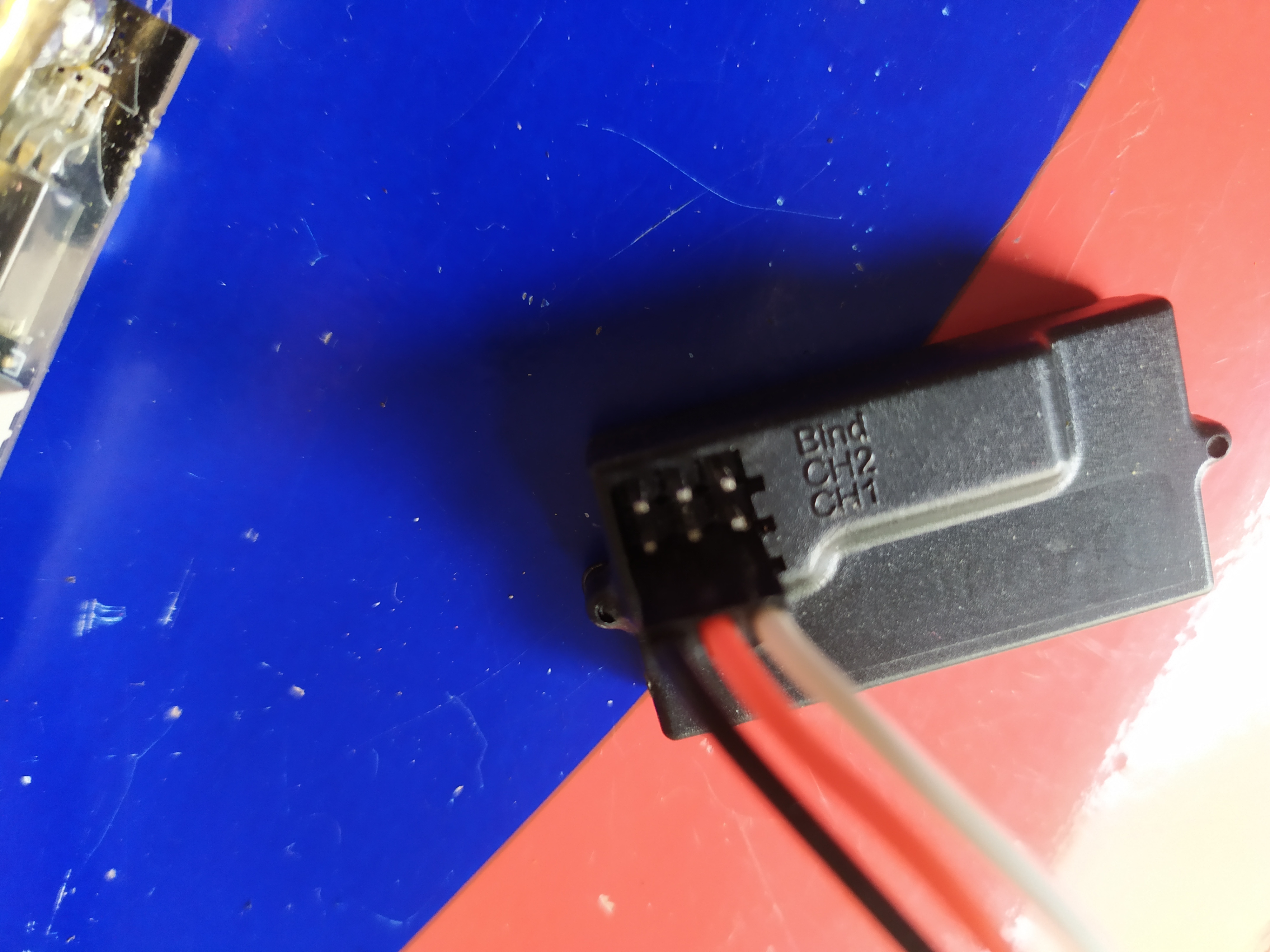

Well, what happens to the voltages on the receiver pins of channel 2 when flipping the switch?
I guess there’s gonna be some voltage change somehow somewhere. You could use an arduino, but a relay could be enough too…
Would you mind to test what flipping the switch does, then we can talk about how to use these changes in order to turn on lights :slight_smile:

between signal and ground it goes from0 to 3.28V and between signal and vcc it goes from 1.86 to 5.15
maybe i could use a relay that functions on 3.3 volts

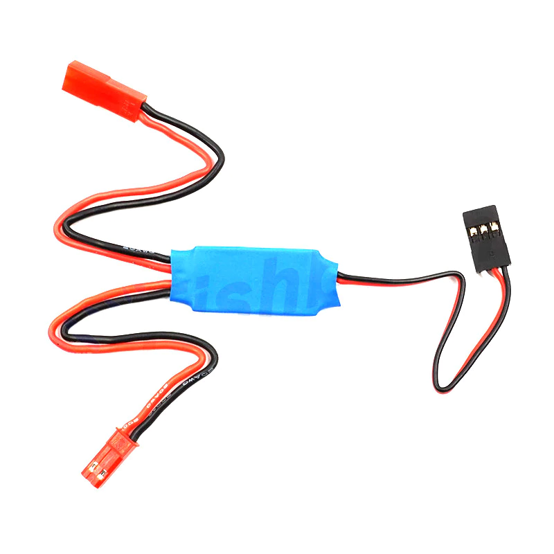

Get an RC relay like this one and put it between your lights and the power supply.
(Note: that one only goes to 24v so it’s suitable for 12v light systems but not direct battery voltage.)
It’s not just a DC voltage that changes. It’s a PWM signal whose duty cycle changes as a result of the switch. I’ve tried just using a relay across the signal before. It won’t work reliably, and may in fact damage your receiver.
My final solution involved using an adafruit trinket microcontroller to interpret the signal from the Rx and turn that into a nice 1-99% PWM signal that my LED driver could understand.
A microcontroller controlling a relay is your best bet, and luckily for you you can buy them prebuilt. This one has no problem switching full battery voltage.
It doesn’t work like that. It’s a logical toggle between high and low.
@Timmy, depends on what lights you want to you use but you cannot power them (or rather you shouldn’t) power them from the receiver. Find a relay with servo inputs. 3.3V or 5V should both be fine but my money is that receiver will work better with a 5V relay. On the other side of the relay, attach your light and power source.
Edit: just saw what @MysticalDork wrote, his is a much more detailed explaination
that’s 5 v though
Tell me what voltage comes from your receiver again?
That relay module is powered by the receiver, and uses that power to control a relay.
Relays don’t care what voltage they switch, only what voltage powers them.
3.28v
I meant the voltage between ground to vcc. It’s 5v. Which is what that relay module runs on.
yeah, it’s constant though. i won’t use that 5V as power for the lights

Relays are switches that are controlled electrically. That control comes from the 5v. Then the switch part of the relay switches your lights on and off.
would this work?
