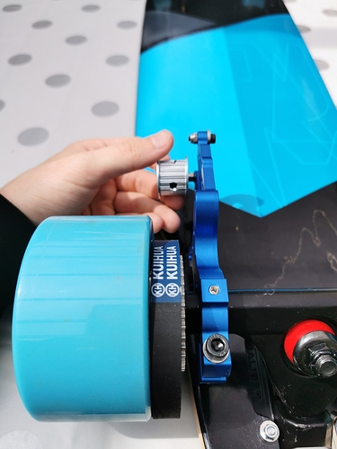

Does this look good so far?
I only tightened one of the clamps for the truck hanger, the other one can’t be accessed and would go through the hole hitting the edge of the truck… Is this okay? :
bring the clamp/mount a bit closer, you want the wheel pulley and motor pulley aligned. also don’t forget loctite after you have finished.
The motor mount is the wrong way around, the flat side goes towards the pulleys
excellent spotting lol

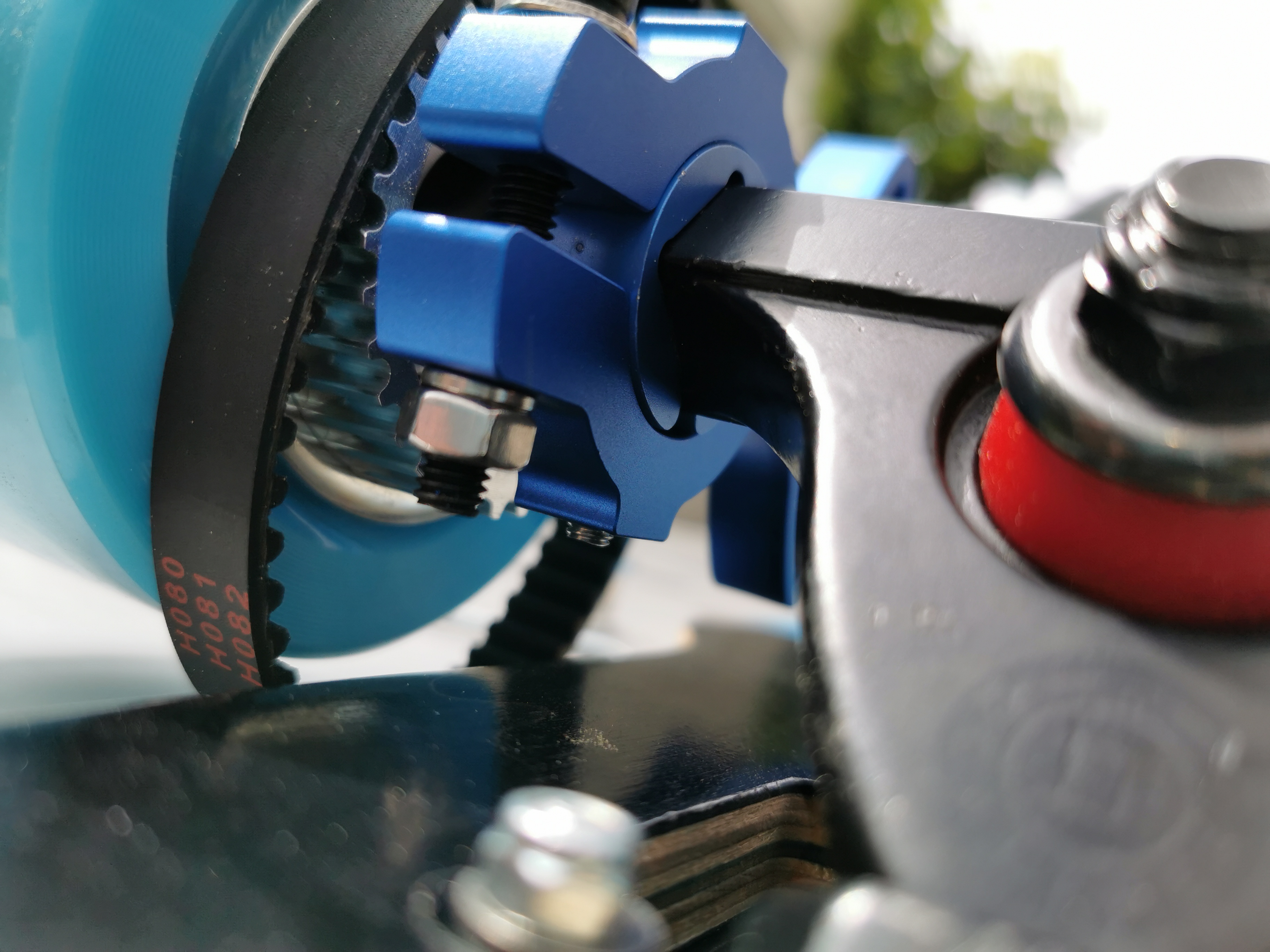

Oh yes, didn’t pay attention since the motor has yet to arrive. Tightened everything as much as possible. Still have minimal wobble on the wheel pulley so that I get this:
Can I ride with this and it will get away or should I really damage my truck by filing it :frowning:
Is the wheel wobbling or just the pulley?
You can try to square it up by inserting the large bearing in the pulley, put everything on the hanger, tighten down the pulley and then remove the support bearing.
Try to get it as straight as possible. Based on the sound in the video something is misaligned.

Really great to have you guys! Don’t know how often I would have failed without your help. The wheel pulley is pure perfection :slight_smile:
Doesn’t touch the truck any longer and sits very very close to the motor mount!

every screw needs loctite unless the screw already has some on it (blue stuff on screw). Often motor bolts have loctite already but not always.
As for loctite look here
Use 243 most of the time. 263 is like almost unremovable.
