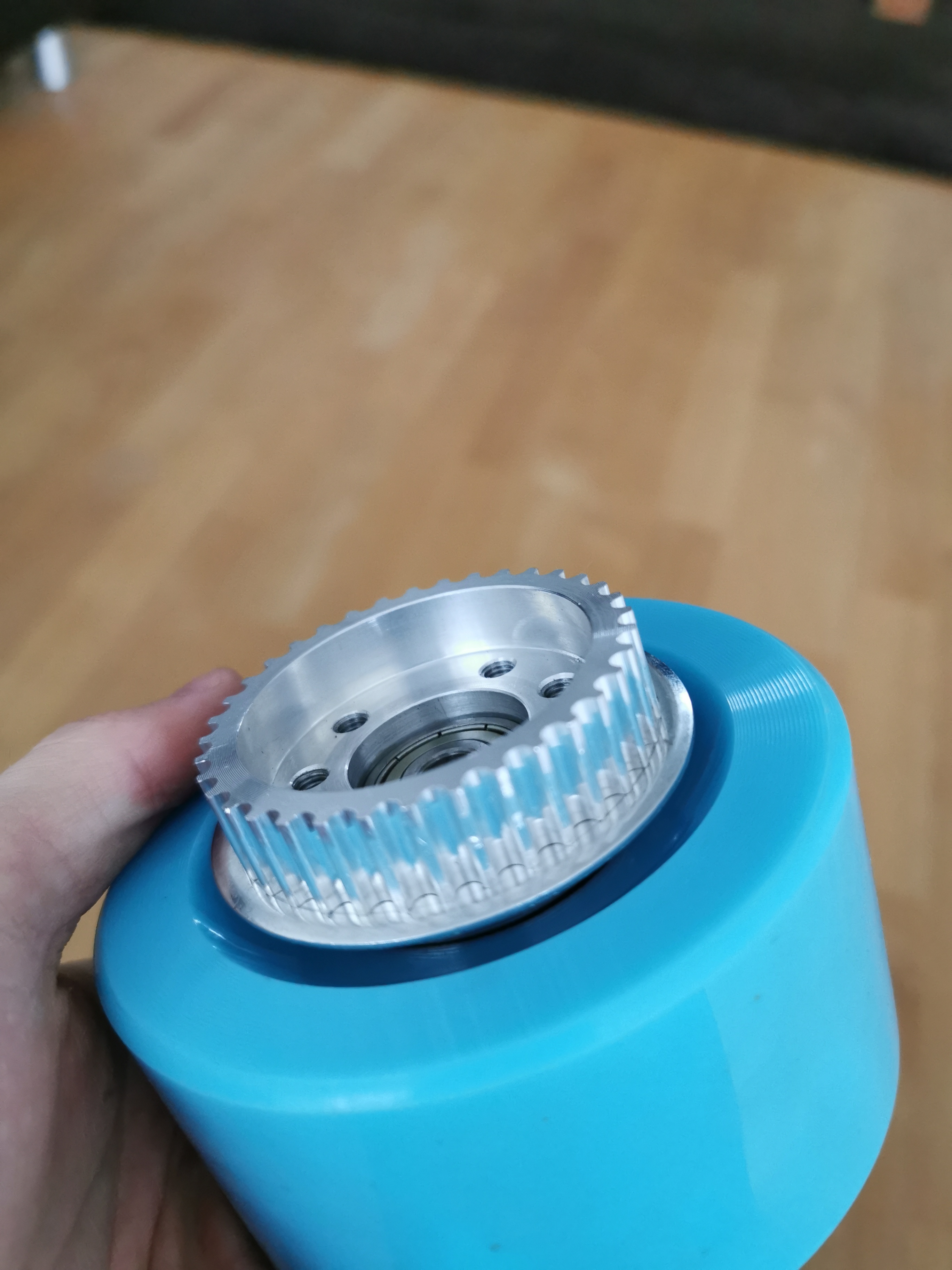

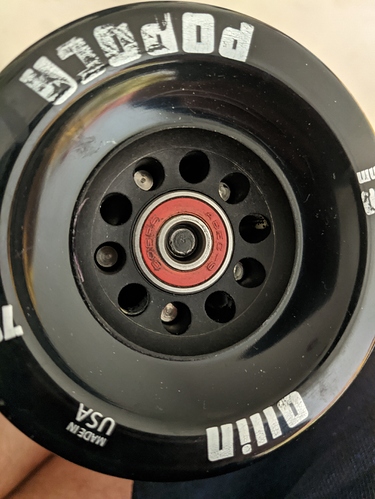

My wheel pulley + wheel don’t fit the axle somehow did I do something wrong???
Using 184mm Caliber II and 54mm wide (97mm big) wheels.

The silver bearing from the pulley stops the wheel to completely go on the axle, so I can’t nut it down
Square peg, round hole. Your pulley is hitting the hanger. Not compatible without shaving down the hanger to fit inside the pulley, or getting a pulley with a larger inside diameter opening,

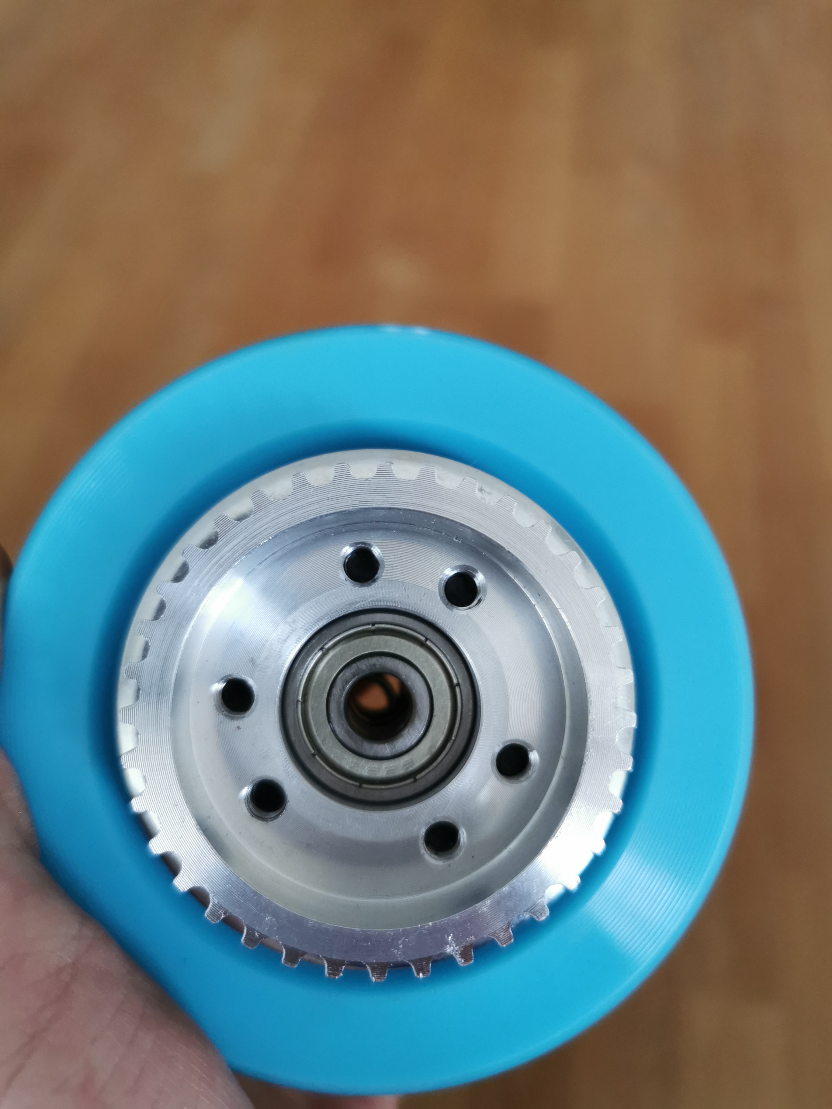

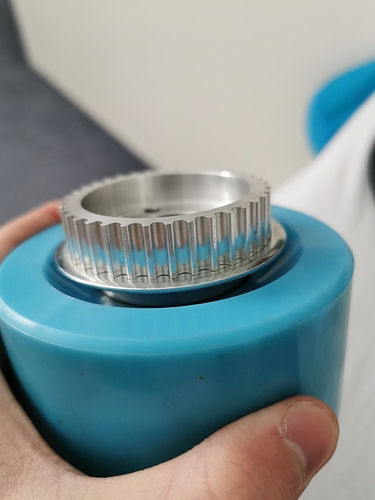

I’m afraid I don’t think your quite right. It’s not the hanger blocking it, but the bearing inside the pulley
I’ll add a foto
What do you think?
Turned up the lighting to make it more visible

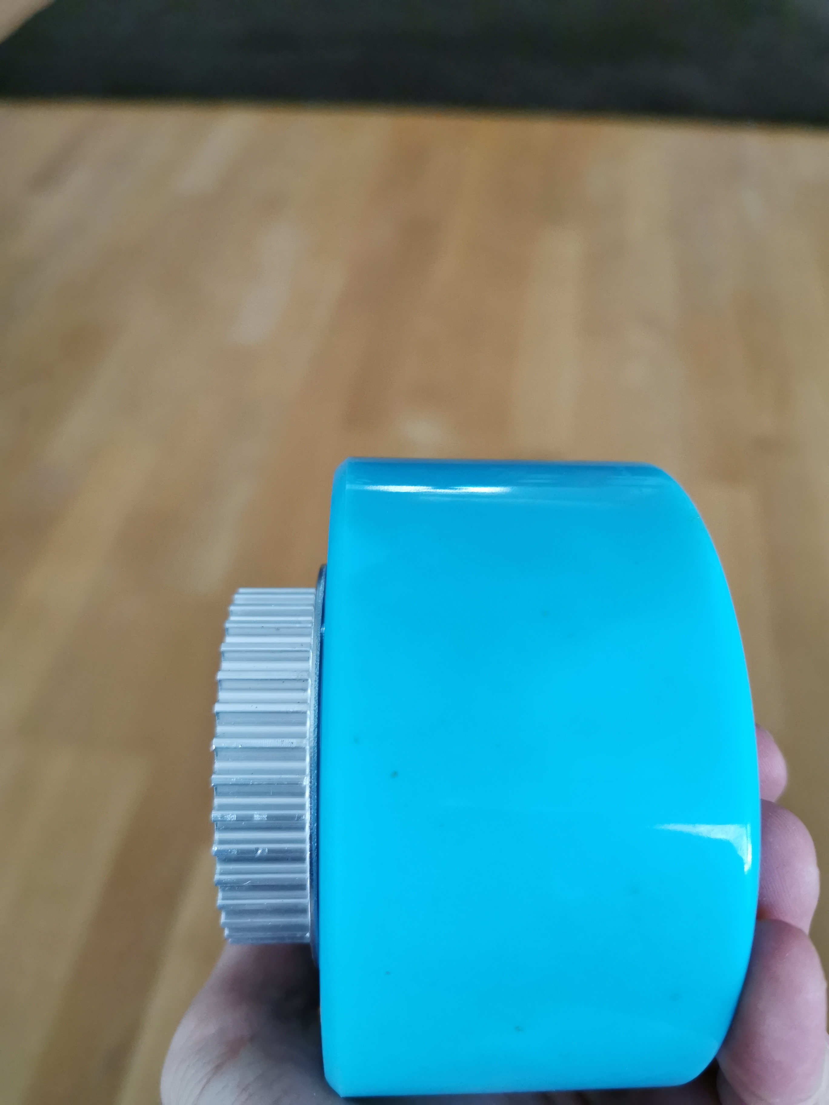

The pulley has enough space right?
Its just the bearing making the wheel+pulley to long for the axle
If the pulley opening doesn’t hit the hanger at all, then I’m wrong.
Niklas
April 30, 2020, 10:03am
#14375
Also, the wheel is still spinning, so it’s not blocked by the hanger I suppose. Rather the bearing blocking it from being shorter

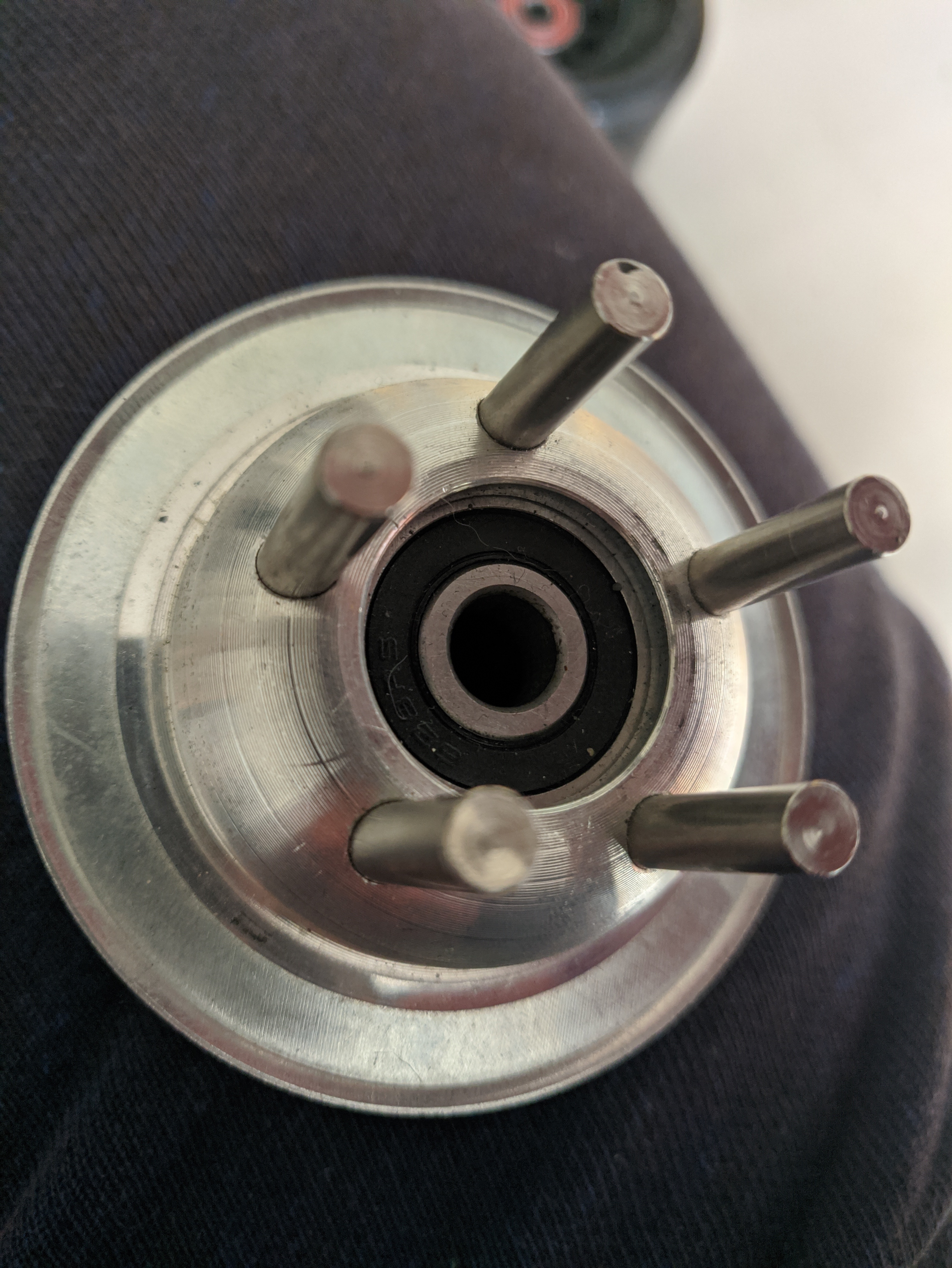

Could be the solution, 3 bearings seem to many:

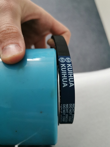

But the teeth would be hidden under the wheel so I can’t mount the belt

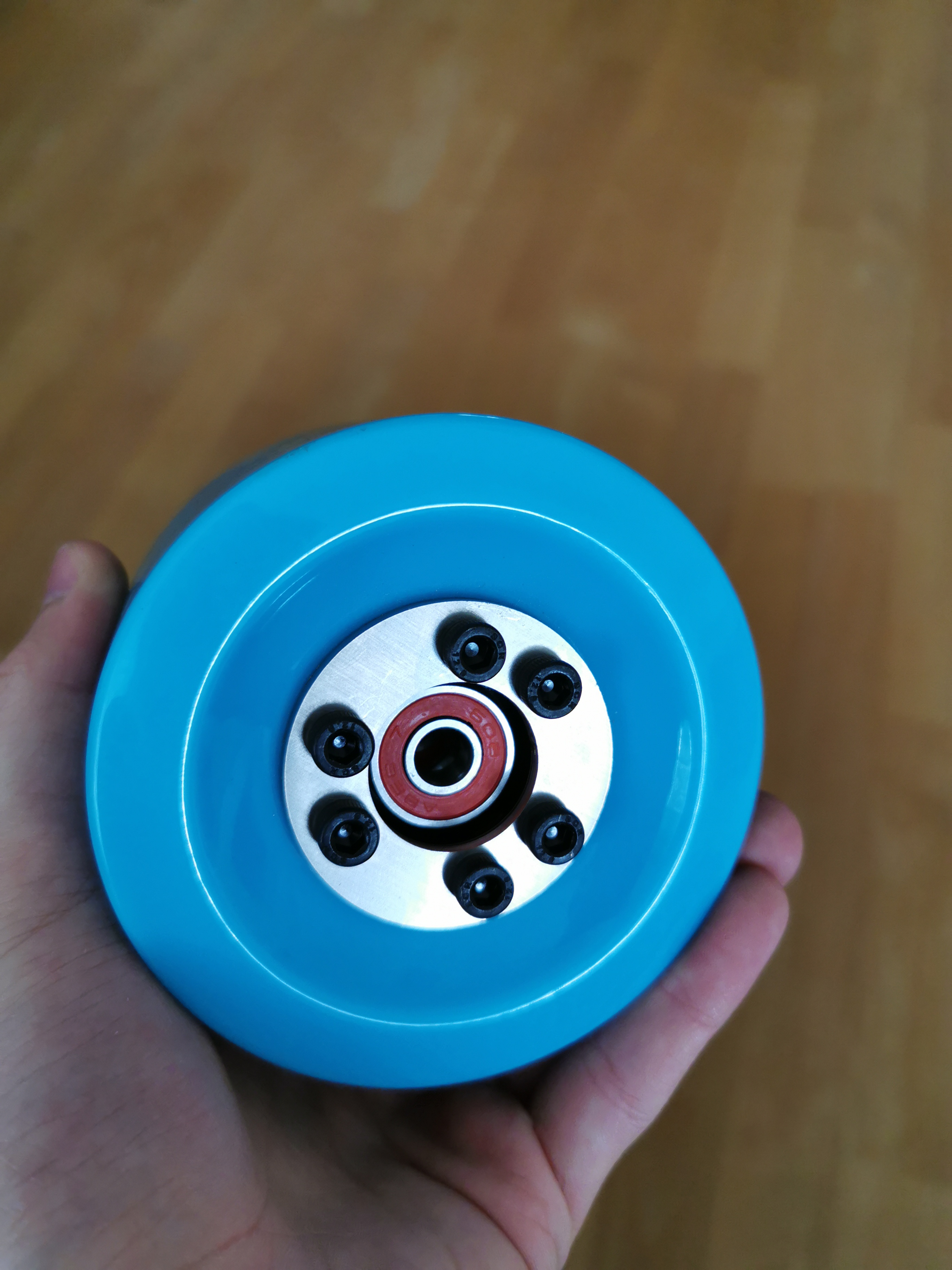

Everything would fit if I took the bearing out. But this might be torture for the wheel core as the belt is pulling it
Help im about to cry

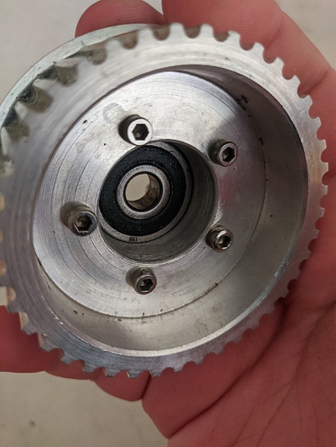

look at this.
this is my wheel pulley and it has it’s own support bearing.
if i use that+ the regular wheel bearings I can’t mount it because the support bearing takes away the space.
if i remove the bearing i can mount it
but then the pulley doesn’t have any support stopping it from moving so it flops out.
for that reason i need e-caliber axles.
your pulley is a hybrid of that. It should remove the inner wheel bearing and exchange it with a wider bearing that acts as the inner wheel bearing + the pulley support bearing at the same time.

So I should try taking one original bearing away and using the pulley one instead. Will try
