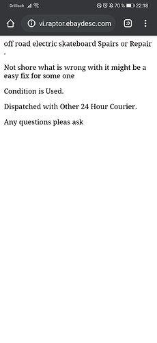

Sorry mate, but you can’t know what you’re betting on there… The description says nothing. Also the pictures don’t look that astonishing nicely said. It’s a bit of the gamble, you don’t need what is defect and even don’t know anything about parts used
924251910e84017cb549606ce04a73f36f58891e_2_460x1000~2
Not at all. I have one of these for my kid in a street version and it’s sad. Heavy ass sla battery, weak controller, no upgrade option. It’s OK for a kids board at best.

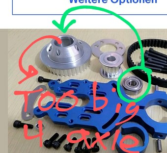

Yes but I thought the pulley is screwed on to the wheel which has two bearings… I still don’t get it sorry for being that dumb xD

It just adds more support for the whole system not having a big gap around the axle.

It’s support bearing. I have the pressfit version but it’s the same principle

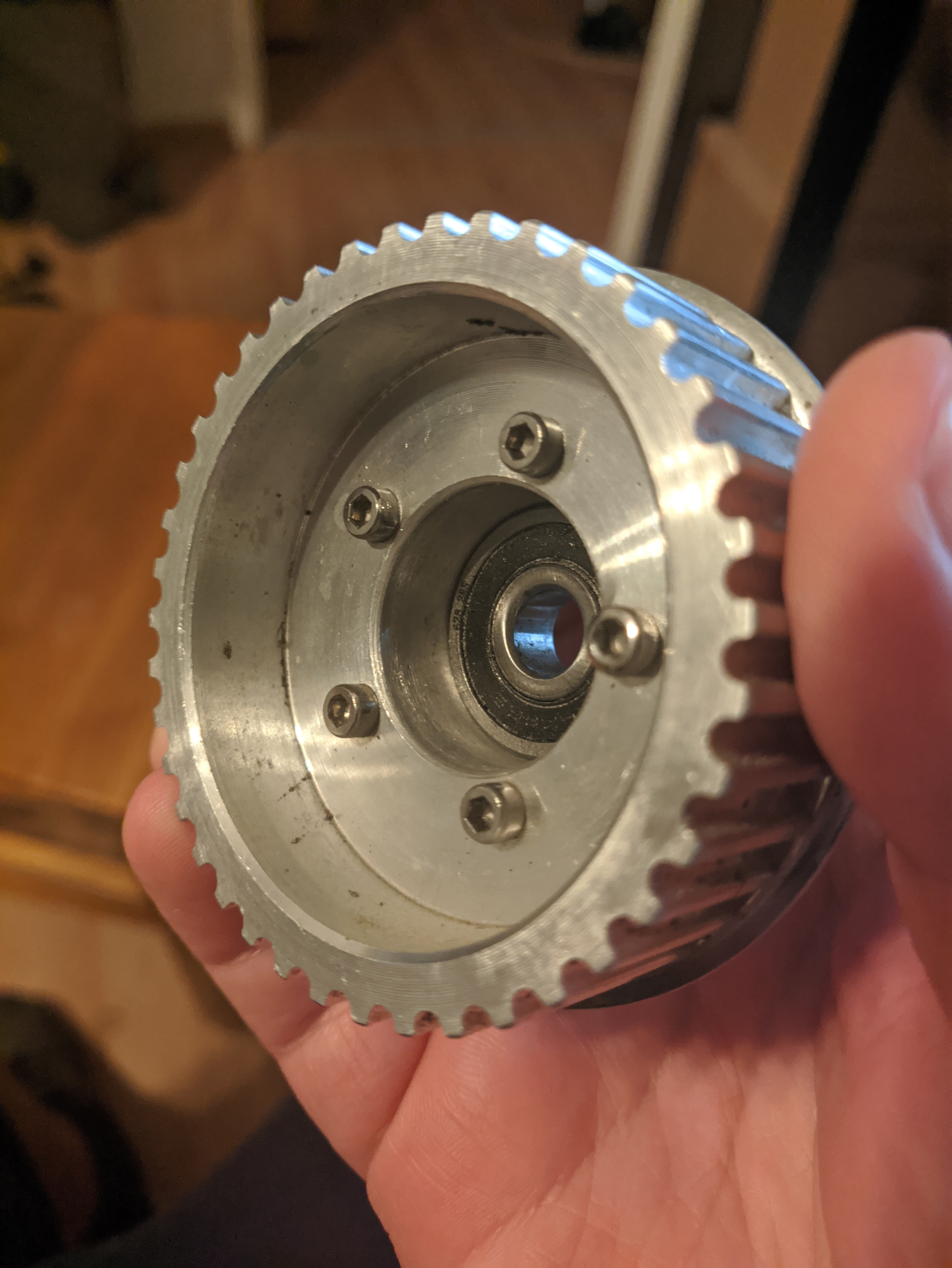

dicky had an image somewhere showing it.
Press-fit pulleys have a bearing that supports in line with the pull of the belt, so that the wheel core doesn’t have to support all that leverage load from a bolted on pulley. It’s more sturdy and supports the forces in line instead of cantilevering the pulley.

https://electric-skateboard.builders/t/dickyho-5m-36t-40t-flywheel-pulleys-on-ebay/49760/197
Thanks! So I’ll use the bearing!

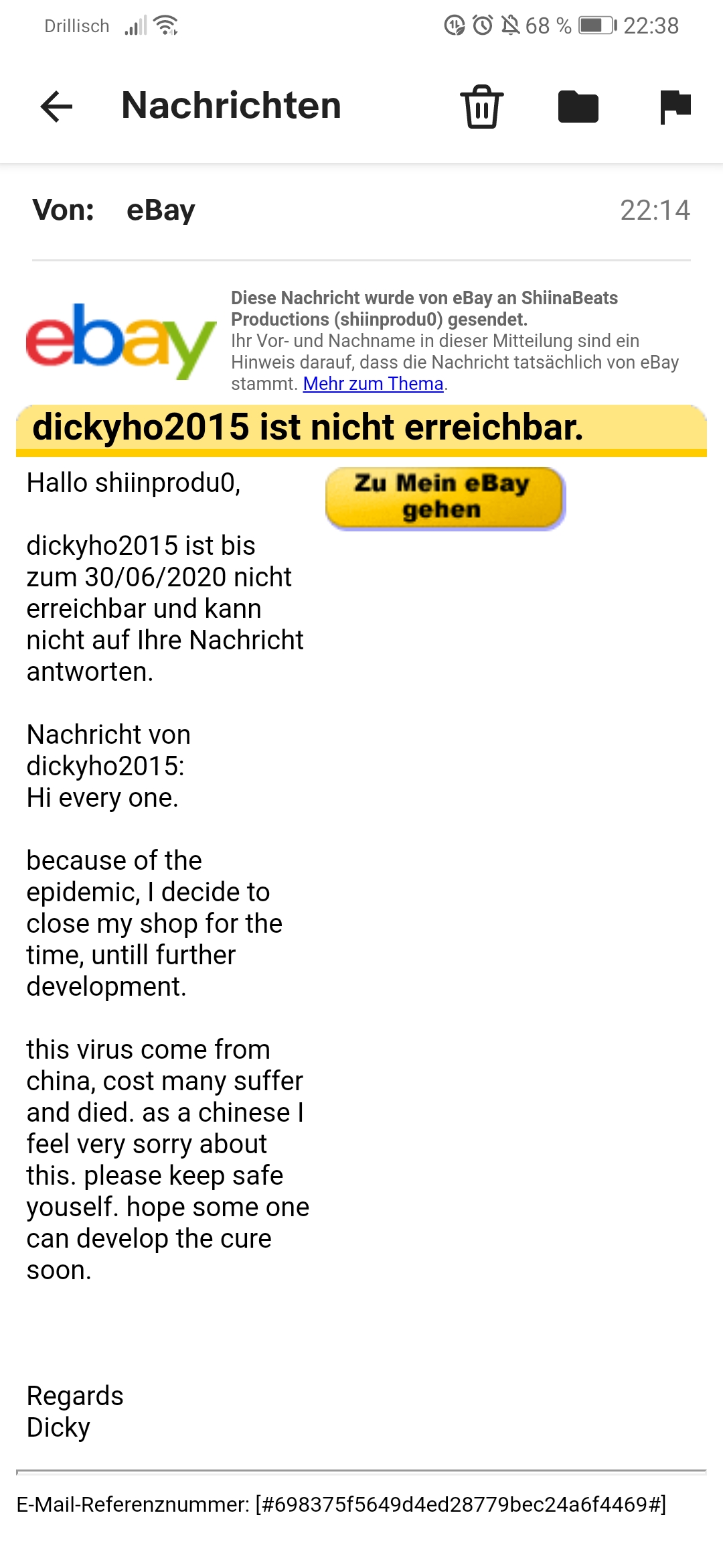

Wanted to ask him over ebay but…
Yeah :confused:
@dickyho ↑↑

I suggest you get a 10mm wide bearing since the pulley has a 3mm inner lip, if not you will need to add speedrings in order to be able to tighten down everything, you can skip the support bearing if using a 10mm wide 608 bearing but you need to use the bolts

So put one on the wheel and one to the wheel pulley which will share it with the wheel?

the ones you got a standard 7mm (iirc) bearings. For the kit you need 10 or 14mm thick bearings to reach over. That way the pulley and wheel can share the same bearing. I’m not sure if dicky changed the way the pulleys get mounted.
For my pulleys i need 3 bearings, for the listed one, 1 standard and 1 wide.

i still think you need 3 like i have
So one or two of mine like normal patchwork with the second/third one coming in the kit inserted into the wheel pulley.
Alright! Got it!
