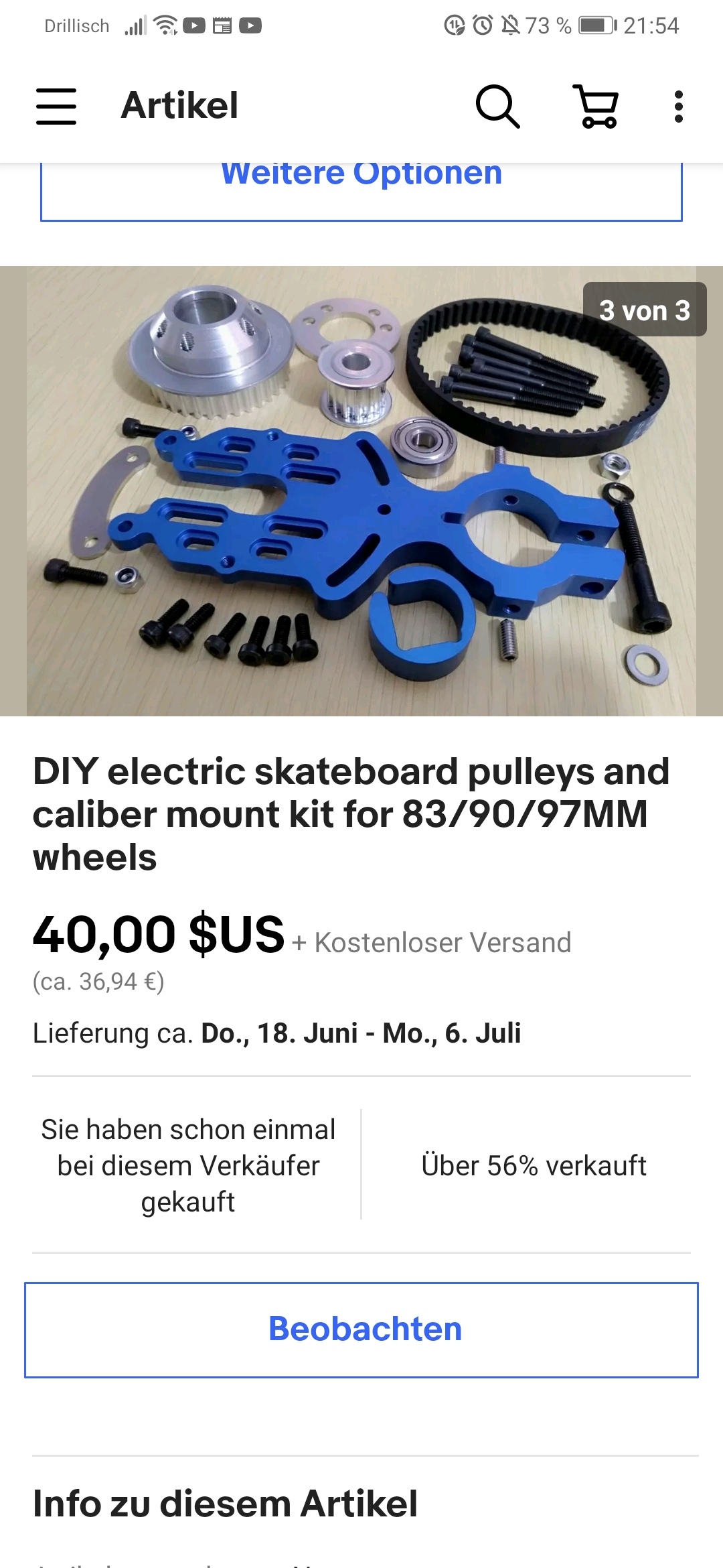

How is the motor pulley mounted to the motor shaft?.. Is there everything included in the kit needed for it?
with a (or 2) grub screw/s.
The rest is all included

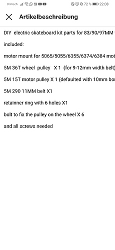

So no grub screw included?
Where do I get this :sweat_smile::neutral_face:
Kind of misleading… ā€œall screws neededā€
Make sure your motor shaft diameter matches the pulley inner diameter too (10mm bore) . You could just message the seller and ask to include grub screws. If not, they’re dirt cheap at a hardware store.
I made sure, thanks, that would be a pain in the ass to realize later on!
What size grub screws do I need? I don’t know what to search for…
I went with 8mm bore pulleys
And what’s the bearing and the rear banana shape silver metal part for?
I imagine the seller would include them but you can also use green loctite in place for semi permanent attachment. I had a motor gear that didn’t have a grub and was the only way I could attach it.
Bearing goes in the wheel pulley, banana piece probably attaches across the back of the mounts to round them off but I’m not 100% on that. Some people run metal crossbars like a cage around their motors. They could mount there too.
I can’t imagine why and where you would use a bearing for the wheel pulley. Is there any documentation on this forum or Yt how to put this together?
