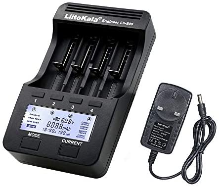

That’s them lots of fakes one I bought on Ali gives different capacity to the other 3, the printing looks different too.
