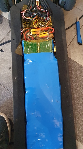

after selling my hummie build ([WTS][EU] Hummie complete - Bergs, Kahua, 12s6p 30Q, dual ESCape) I went out to test it last time before shipping. after 15 or so minutes, I got micro cut outs - they started to appear no matter what speed, but only after 10-15 mins or ridding.
motors are maytech 6880 sensored, 80A per motor, around 25 degrees celsius outside temperature
Removed enclosure, everything looks fine, isolated and in place. opened battery, every group was 3.61-3.64v, so not battery either. I am discharging through bestech d596, but everything seems fine with it. insides:
looked at my logs and here is what I see with motor temperatures:
so my guess is: vesc is thermal throttling because of too high motor temperatures.
first thing I will have to do is try riding unsensored. but how healthy is that for motors? they were hot when touching them, but nothing extreme, hot as always.
anyone with similar experience? what could cause those micro cut outs except too high motor temp?

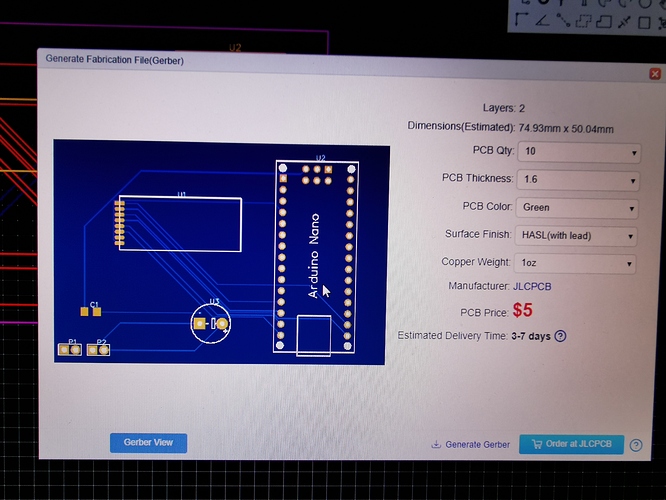

You can use any software, I just need a Gerber file for JLCPCB :frowning:

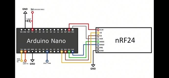

have you already prototyped your design on a breadboard, or are you adapting/deriving someone else’s schematic?
Its a schematic from a project already existing, only have an image of it:
Though is one is missing on tiny ceramic capacitor

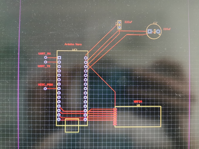

Here’s the complete schematic made by myself:
The VESC and PPM Pins should be these pcb holes where you can solder in your cables

just curious what role does this decoupling cap play? sorry it’s not obvious to me
y u no just get a $3 nano and a 60cent nrf module, and use the 0.1" pitch holes to prototype your project and test your firmware before committing to a manufactured pcb?
Other people have done this successfully
The 22pF capacitor is to prevent a big where the Nano resets itself. The 220uF is for smoothing the 5V from the VESC.
Btw I made it work.
For me its simpler to prepare everything as a schematic, then use autoroute.

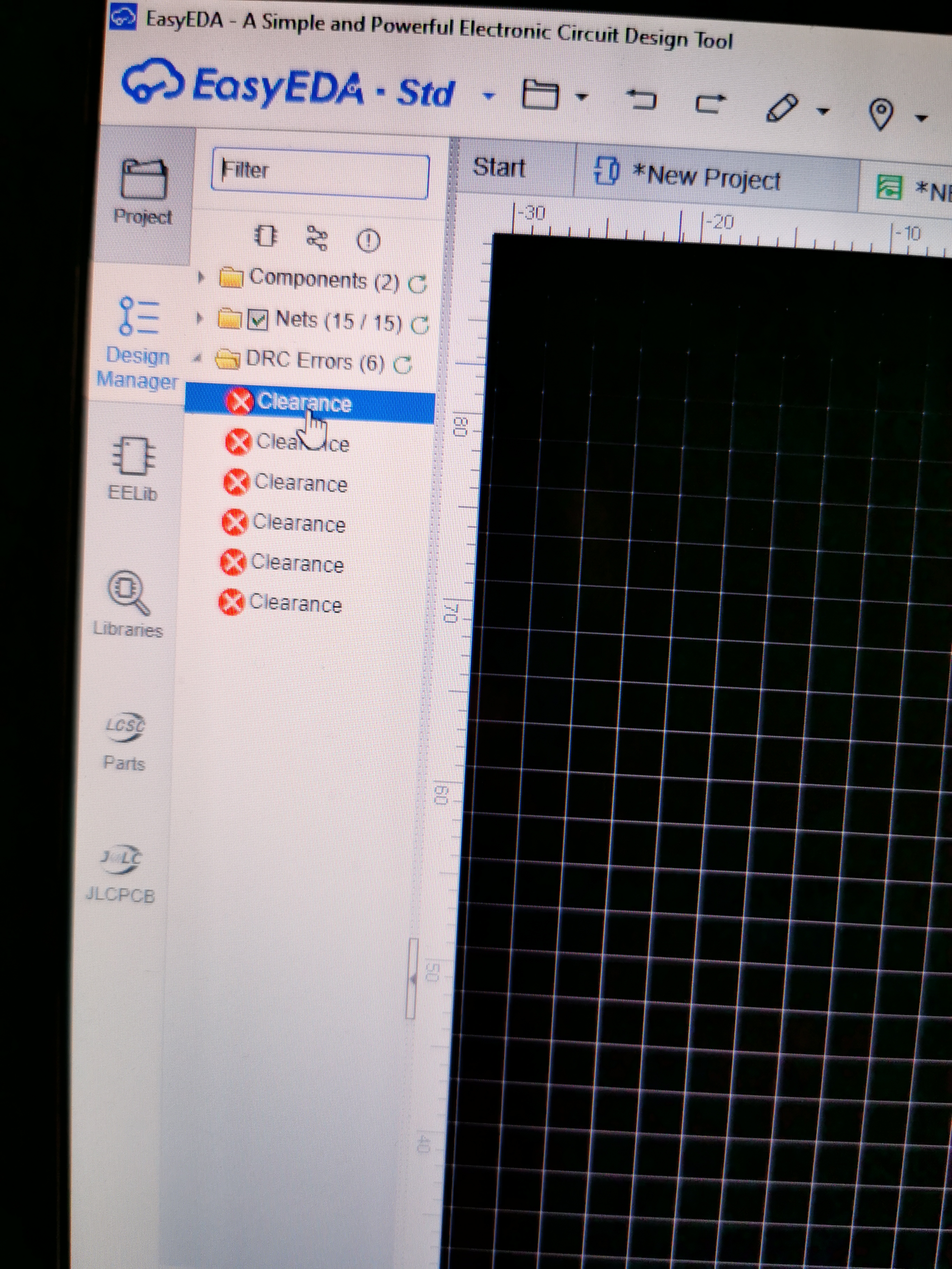

I’m missing the GND connections somehow though…

i thought the cap goes between rst and dtr (or rts) not gnd, but see those are the kind of mistakes i make that lead me to prefer prototyping on the breakout before getting pcb’s made
Just solder a wire on there and cut it with snips when you’re done.

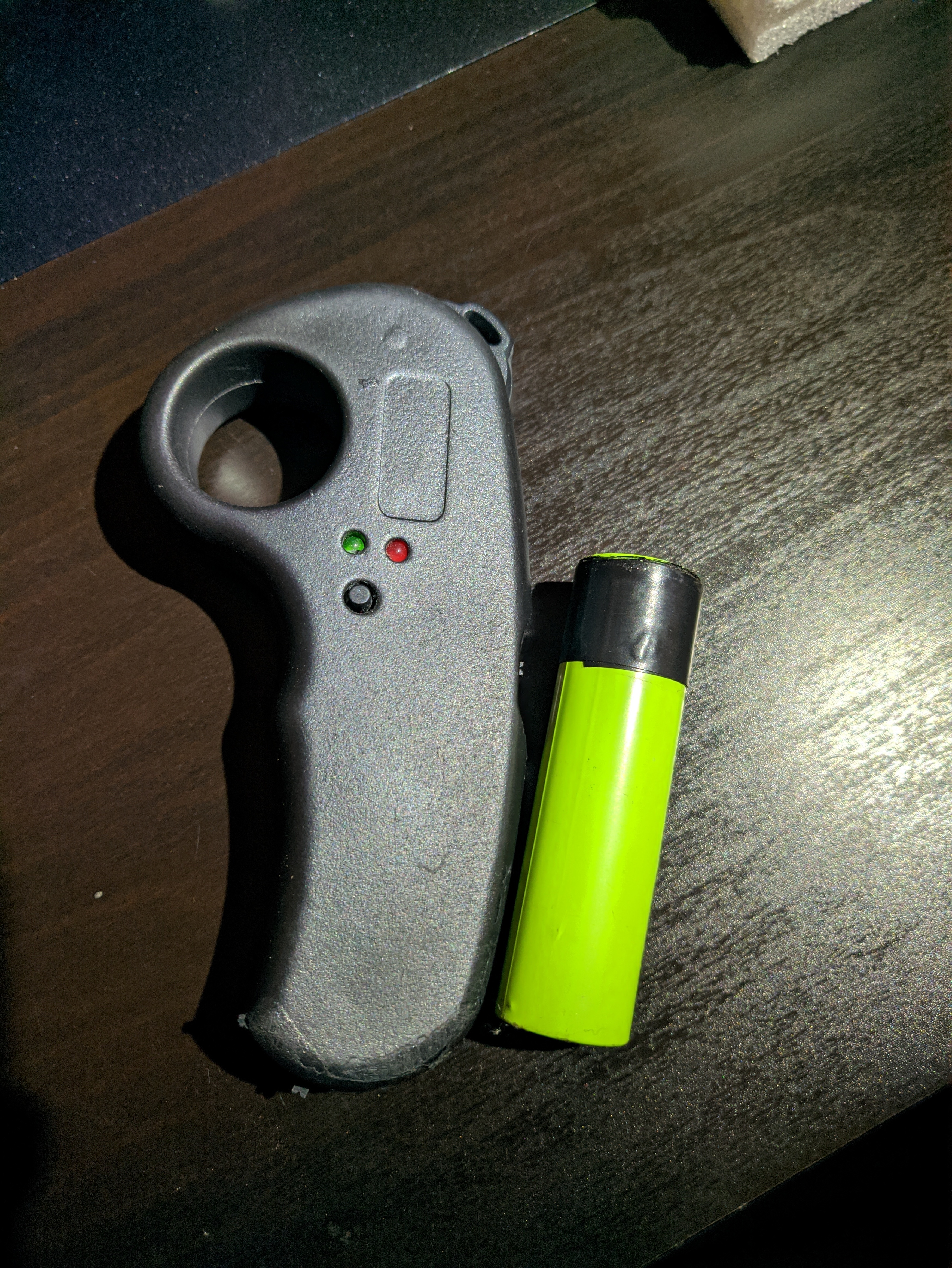

How big is a nano remote?
Like approximate length and width?
11,3cmx5,6cm on the finger hole side and 3.5cm regular
18650 as comparison
