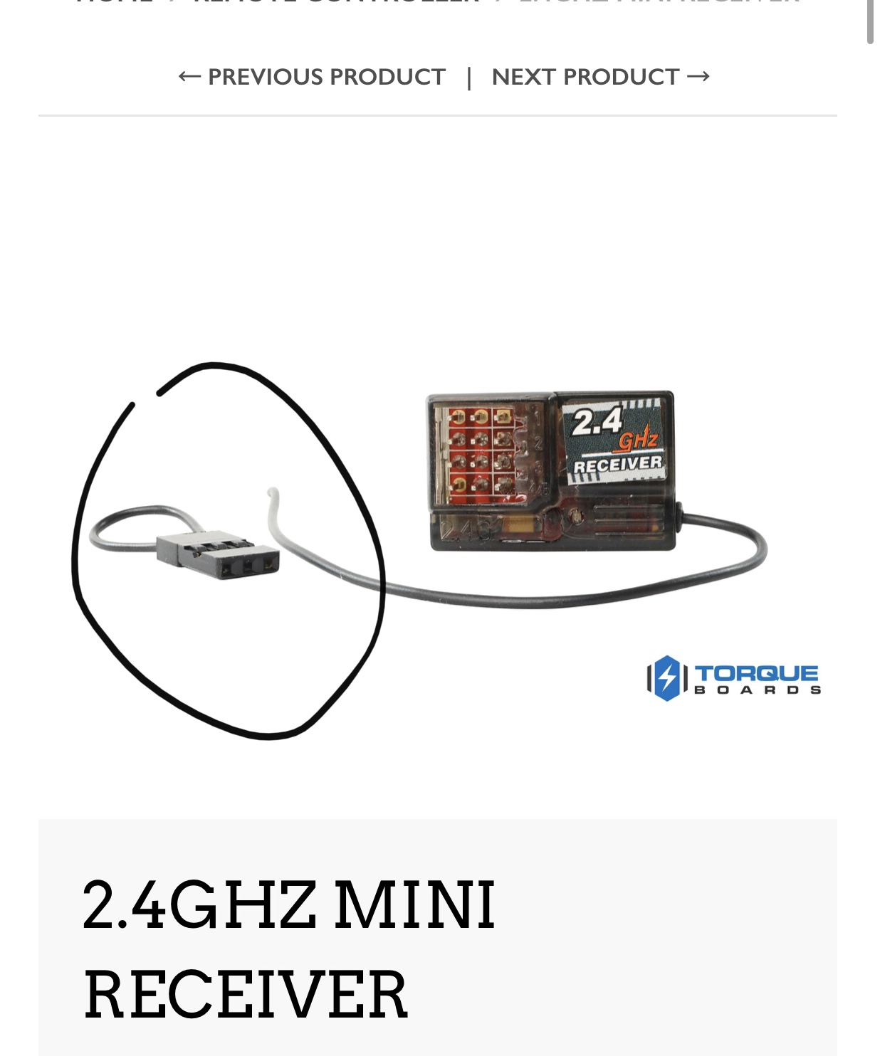

Last guess!
You need to do something with the bind connector.
See how theres:
Bind
Ch1
Ch2
In the Nano remote video the guy put something on it
Wait a sec

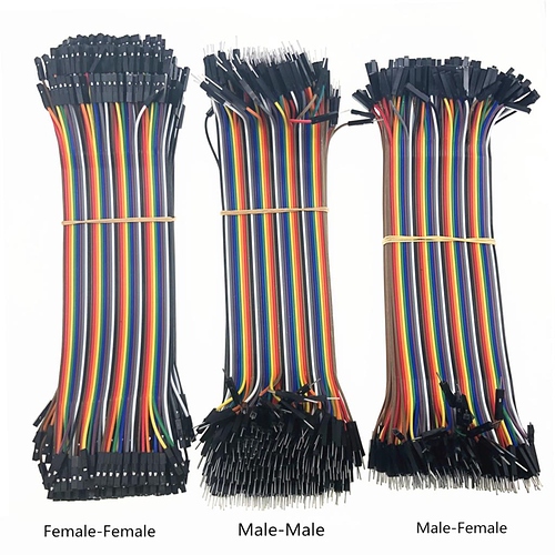

I’ve tried a lot of things and I can’t find my binding tool to just add another rec :sob:
Is there a way to make a diy binding tool?

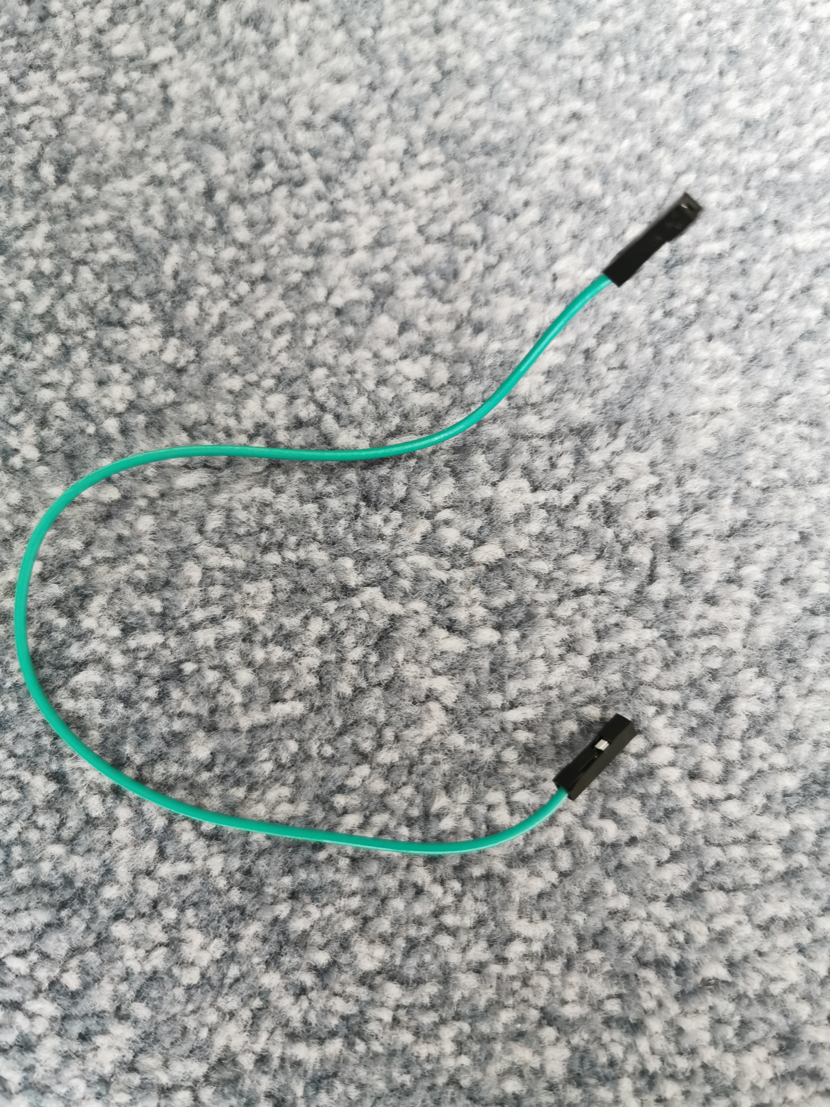

Hold my beer. Wire cut the end of a paperclip put 5mm of tape in the middle then short pins 1 and 3 with ends.
Sure, you can use female arduino cables. They’re called dupont jumpers.
I hope you have some
If not, go for @Movation
Binding tool
Sure but not everyone has them.

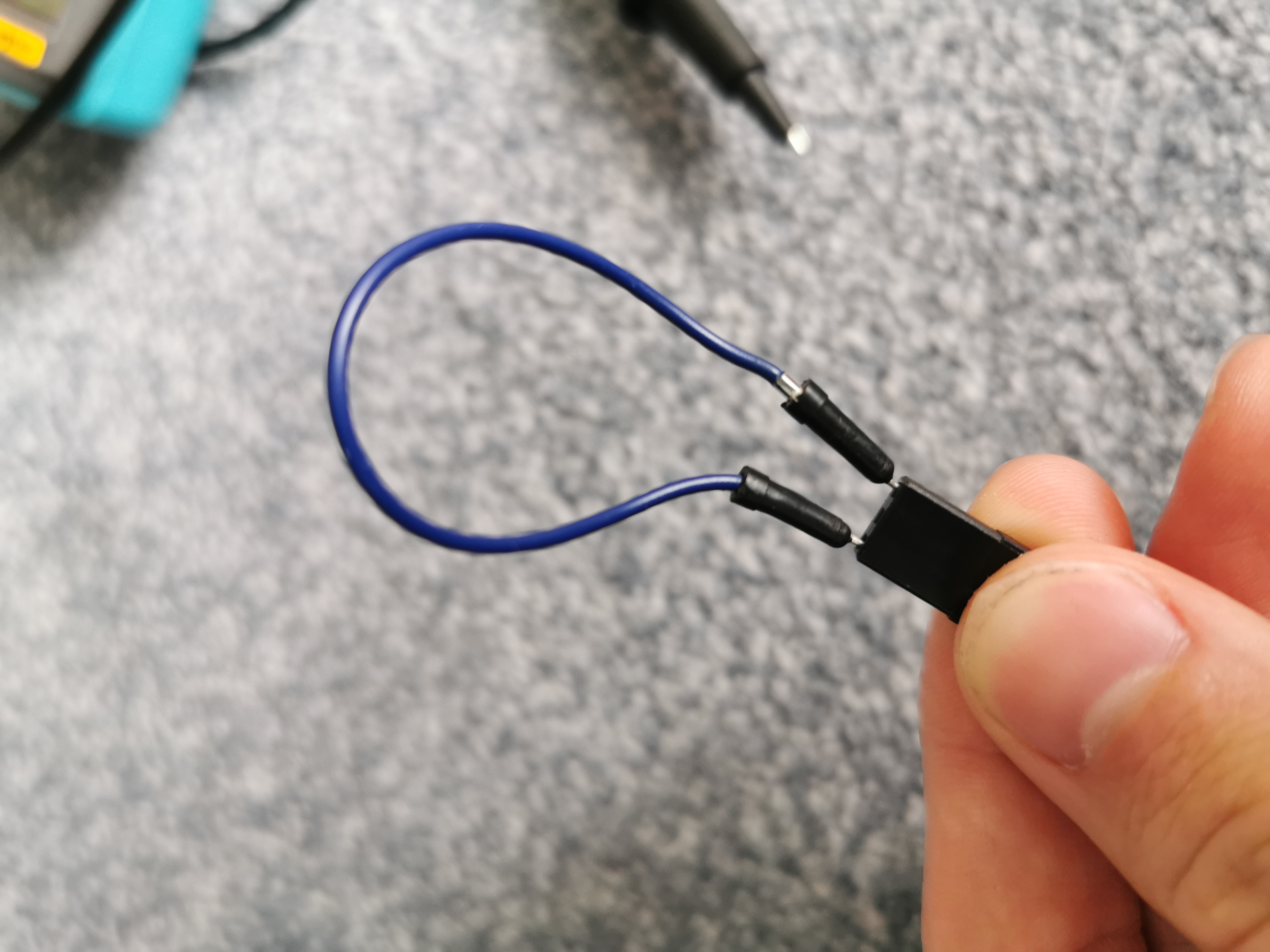

Exactly, you’ll need one of these or make one yourself. The clean way would be using this:
Then just connect left and right pin of the bind slot.
But I suppose you don’t have such cable?

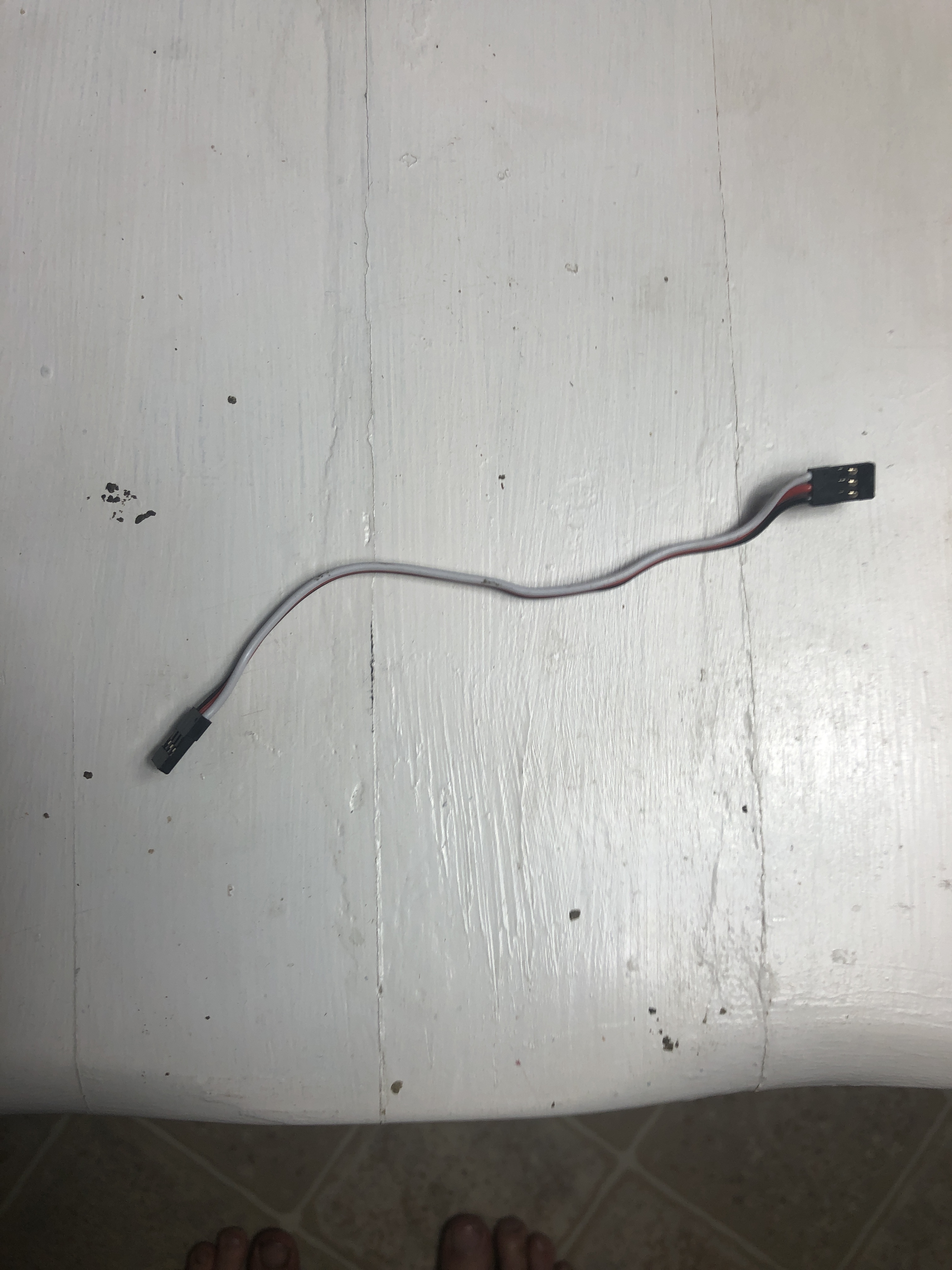

Can I make a diy binding tool with male to Malle servo???
Yes! You can!
Put one end on the bind port
And the other side as follows:
Any wire or metallic thing will work
Sweet I’ll try @Niklas thanks for helping :facepunch:t2:

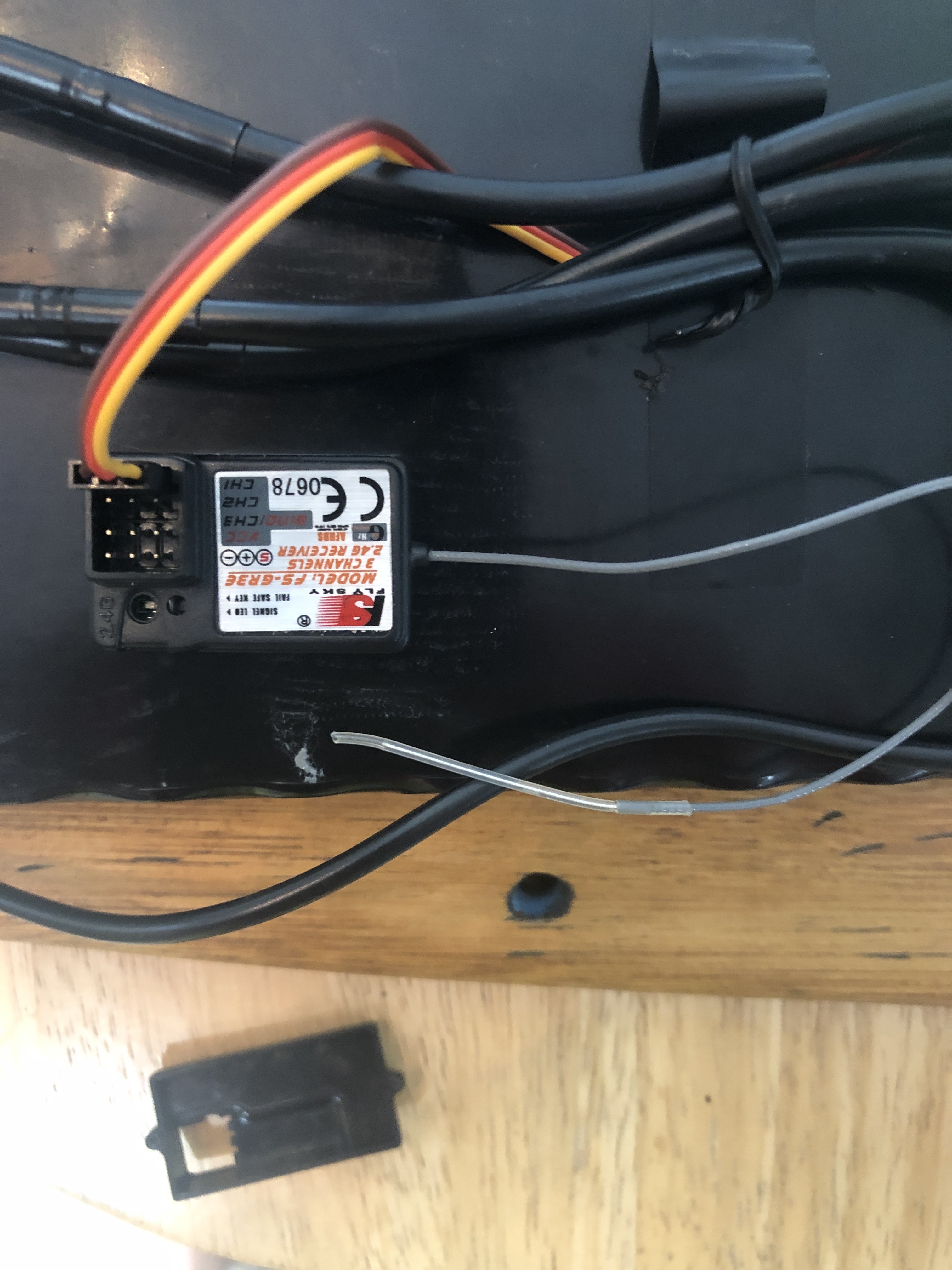

Please send a picture of your connection before you try anything!
Will do
Try using the bottom connector also try flipping the cable 180 you won’t damage anything if it’s wrong.
Good point!

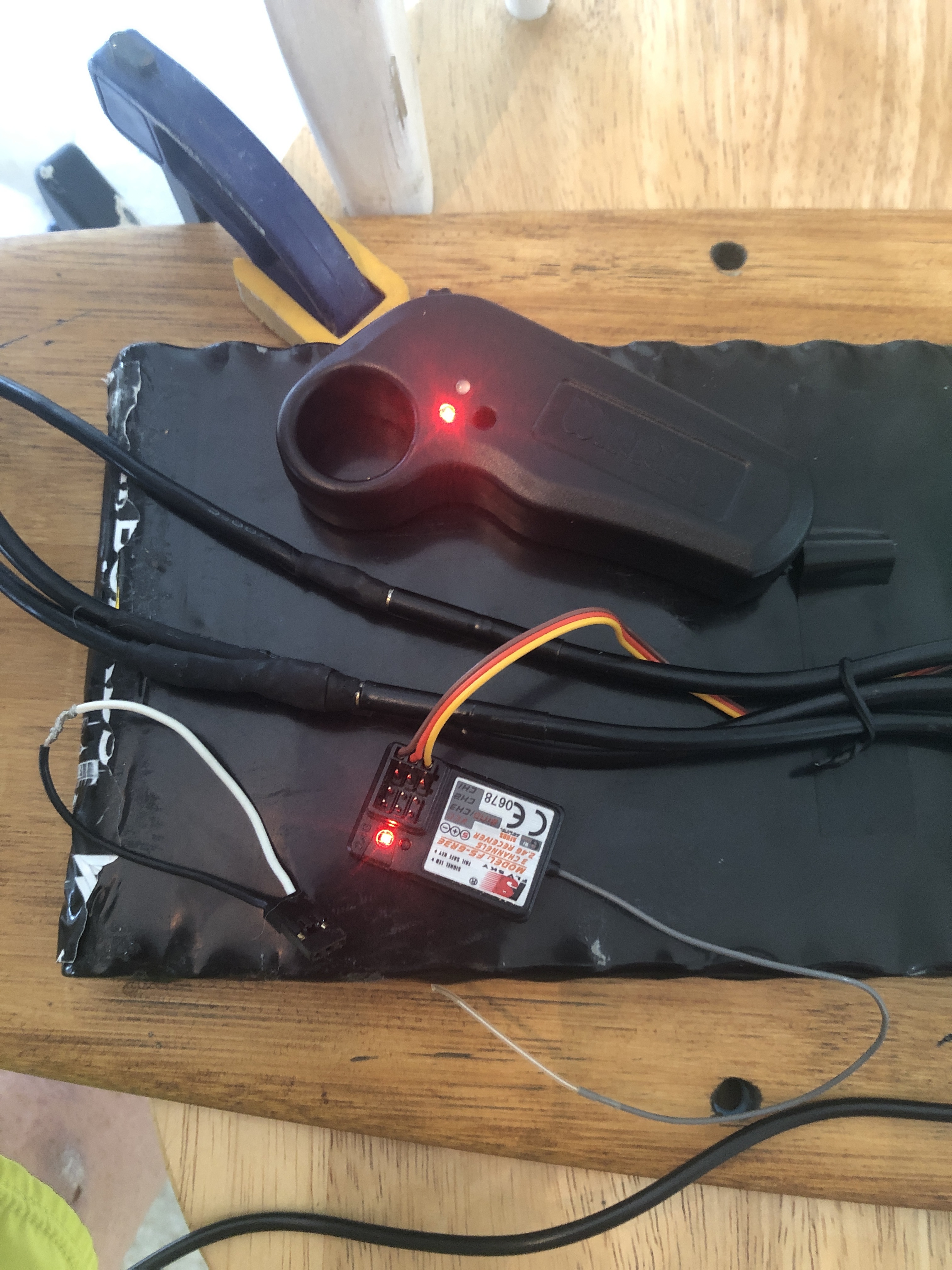

3 pin wires to channel 2
Bind to channel 3 / bind :slight_smile:
Why did you put the wires back in channel 1?
