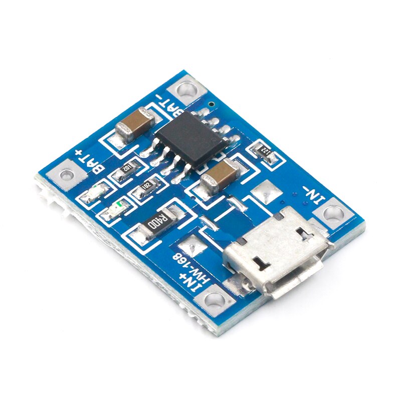

@Scepterr do you remember where the tiny PCB came from that has 4 dots for showing the charge level of a lipo cell?
I can’t find the link or the product anymore and don’t see them in my purchase history for eBay, amazon, AliExpress et cetera

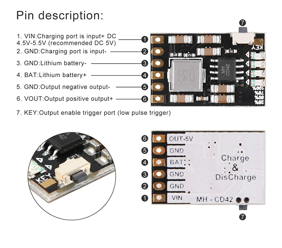

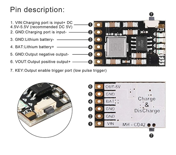

https://www.amazon.com/dp/B07PZT3ZW2
@xsynatic :arrow_up: this thing
And JB Weld all that shit in the Mini Remote housing, drill holes for the LEDs, put clear sealant over the holes
Actually, that one has all kinds of stuff, the one I used is ONLY an indicator and nothing else, it has 2 leads: + and -

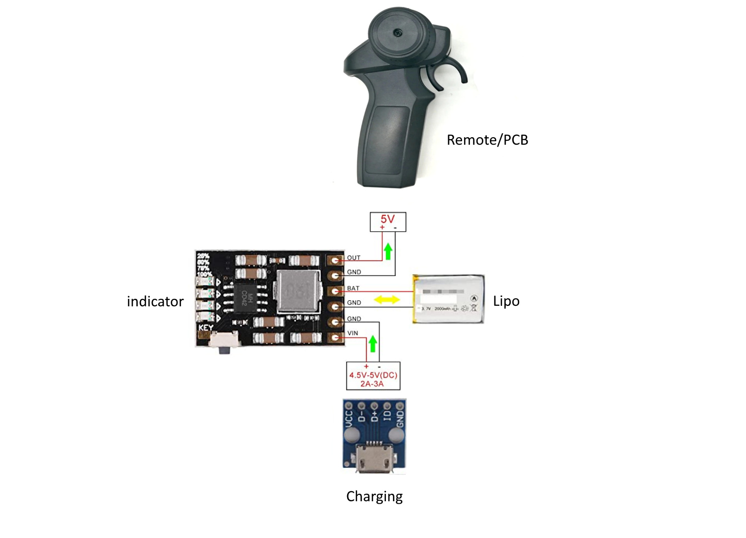

so i would need a 1s Lipo
connected to this
in between this
and the on/off switch gets connected to one of them?
no the thing I linked does everything, charging, indicator and 5v output

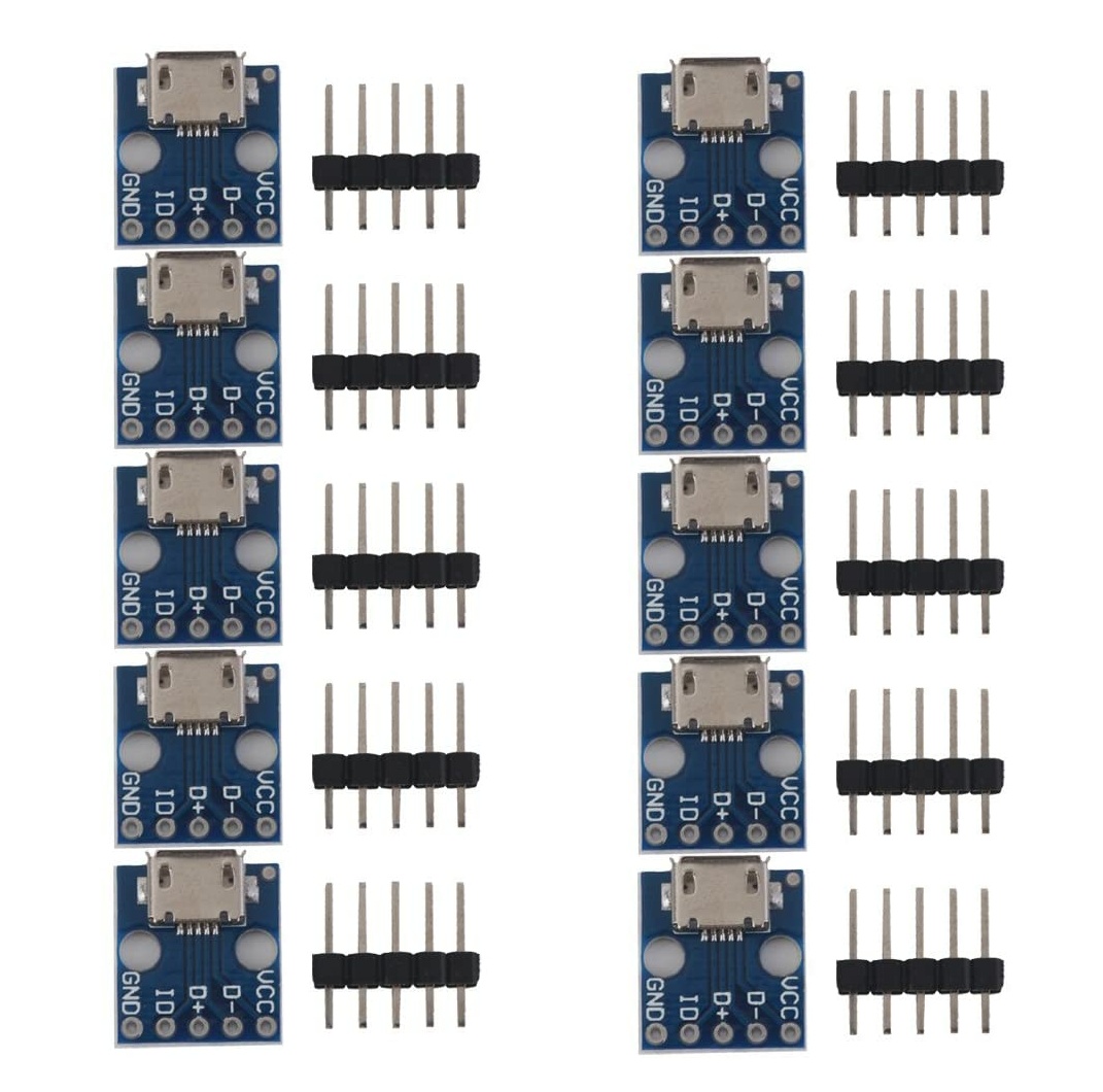

but where’s the charge port or am i missing something?
https://www.amazon.com/dp/B0183KF7TM/ref=cm_sw_r_sms_apa_i_v.3MEbFEGK5CB
No modded case. If you are crafty, there is enough space in there, but it’s really tight in the top to fit all the charging and indication PCBs.
That’s why I suggest a smaller pouch cell — so you can put those PCBs in the handle.

@nsteph
so like this?
yep that’s it
fyi, I wouldn’t use more than 1A charge current for tiny lipo
