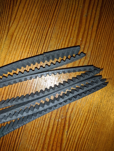

i did run shorter belts and removed the idler. I don’t remember if i liked it more or not, i definitely felt more vulnerable with them. Once they broke i switched back to idlers. The sound isn’t/wasn’t always there. At a certain speed it goes away (the same sound as with the braking sound) Honestly, i can’t tell you if that sound was there as well.
yeah i’ve heard a thing or two about that myth.
Thats a really strange one, my board becomes quieter than wind speed at about 25kmh so the fact you have all these noises coming from the belt specifically really make me ponder. You have a crossbar so the mounts are obviously straight, I can see the wheels clear the bearing for sure, I think it has to be a bad pulley somewhere, maybe your motor pulley slipping?

Zahnriemen Verschleißbilder / StörungsfĂ€lle
sorry guys, i cant find this in english - its a compedium of a local company for fault symptoms with timing belts - check it out @xsynatic
i have that too, the board is almost silent at a certain speed, but braking and accelerating currently is super loud until a certain point.
Pulleys don’t move, they are well loctited and use a keyway. I still have a different Motor pulley left, maybe i’ll swap the current one and test it again. (It’s still is the same pulleys as i started the build with, maybe 1800km ago)
