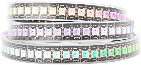

What kind of LEDs are you planning to run? What is the maximum number of watts you want to come out of the converter?
Around 2 meters of WS2812B along with some EL wire
Do you have a link to the exact LED strip? I need to know how much power it can take per foot, and that varies from strip to strip. Also the EL wire should say on the inverter.
Sorry was calculating …43w per meter (.3w per led) so 86w. Link:
the el wire I have no idea it’s not specified. Here the link to it
https://www.amazon.ca/dp/B013FZHD7O/ref=cm_sw_r_cp_apa_i_jAtmDbW0TAKG0
So worst case conditions: full power on every LED, drawing 86 watts, with an 80% efficiency of the converter, running from a dead (30v) battery, it’d pull about 3.4 amps, which that switch will totally handle.
