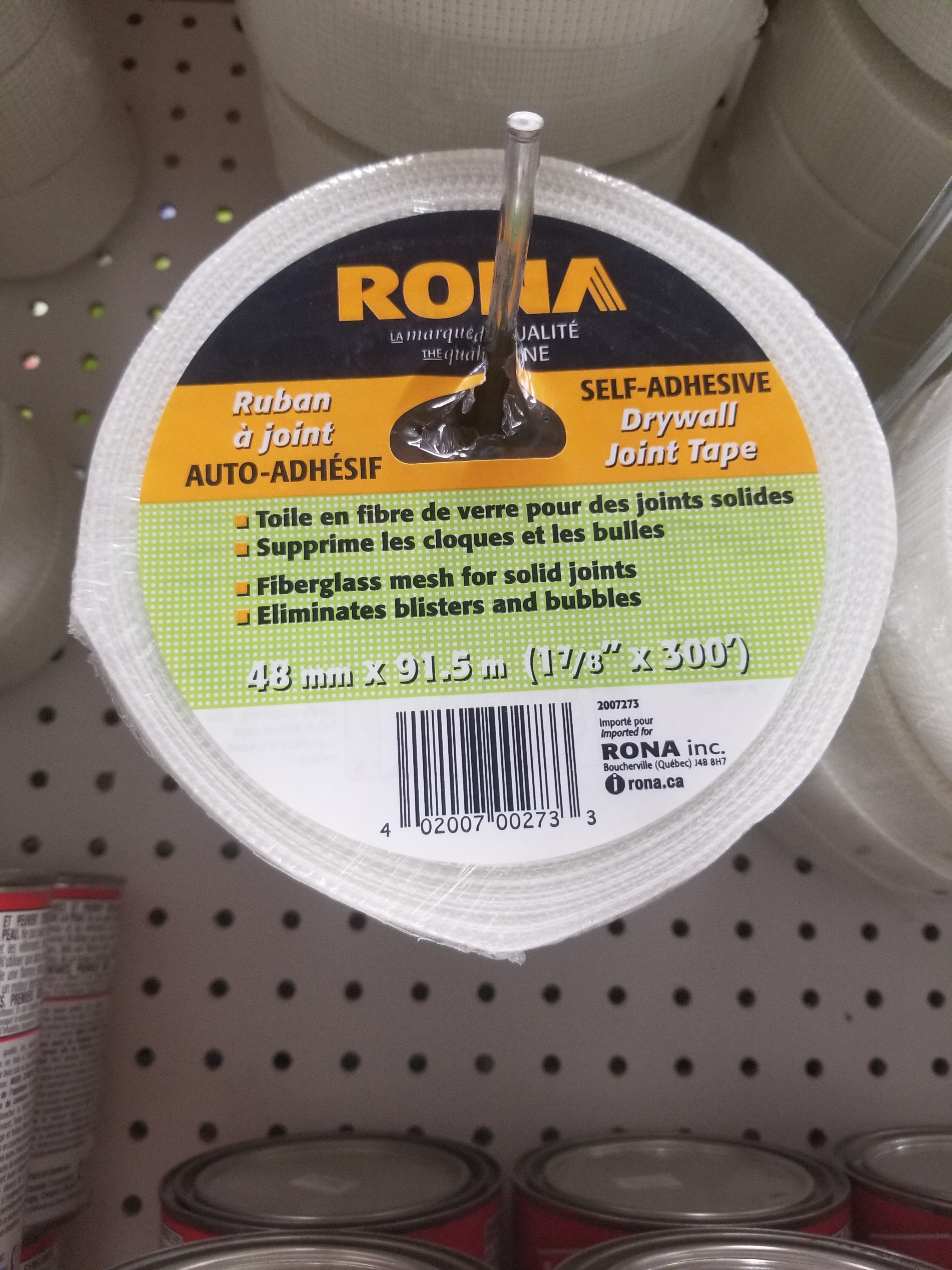

Would something like this be a feasible material for an enclosure?
That’s basically what is used as the base for fiberglass enclosures. This version just has adhesive on it.
Could I use this for the entirety of the enclosure?

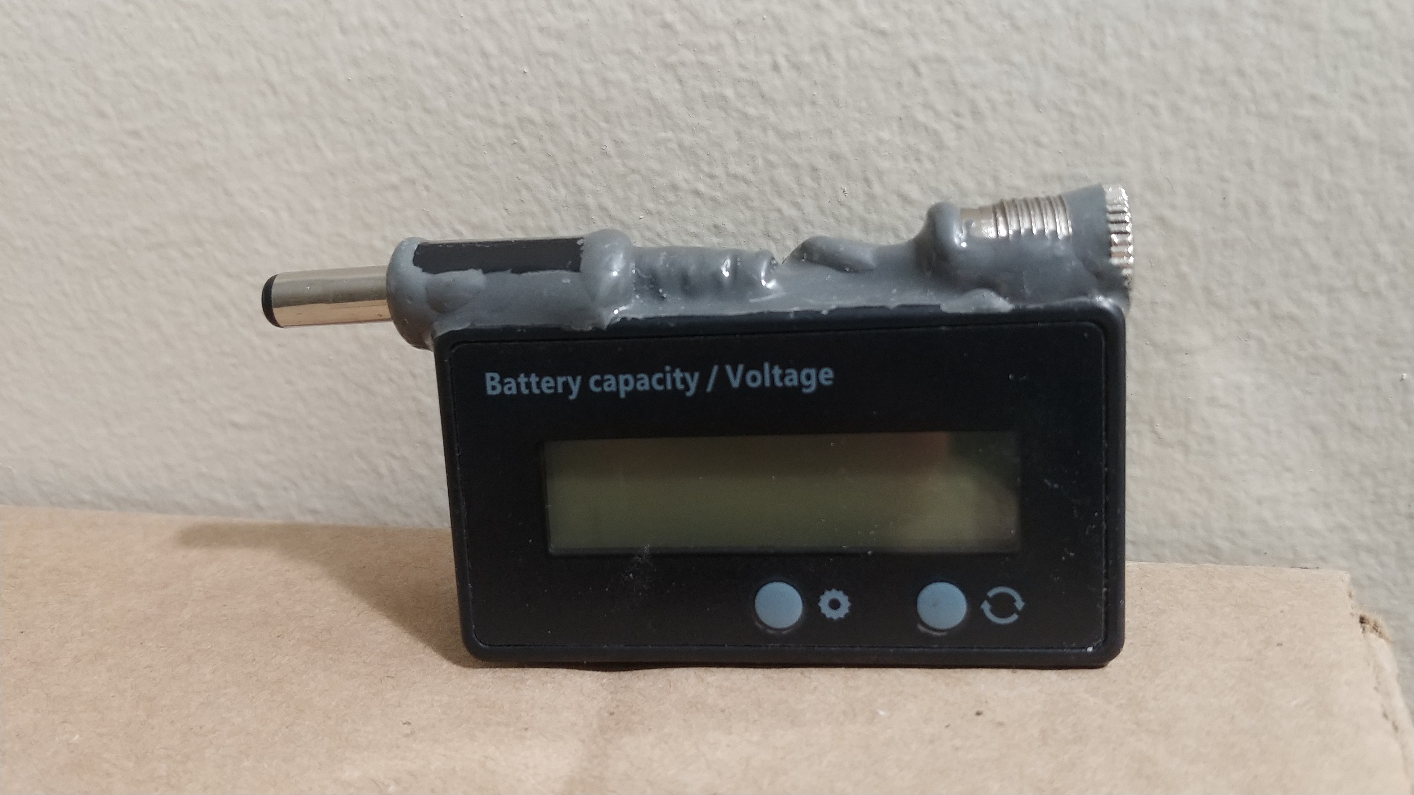

You can always just leave your loopkey in while it charges…
Or, @b264 has an inline voltmeter that he uses, basically got a charger socket on one side and a jack on the other, with the meter across it. I think it’s made entirely of JB weld XD
Nah it would need a bonding agent to keep the layers together and stiff.
Yes, there is.
Was thinking of using car repair epoxy for that…thought I didn’t need to mention :wink:

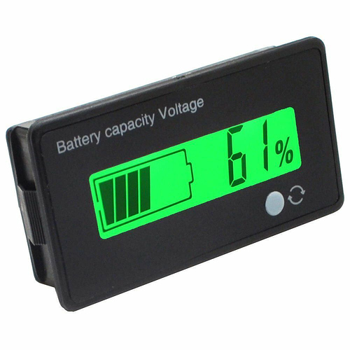

What battery meter are you using? This one?
Do you have an anti spark unit in there or just a loop key?
Man I like you a lot… I was really worried for you haha.
Ok we can move past this.
Yep, it is :wink:
I’d be worried for me too. My job would kill me otherwise. So I could buy a few of those rolls and not have to worry about sheets?
I think it would work well. The adhesive may even help it stay in shape better. Try and offset the grid pattern between layers.
You mean like criss-cross or overlayed slightly?
Also my only true concern is the glue itself…would it react with the epoxy
Overlayed. No clue on epoxy reactivity.

Try making a sample piece first, let it cure, wait another extra day, then try to break it.
That’s my suggestion.
But I’ve never used those parts in that way…
I can’t be the first to try this?? That’s just impossible
I’ve never heard of this before
Technically it’s fiberglass meshed tape… I like your thought process. Test for science!
