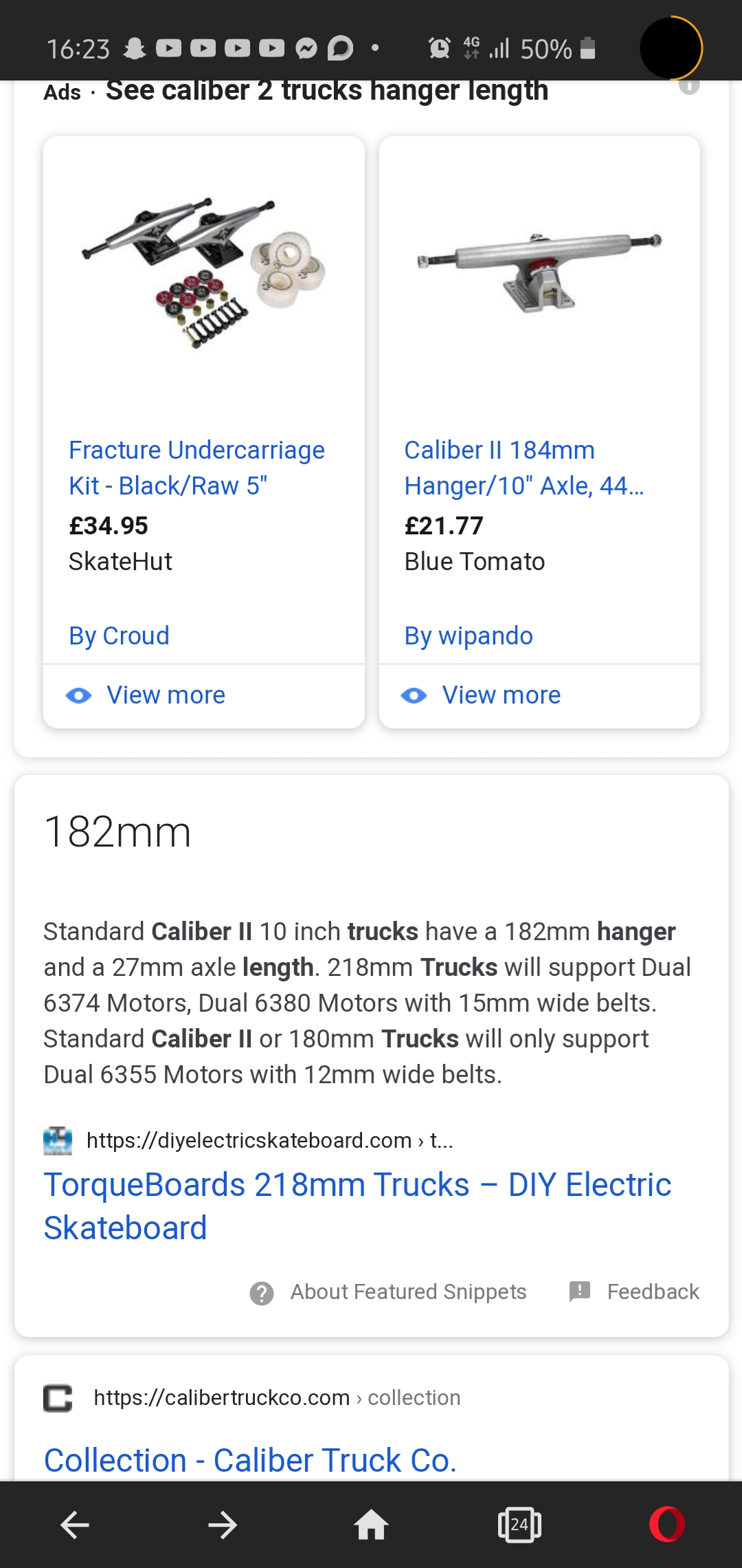

Do you think dual 6364 will fit a 180mm truck with mounting next to eachother, or will there be intersection probably ?
It depends on thr motor mounts really. Are they attached to the trucks? 6364 motors are 63 mm long from drive shaft to top of the can typically. Theoretically they would but but obviously the mounts won’t be at the very end of the trucks. Best to try and look at the trucks and mount and wheels and see how far apart you can get them without interference and do the maths really. Have you got photos of the tucks and mounts you’ll use?
I’ll use dickyho’s mounting kit with standard caliber II trucks 180mm.
No pictures because parts are being shipped :frowning:
Found that online.
Be weary of hangar length vs hanger + axel length. The axel being the skinny rod the wheels sit on.
Best to wait for the trucks to arrive and measure yourself I think.

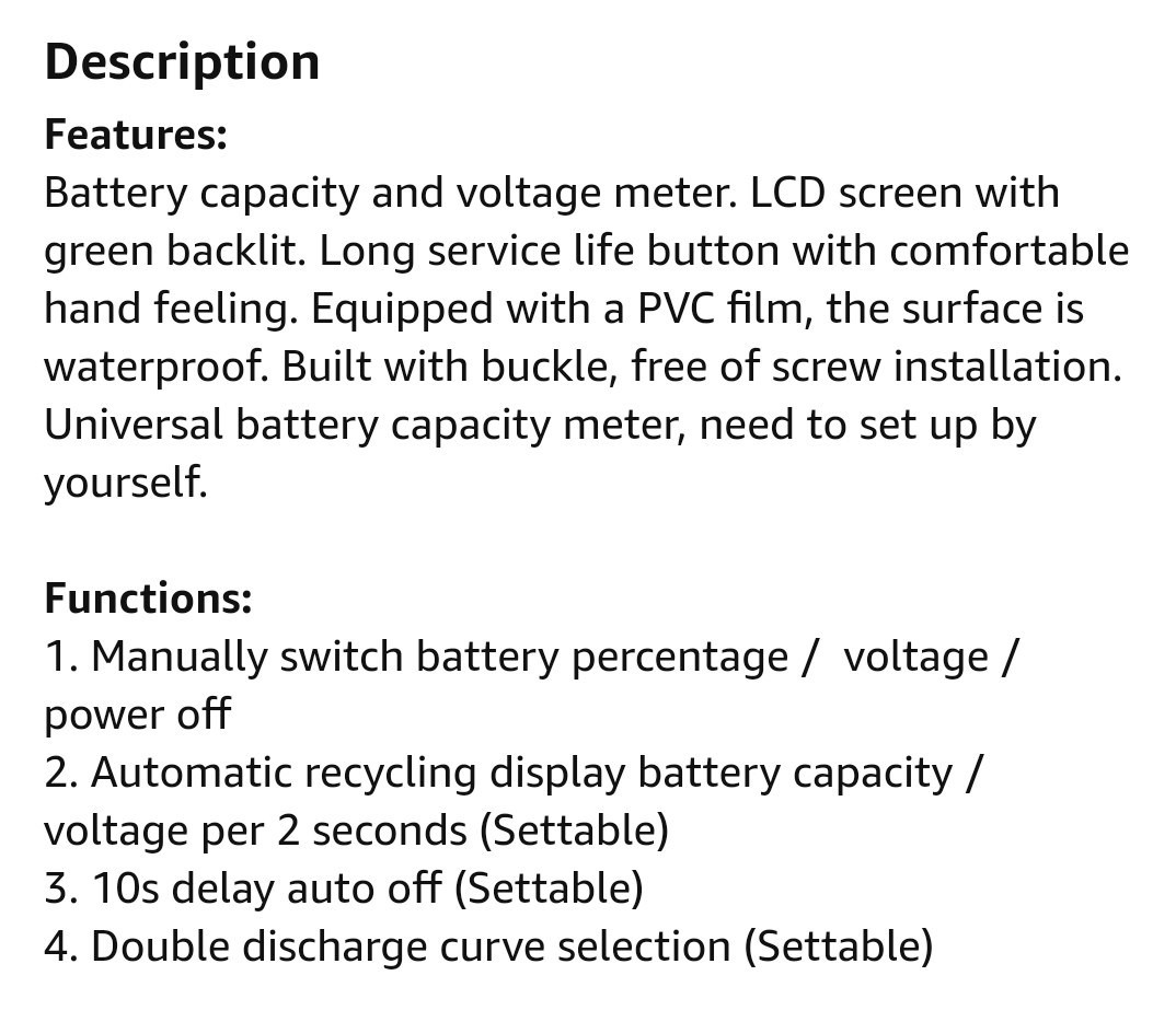

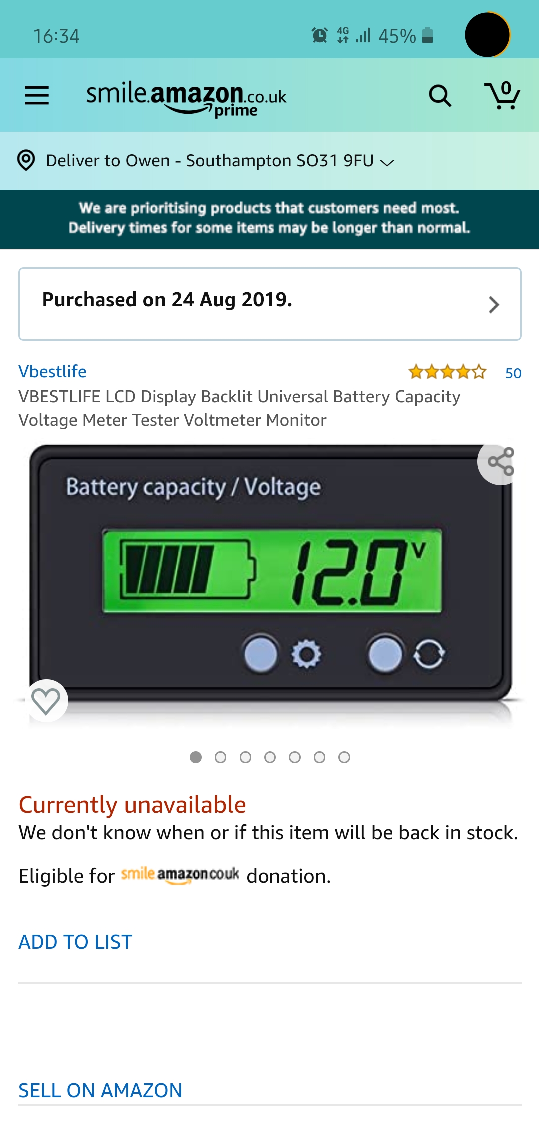

How can I get a LiPo battery meter that will display an accurate usable percentage of life left? All the ones I’ve seen and used basically I only ride down to 60-70 before I stop riding. Are there any solutions available that takes that into account?
That should be plenty of power. My dual 6354 setup was lethal, but I used a Hobyking ESC with no throttle ramping so squeese the trigger to the bottom and it would be send you right off the back, and I weigh 75. My motors were 260KV not 190 which is typically used so I had to gear it down to max out at about 26, which you can workout using the Esk8 calculator.
So you completely empty the battery and it says you have 60/70% left?
I used this
And when you set it up, it let’s you chose what voltage range you use so for me, 6s and your battery type. Then it’s reads the battery based on those. Before it would read based off a 10s setup so all readings were incorrect.
11mm belts and dual 6355 should fit depending on which motor and pulley you use.
If you use press fit pulleys or ones with integrated bearings you will need to modify the caliber hangers since the axle is too short to fit everything.
You can use a dremel and slice off a part of the hanger
Or then get an e-caliber truck (same as caliber II but with longer axle, no modification needed)
Mine will be using bolts, so no need of cutting the truck?
If only using bolts then it should work with the normal caliber II truck. You might have to file down the hanger a bit to get the pulley to fit properly but that’s pretty easy to do

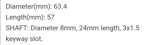

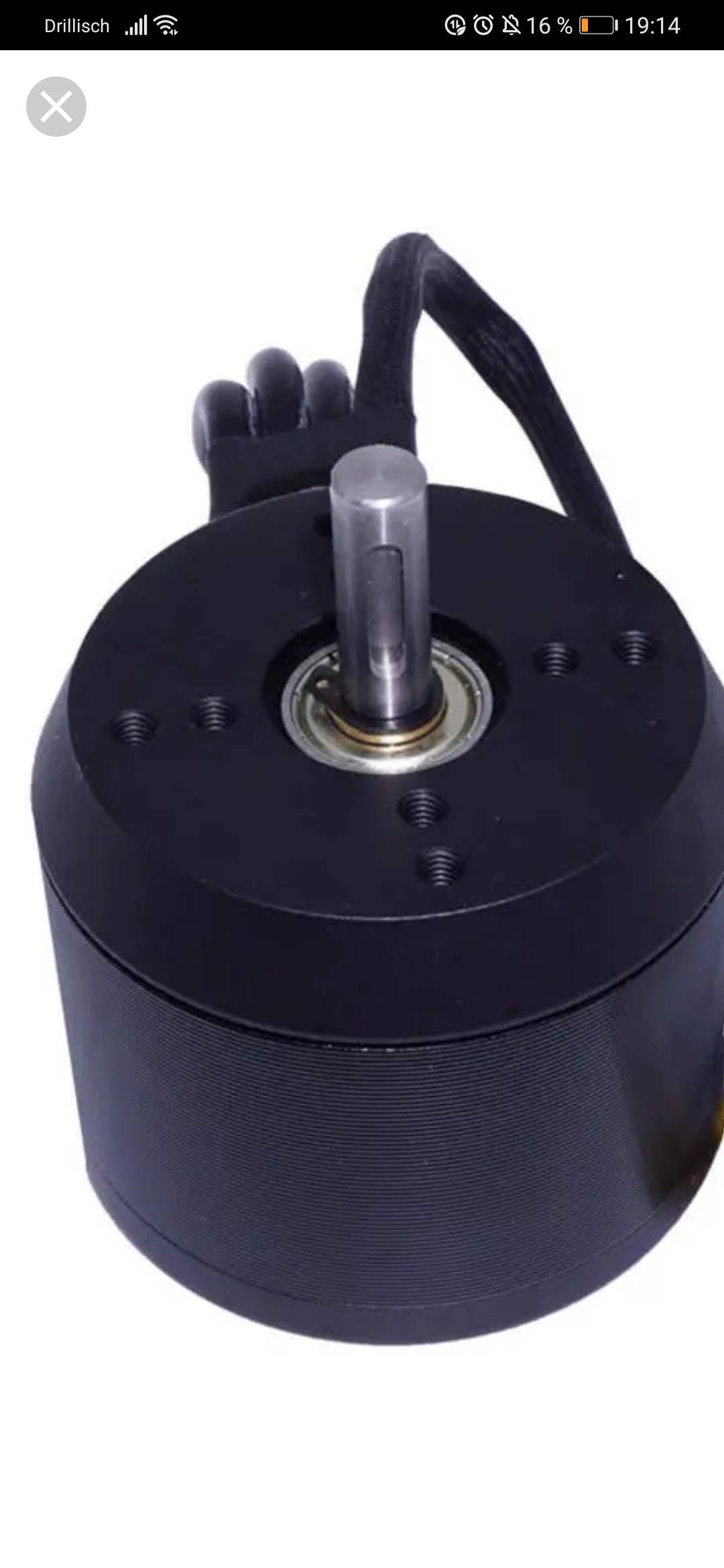

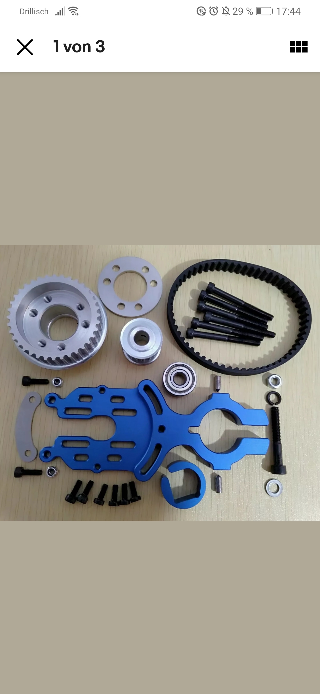

Since I want to build a dual motor setup now, and I already ordered a motor mount from dickyho (sadly with a 10mm bore, but now I need 8mm bore) does he offer / where can I get a matching motor pulley replacement with the correct bore width?
Should be 5M 15T for a 11mm belt
It’s kind of urgent so any help would be greatly appreciated!
Would this be okay?
Here’s the motor shaft specifications
It’s a d shaft one I suppose
