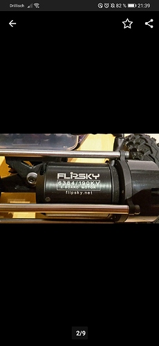

What’s the name of the motor pulley that fits this?
Is this worth it? 6384 motor. Don’t know if the flipsky motors are as bad as the VESC.
Price is 80€
What’s your oppinion:)?

You need to be more specific. What’s the diameter of the shaft? What’s the length of the shaft? What do you want to knoww baout it?
