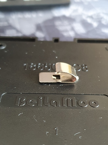

First, would a battery holder with clips like these be appropriate? They’re so stiff i need a screwdriver to pry the batteries out, they’re solid in there. Also, it’s going to be with the 30q batteries in 3p , nothing too crazy.
Secondly, what glues abs really well?
My go-to is to solvent weld it using Acetone slurry. Basically melt some ABS shavings in acetone to make goop, then use that as glue. Or you could just buy some ABS pipe cement from the hardware store.
