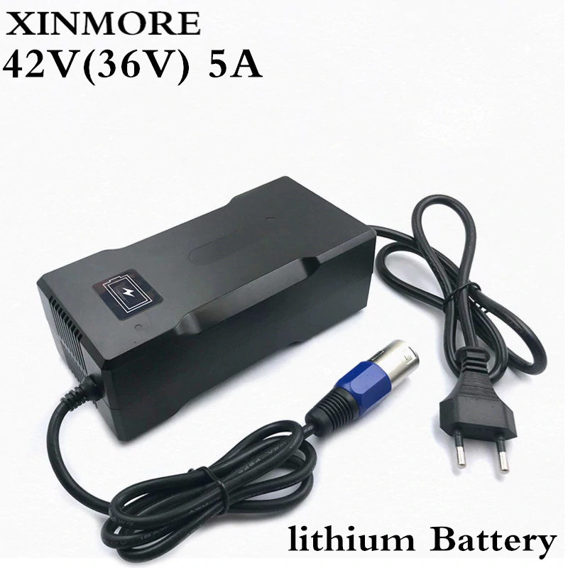

He also said 5A should be enough :slight_smile:
But I can’t find 5A chargers with 2,1mmx5,5mm DC Jack
Pick your poison friend
Details on plug choice in the description down the page
Buying something at a decent price with an integrated percentage indicator will be hard. Very easy to DIY tho.

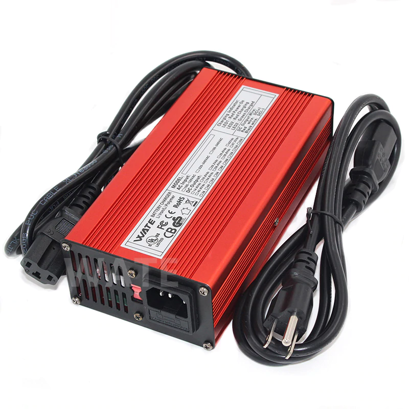

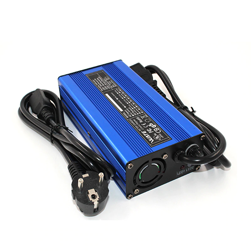

@Niklas i can vouch for YZpower so far. I have 10s 5A charger and 12s 7A. Works perfectly
I don’t have a Unity on hand to perform any rigorous tests on, but from all I’ve seen, it has pretty good thermal design.
That said, anything that physically small without an active fan will eventually overheat from even a couple percent losses at that power level.
Luckily, I think you’d be hard pressed to draw even half that maximum number continuously for too long riding on the street. Top speed just doesn’t take that much power, all the demand is in the acceleration.
Granted if you’re building a mountainboard and planning to do some serious shredding you might end up hitting the thermal limits quite a bit sooner.
If you’re purely keeping the charger at home - I’d recommend the metal enclosure. If you want to take it on the go or in a backpack, plastic housing is a bit lighter and less bulky.
Technically, the metal enclosure one is a bit better constructed and will have a longer lifespan than the plastic one (based on internals, obviously, not the housing itself) - but chances of that lifespan coming into play for esk8 use is questionable.
YZpower and Wate are highly reputable brands.
