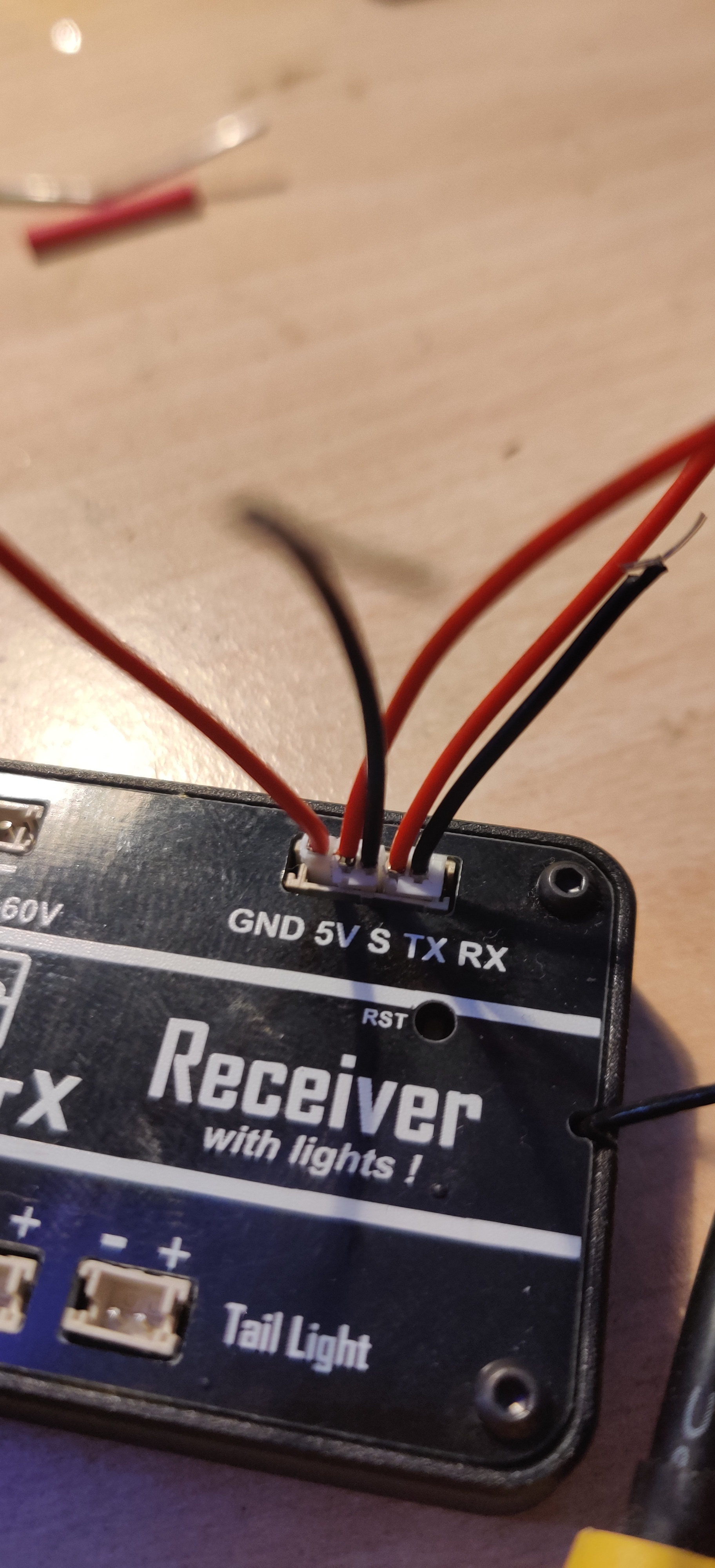

Aight, slightly stuck, hooking receiver to a flipsky 4.2
GND = -
Tx = tx
Rx = rx
5v = 5v
S = 3.3 or adc?
S is probably PWM out, goes to the white wire on the 3 pin connector along with vcc and gnd
Tx/Rx is uart out and goes to the masters Tx/Rx ports
Choose one or the other
@bollen could you expand a bit? I should not use all 5? The remote shows data, so I need uart?
If it gets the data from the vesc then go with uart and leave S unconnected.
If it gets data from the receiver (the VX1 does this, separate cable for battery voltage) then you can use PWM (S) and leave Tx and Rx unplugged.
5V to 5V, GND to GND for both scenarios.
Edit: @YUTW123 can probably tell you more about it
