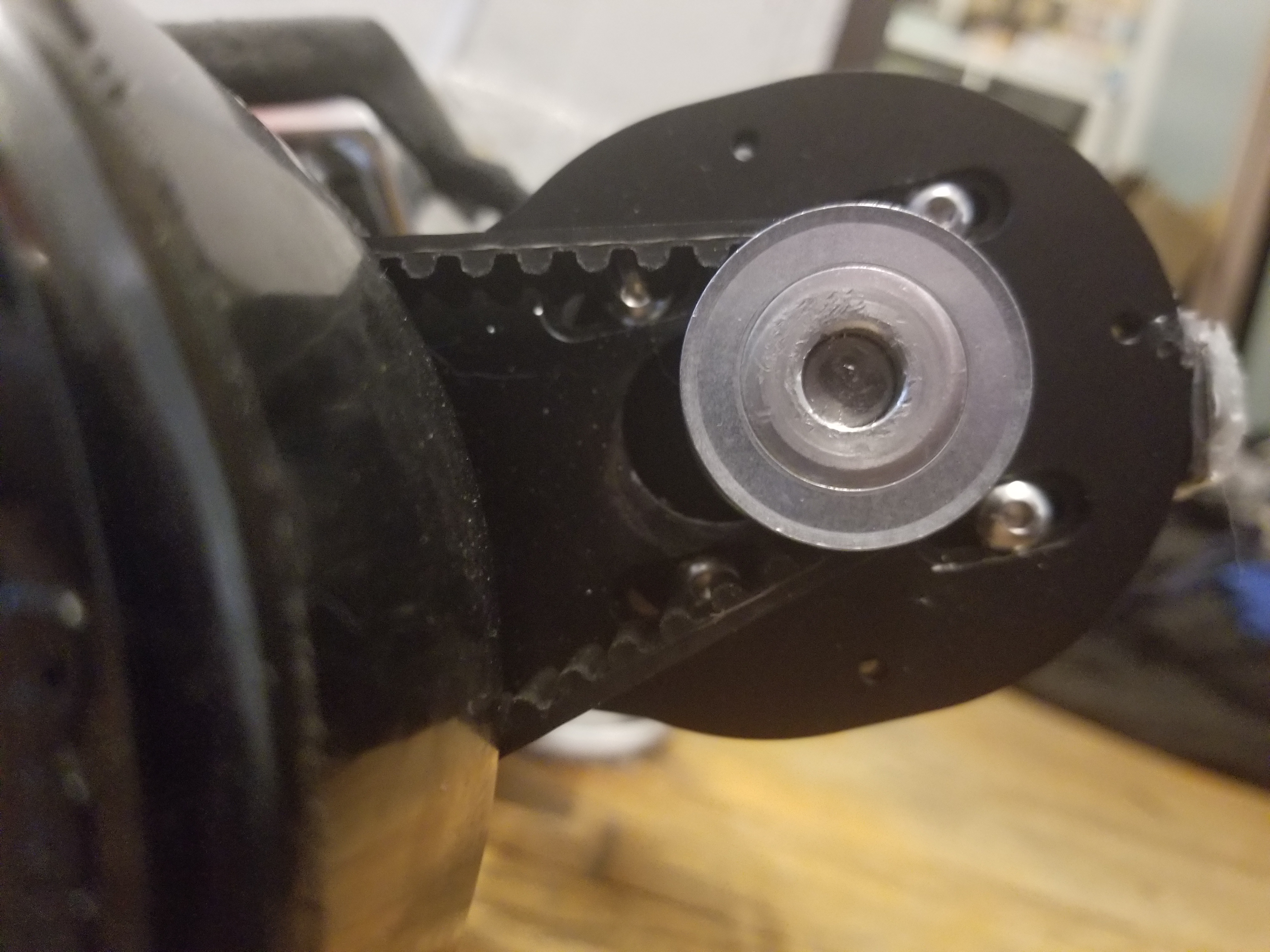

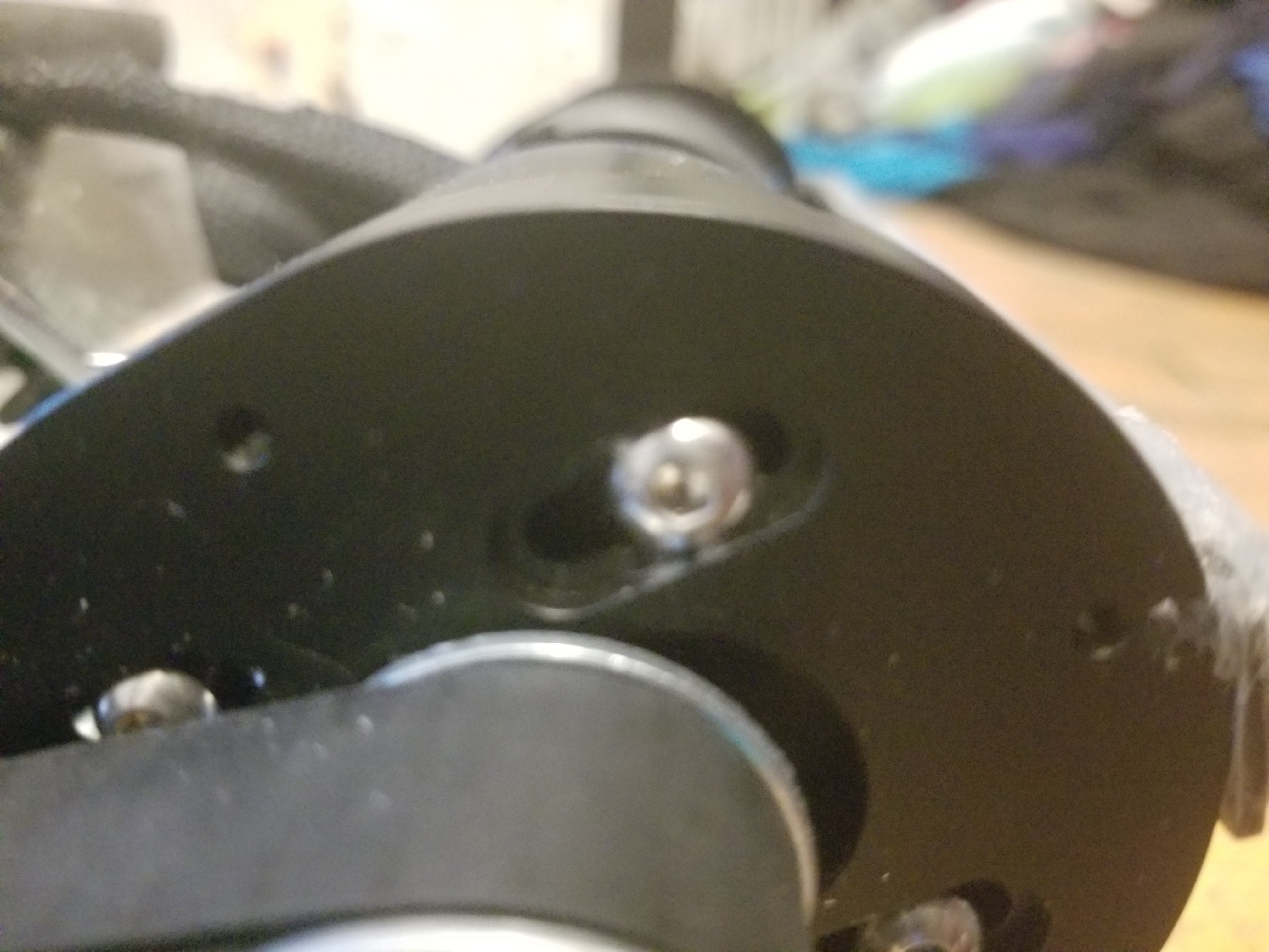

Oof, well there’s your problem - stainless hardware. Yes it’s pretty and won’t rust, but it’s much softer than alloy steel, and thus far more prone to breaking or stripping. Just switching to class 12.9 button head screws would help immensely.
Unfortunately low head socket cap screws are kind of a niche item, so Amazon doesn’t have any good options. You might try McMaster if you’re in the US, or Accu.co.uk in the UK.
I’m in neither XD I’m the cousin country (canada)
lol you’re on your own then XD
Another idea if you’re stuck with button head/stainless is to go with a torx drive rather than hex - FAR less likely to strip. I’ve never stripped a torx, but I have twisted the heads right off of torx screws before.
Looking on McMaster, the absolute best possible no-expense-spared option would be metric A286 high-strength stainless torx button-head screws. Nearly as strong as class 12.9, corrosion resistant, and torx for absolute strip-proof-ness. Unforunately they’re like $3.5 a piece.
