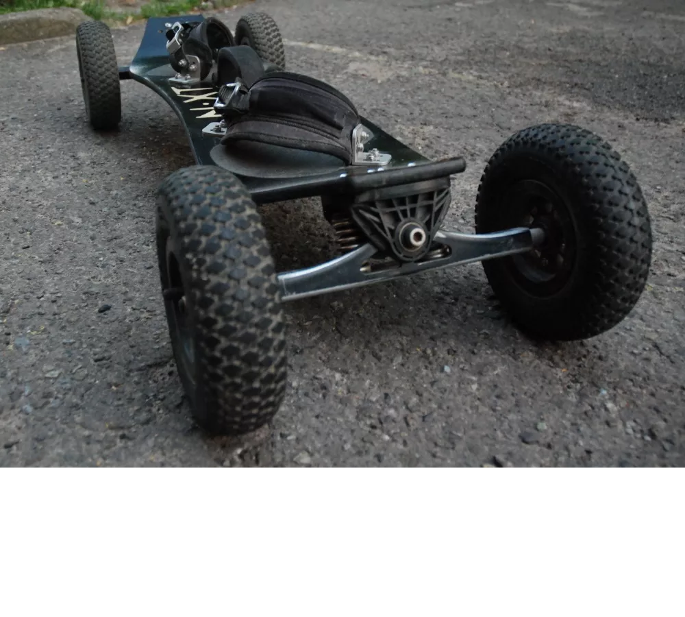

Just got some maytech 8x2 wheels with 10mm bearing but I am trying to use 8mm trucks
The bearings are larger then standard 8mm bearing so I cannot replace like that
Anyway I could use on 8mm axle or not really
Assuming the spacing between the bearings is workable, what I’d do is find/make/have someone else make some sleeves that have an 8mm id and 10mm OD. Pretty basic machining.
The other option is to make some spacers that adapt a 608 bearing to whatever size the bearing seats are. Also pretty basic machining.
Of course, another option is to just buy some trucks with 10mm axles…

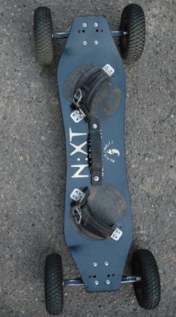

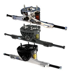

What do you think about make it electric? Do you have any experience with Next-boarding trucks?
its really cheap

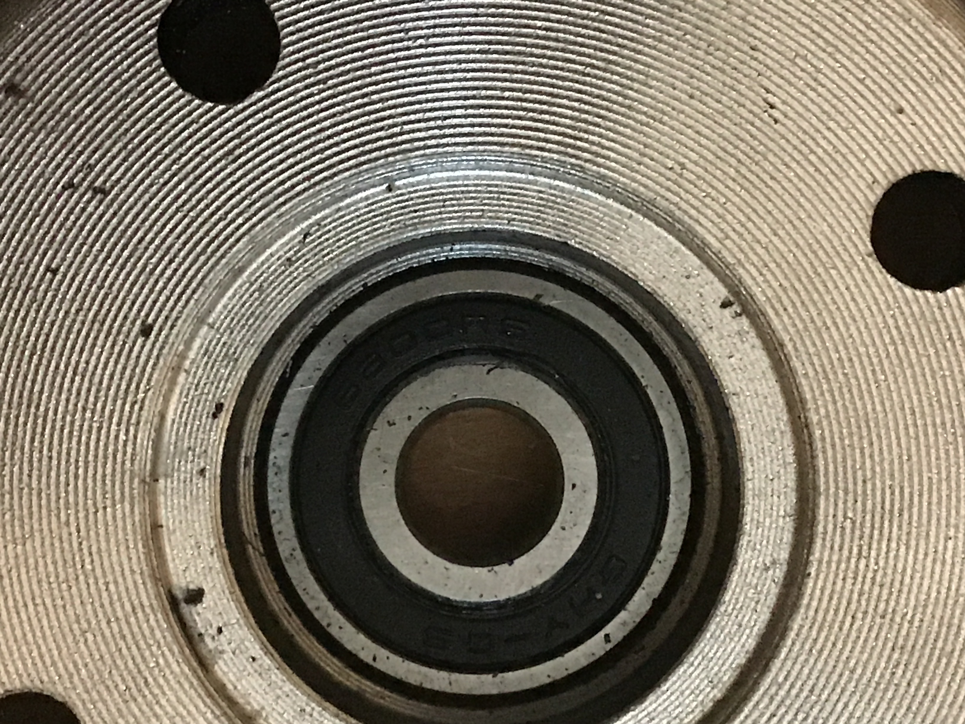

Wouldn’t it be simpler to just find the right size bearings? @Halbj613 do the 10mm ID bearings have a number of the side?

Yeah will check now
If anyone can read it
Checked another bearing which I think says 6200RS

Those look like the old matrix 1 trucks or a knock off.
unnamed
@MBS can probably tell you if they aren’t
If they are mbs, you can swap that nylon top piece with an all metal one. The nylon ones have seen some cracks.
I don’t recognize the wheel hubs though. Does it say in the description? My polish is no good.
Well if you look up a 6200 bearings dimensions they are 10mm x 9mm x 30mm. Which means you are after a 8mm x 9mm x 30mm bearing, 2mm thicker than your current ones, but you can’t fill that space with a ball bearing without increasing the width of the bearing right? Because the balls are spheres. So assuming it existed, which I don’t think it does, the only size of bearing that would work would be 8 X 11 X 30. 2mm too wide.
