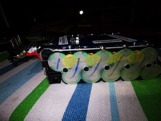

Is it worth upgrading my Loaded x Umlimited solo kit from a 10s1p 25r to 10s1p of
  • p26a
  • 30q
  • nah don’t bother
0 voters
I think it’s only worth if you go 40T or even 2p
bigger than 18650 and 10s1p won’t fit. the upgrade is quite simple
bd7d6766733f69068c01367c90e1923852abcadd_2_666x500 e5b3e447271b06834d03396d27d4501ed4557bba_2_666x500
i agree though it is still quite some work for a small amount of extra range
Is 20% extra worth the work? I doubt so. Better make a custom battery back. Or make em swappable
