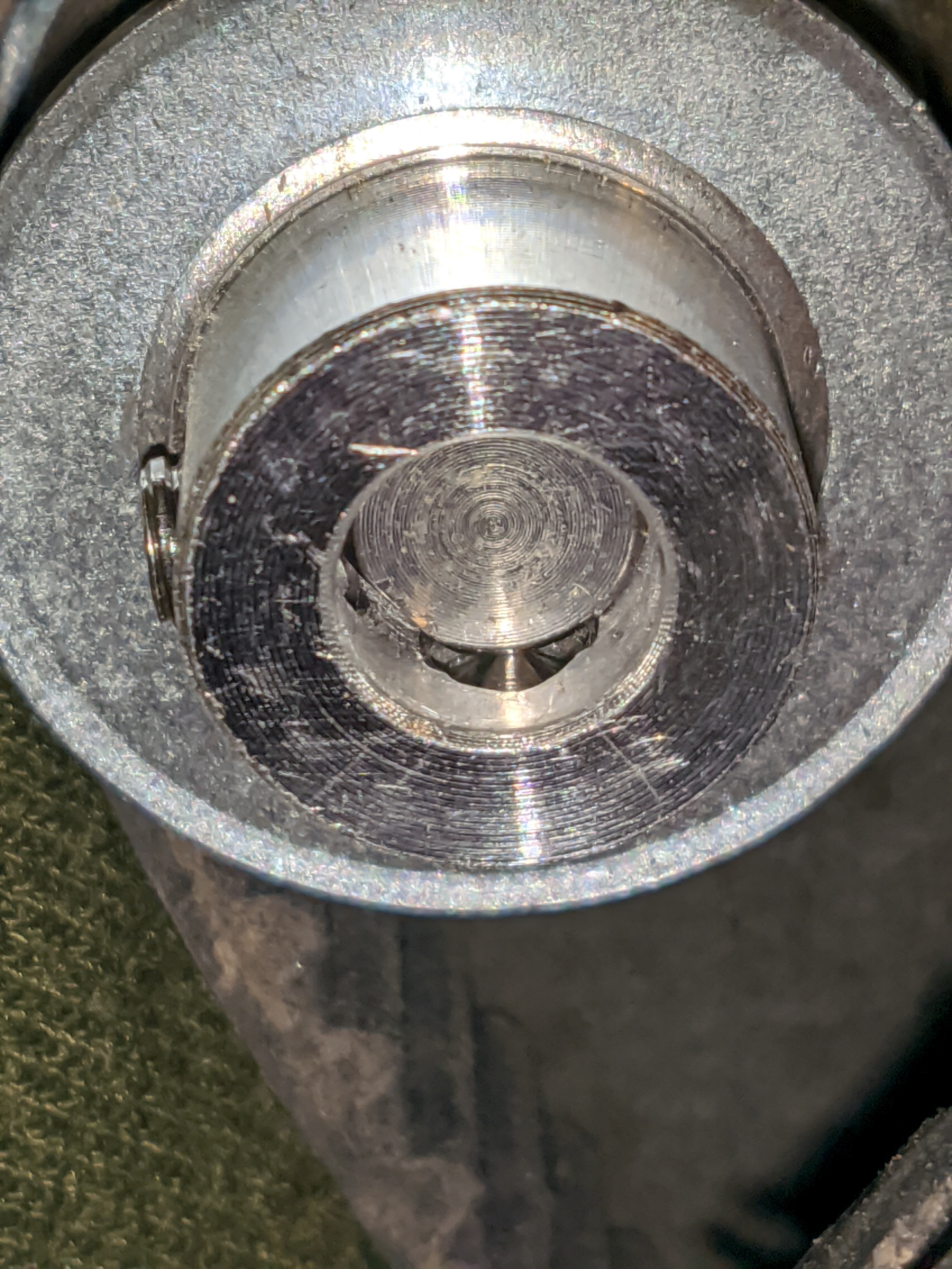

I have gone well over 1000km on one set of belts, are you sure they are the right length?

Yes. I used the belts that came with my mounts, ran a short version without idler. All good until i changed to those motor pulleys. My first belt broke after 1300km on the old pulley. Now 3 broke after not even 150km with the new ones.
Brand new belt after 200m
Pulleys teeth pattern maybe mislabelled? I had a ‘HTD5M’ pulley that was really a GT3 pulley and it ate up a whole bunch of my belts. That looks like tension damage but I don’t understand how after 200m…
Edit try cleaning up the pulley with steel wool to make sure there arent burs cutting into the belt.
The seller said it’s htd5m and i trust that.

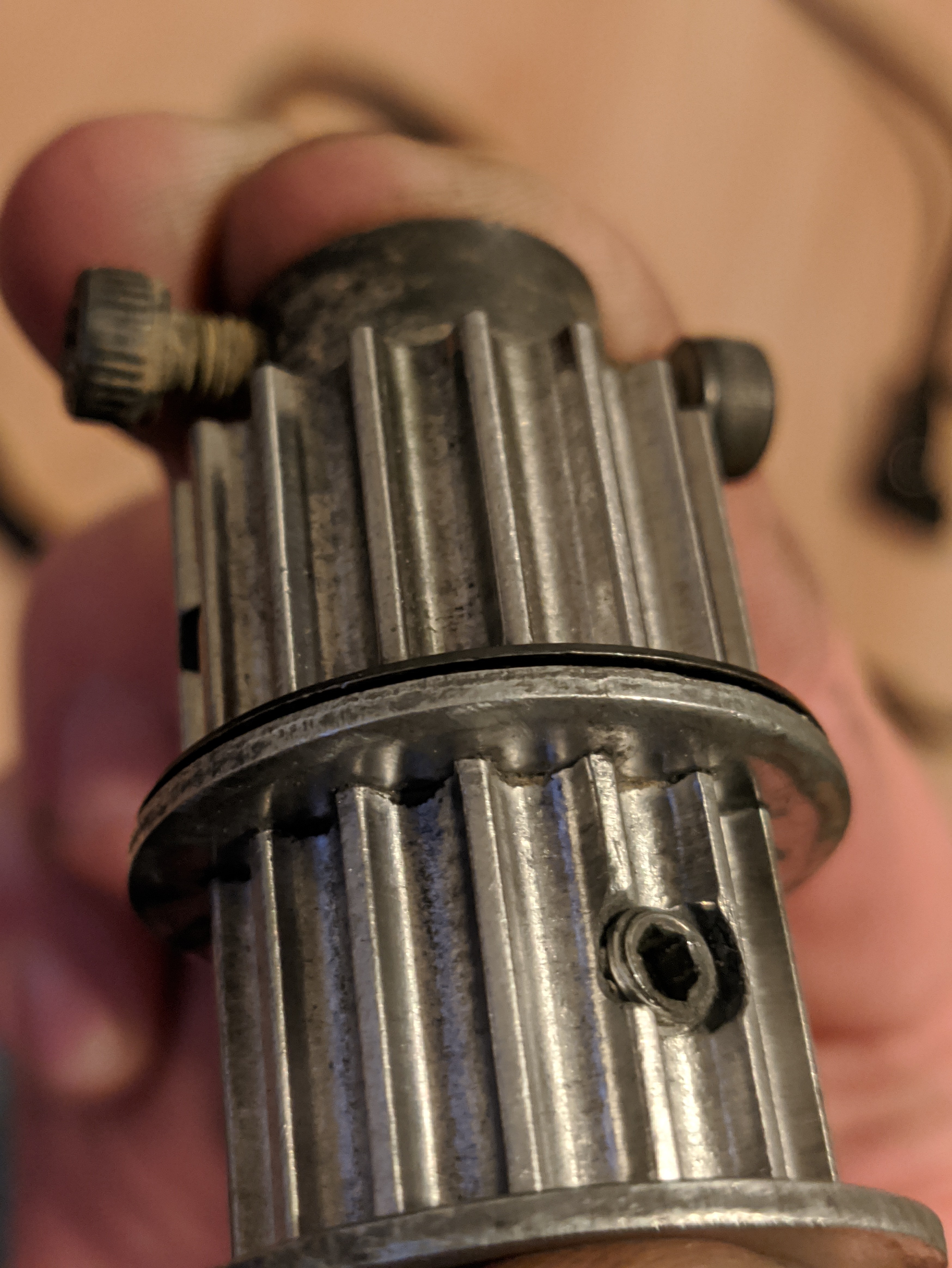

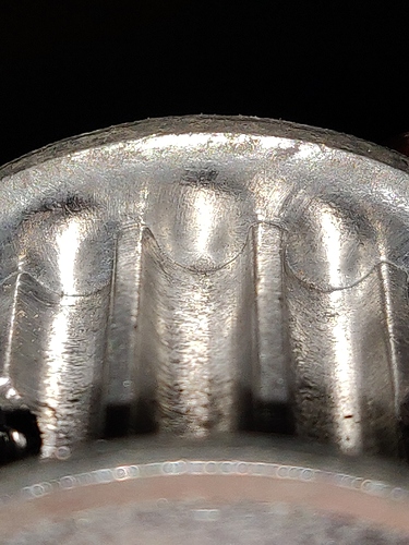

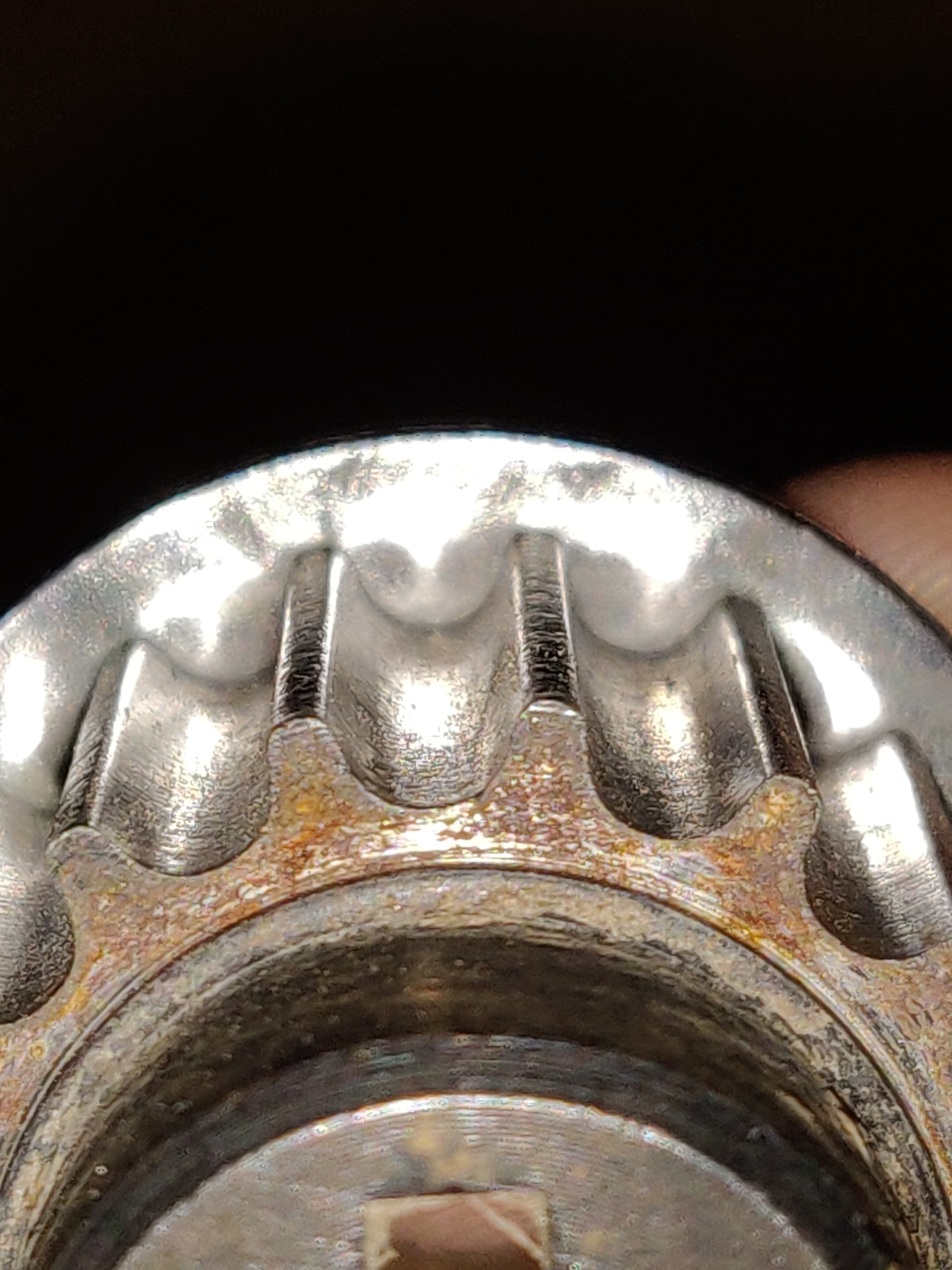

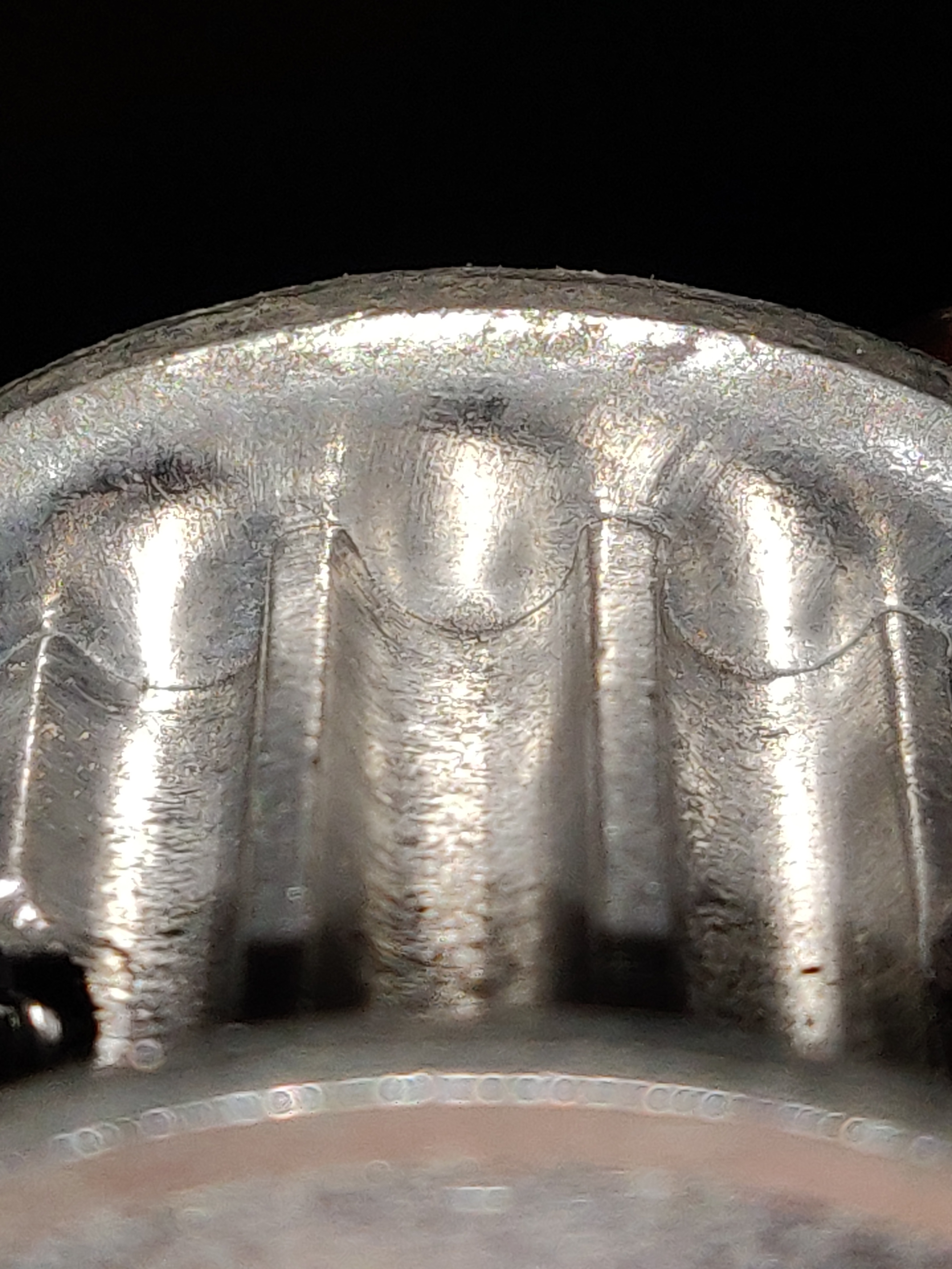

Here are some pics.
This is my old one :
And this the new one
Pulleys ares clean and the tension wasn’t hard, it had some “slack”

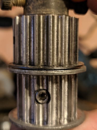

The one thing i noticed is that the new 15t pulleys is smaller than my old one. With that installed i had to readjust the tension
They look fine yeah I really don’t know, sorry man.
Tbis is what i mean with smaller.
Top pulley is the old one, bottom new.
They are aligned on the first picture.
If i look at the back of them without moving they are misaligned even though both are 15t
Sand the edges of the set screw hole a bit, they might be sharp and cause permature wear.
Already did that as good as i get it :see_no_evil:
Its not like that i don’t try everything before asking. :sweat_smile:
and i don’t think this is a good mounting position for the other pulley i have laying around
the @torqueboards pulleys have the edge here, because you never have to worry about the grub screw (or the edge of the threaded hole) eating into the belt. sucks that your motor shaft isn’t long enough for a good fit
This! Thats the reason i’m looking for them again.
i have these but they are too long for my shaft
only disadvantage is that i seem to have squeaky/whiney belts with them kf they are not wet or have antitranspirant on them.
