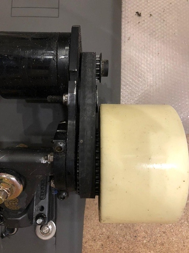

Then definitely buy a 12mm motor pulley, your belts gonna wander all over the country with that extra 3mm of variance.
Can always shave the wheel with a file to give belt more clearance but lose some contact patch.

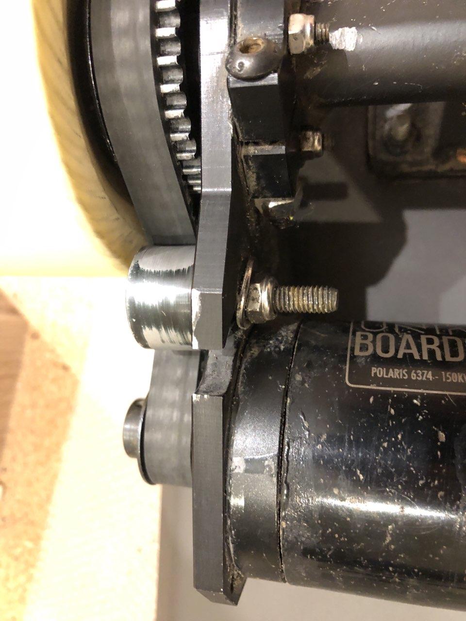

Use the motor pulley flange as a belt guide. If you have room to space the motor so it sits further away, or move that motor pulley inboard so the flange on the pulley holds the belt away from wheel.
I’m beginning to think that the real problem is that the wheel pulley doesn’t have a flange, and that if it did, I could run whatever size belt and not worry about it touching the wheel.
Like, what I could do now is yeah, move the motor pulley and have there be an even larger gap between the wheel pulley and motor mount, but then I’m stuck with 12mm belts forever.

Update – turns out the washer I was using to hold the idler in place bent during usage; so even after putting the belt back in place, it gets stuck pretty much instantly:
I looked up @Boardnamics new mounts, and they have a new groove that the nut sits in
photo_2020-02-08_19-15-31
So that’s why mine is so awkard. Will try omitting the washer / buying a steel one that’s still small enough to fit next to the motor, but yes – this is definitely what’s causing the problem :laughing:
I wouldn’t focus on the tensioner, it does exactly that, tension. The sides of the pulleys should be what keeps it off the wheel
You are correct. I bought a new pulley anyway.

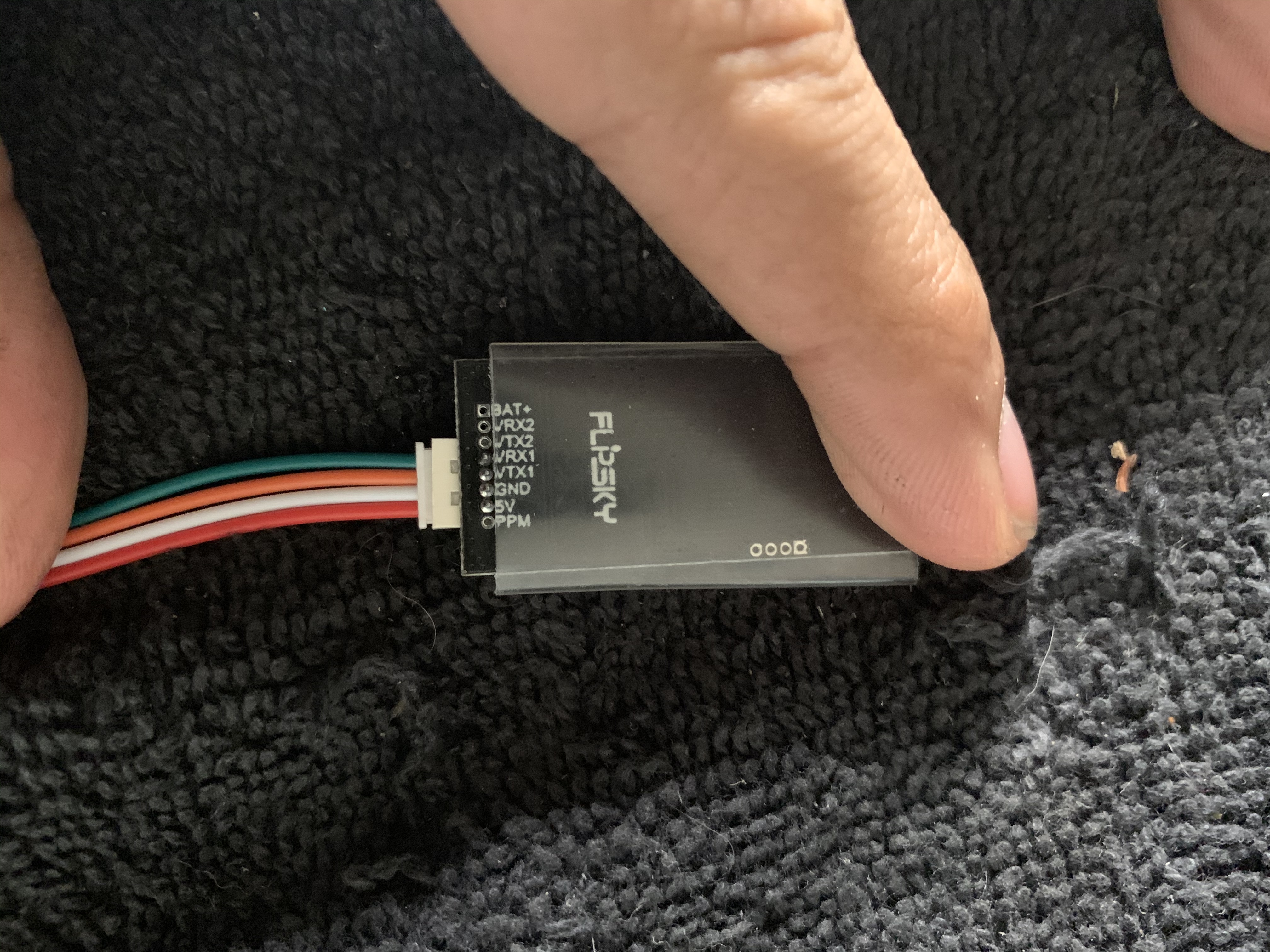

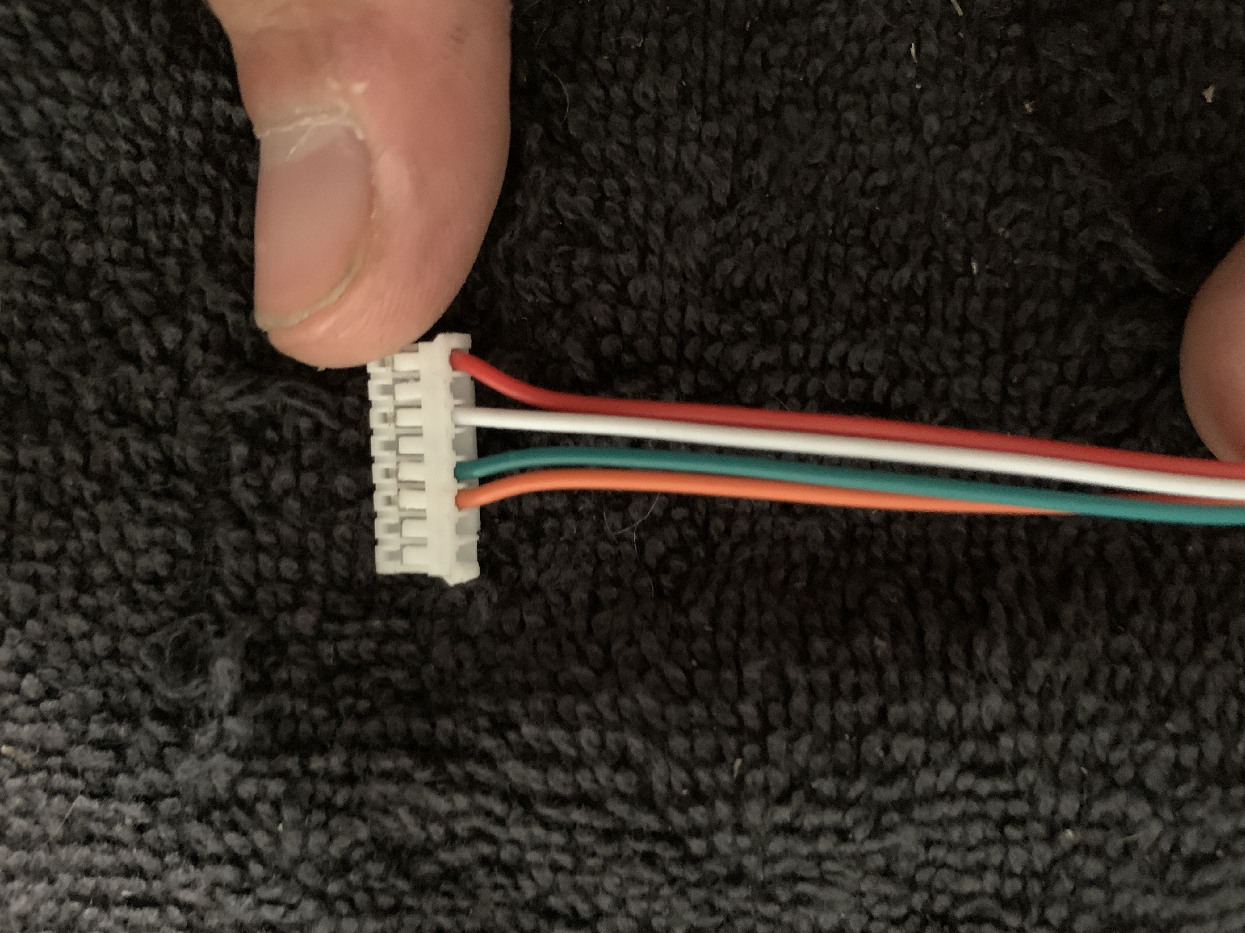

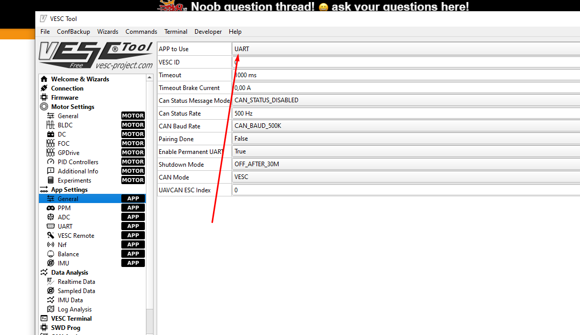

Hey guys back for more help… The vx2 pro remote it seems only has UART and no ppm. Unfortunately when I try to get it set up it pairs fine but for some reason there is not connection? (Idk if that makes sense, like no throttle but it says it’s connected). Below are a few images of the receiver and pin setup and the VESC it’s going into. Idk if it’s worth mentioning I’m using ackmaniac tool as opposed to the VESC not sure if that has
An effect on it. Thanks again for the help.
Means your remote paired with receiver but you need to set up your vesc to control via uart
As @BluPenguin said, go through the Input wizard and you’ll be good.
I set the master app
To use VESC and the slave to use no APP. And also Set can forward. I’ll double check tho. Thanks guys.
