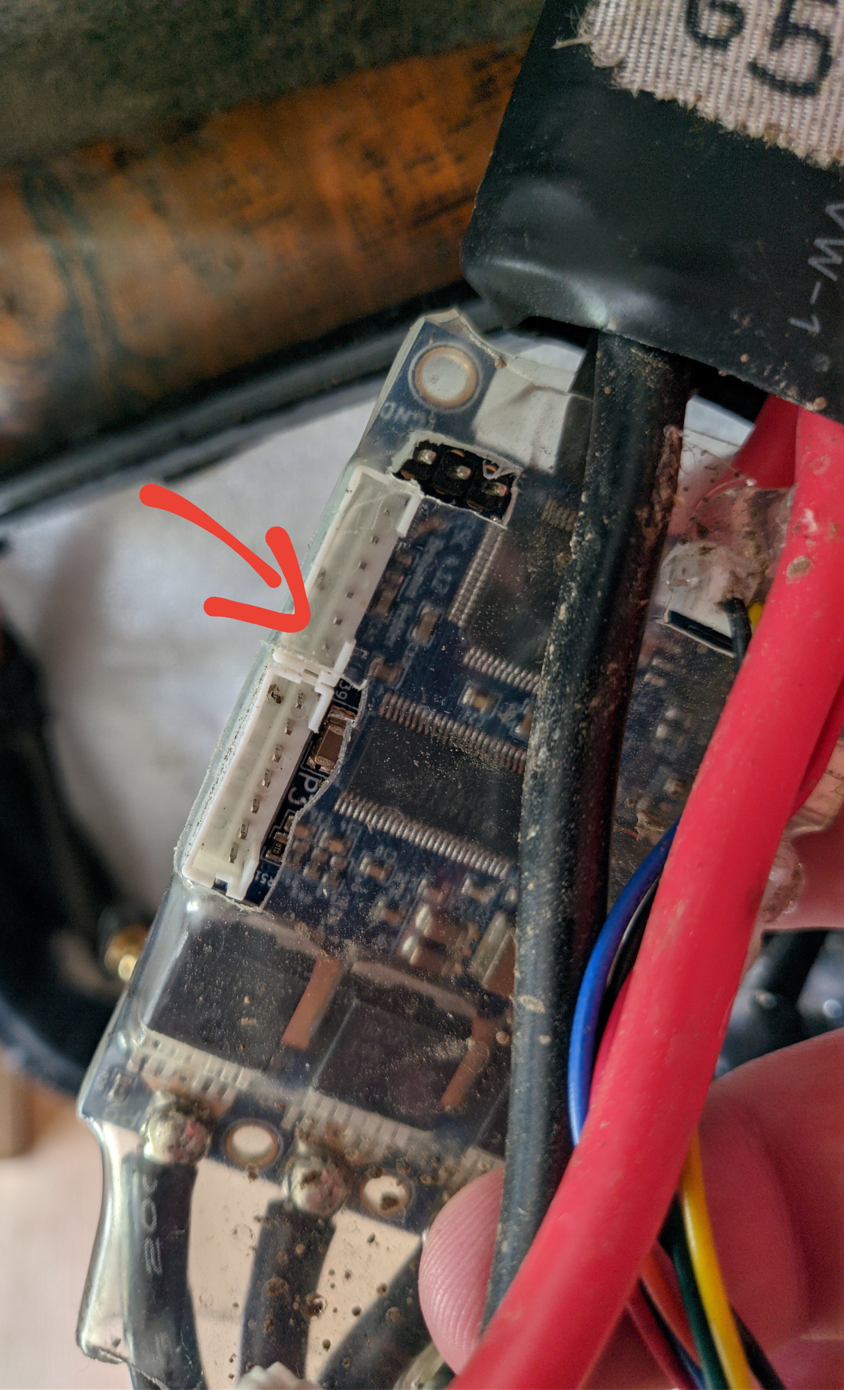

Does the standard 4.12 vesc even have the swd port?
Edit : is it the long plug above the uart connector?

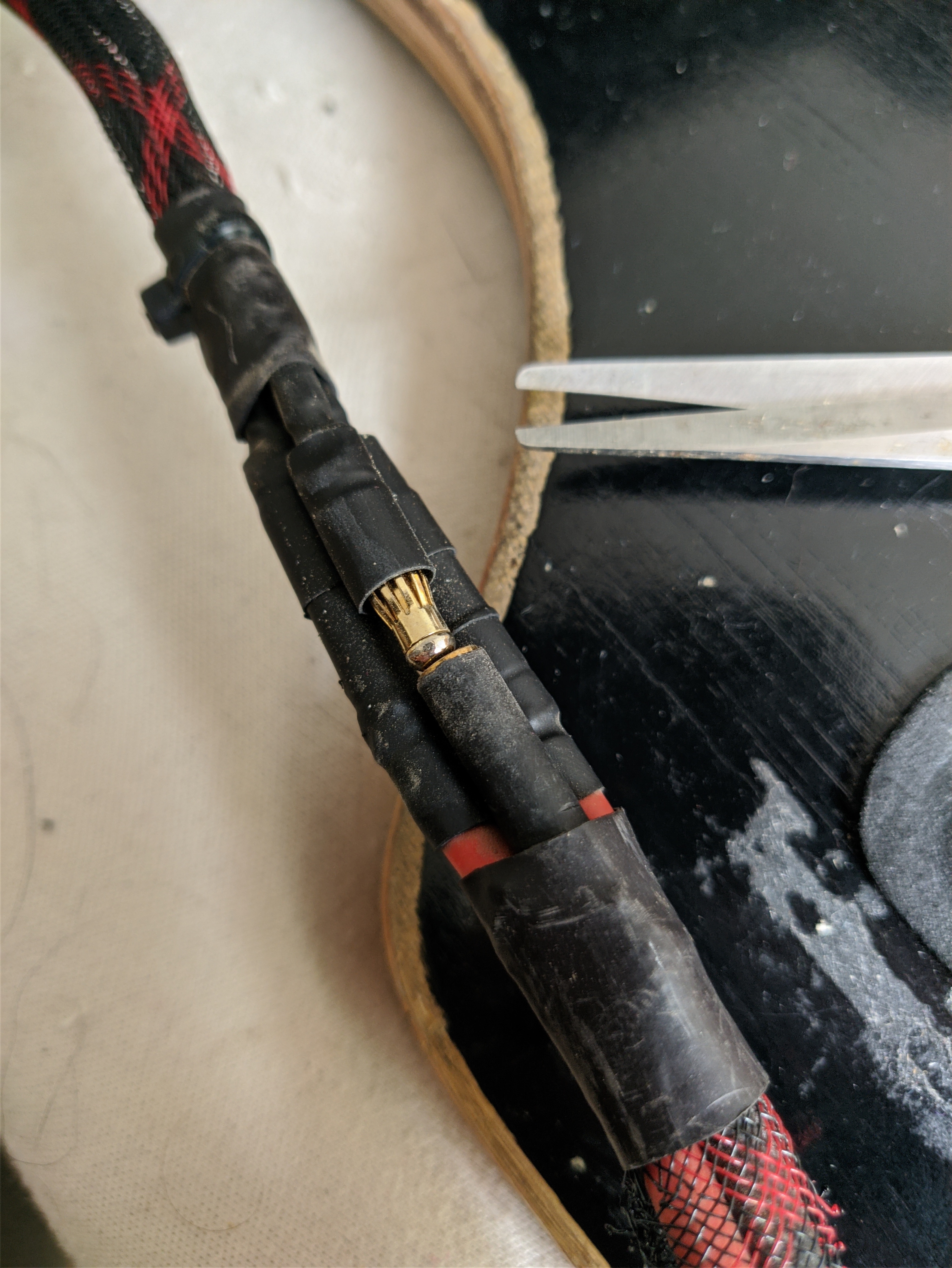

As @MysticalDork said, just out it back in
If you want post a picture of the connector on the PCB, some have a matching that you have to release first, be careful, they are really fragile
yes i tried it once 2 years ago and bent the fk out of it and then had to send it to repairs because my knowlewdge at that time was poor with electronics. That is why i asked, to avoid making another mistake :stuck_out_tongue_winking_eye:
Can i use twezzers? the pcb is very out of reach within a cylinder :roll_eyes:

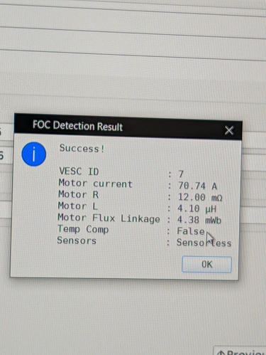

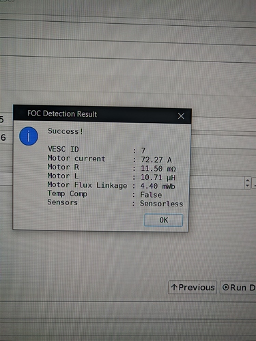

What could be the cause for this big difference?
Same motor, same vesc. Top one was the first run, bottom second.
Also the second run had a pretty loud and scratchy sounding detection compared to the usual for deeper sound.

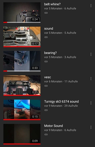

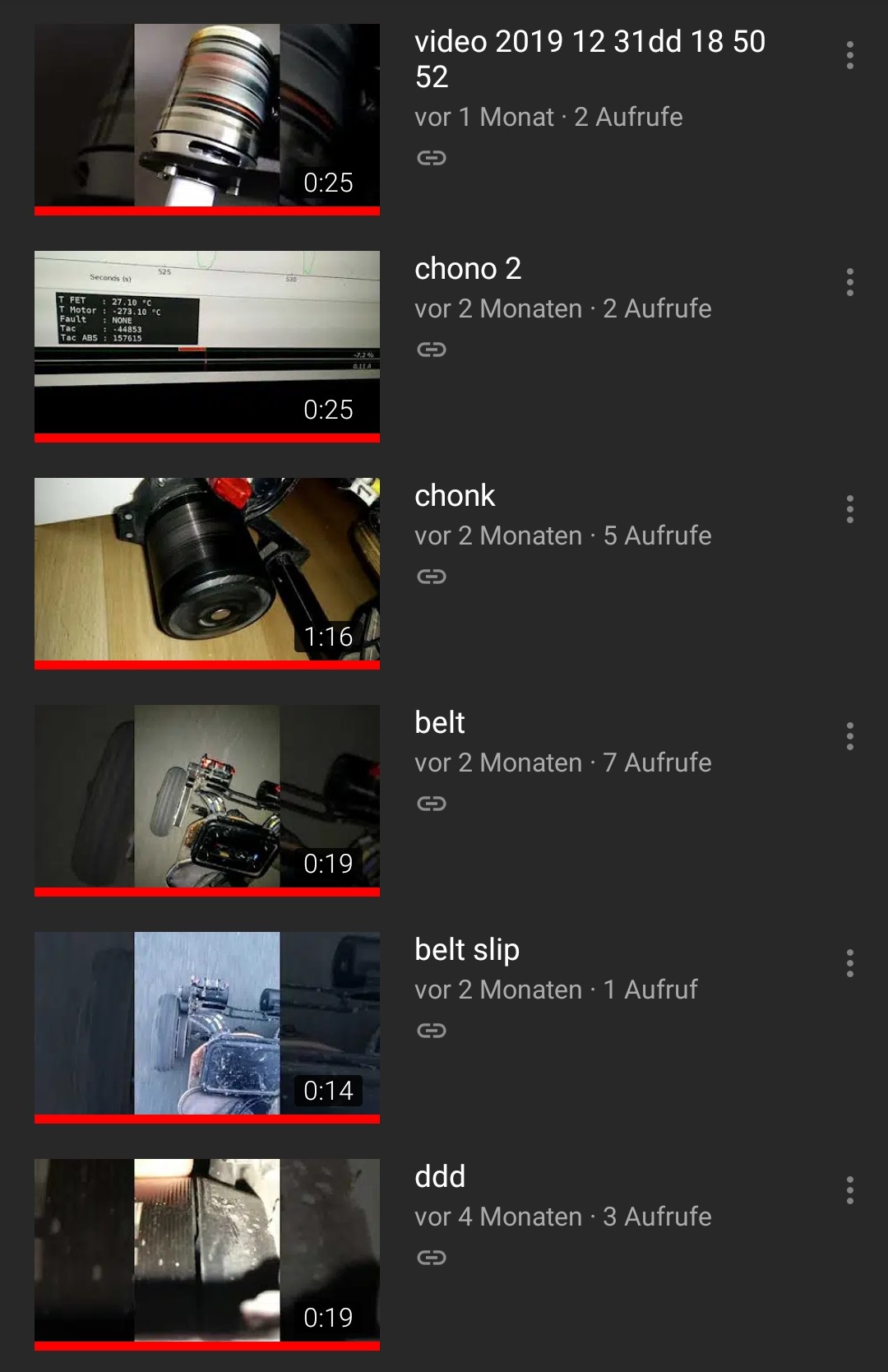

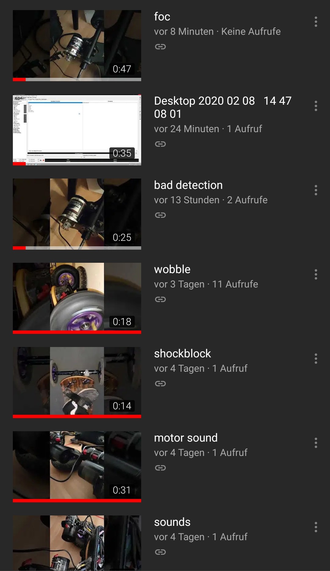

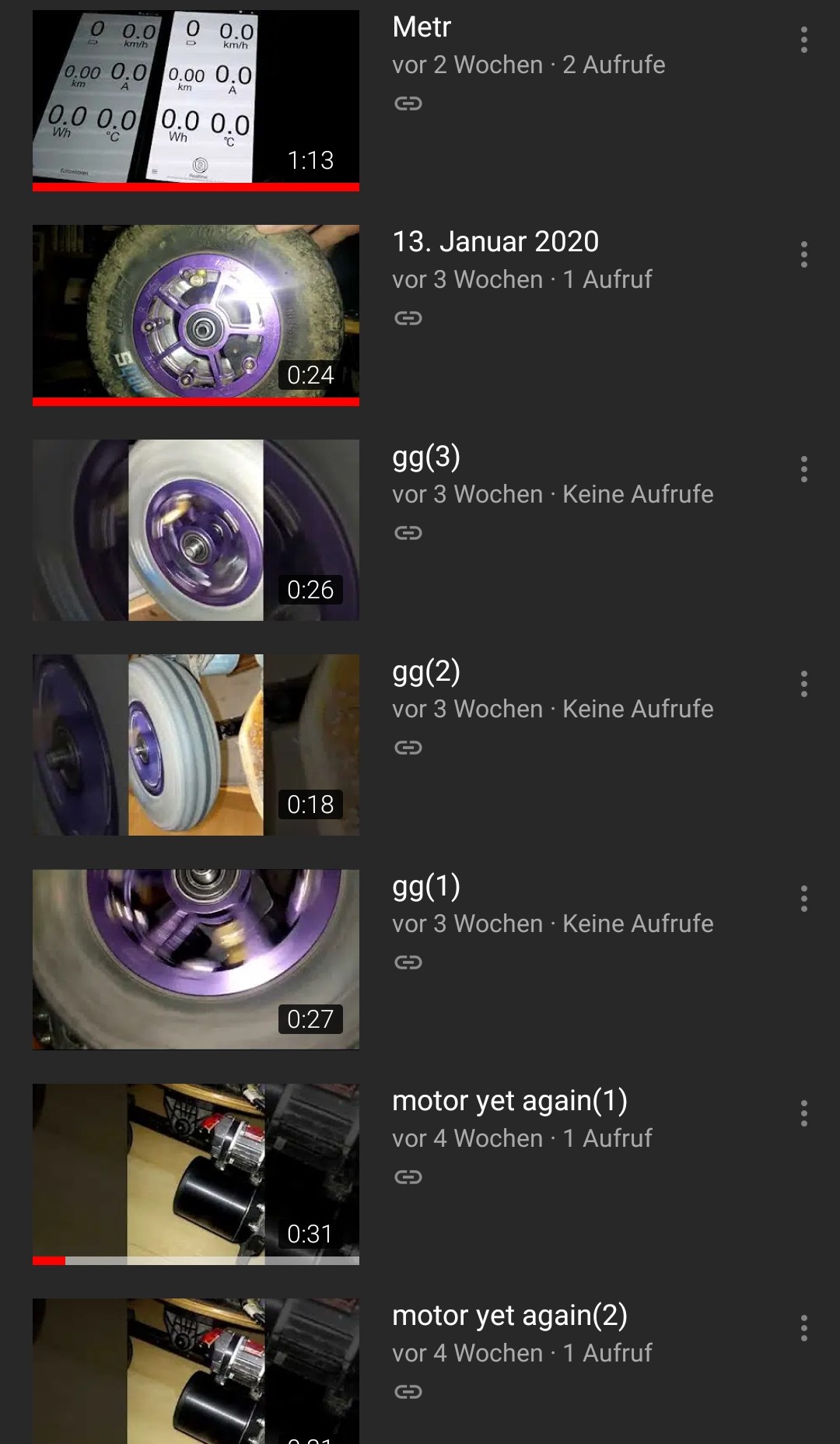

i don’t understand why i always have problems with my hardware. Just look at the videos i’ve uploaded to showcase it.

Just because you document your problems doesn’t mean you’re the only one who has them :smiley: I think everyone deals with hardware/mechanical issues and strangeness with the variety of VESCs available so you aren’t alone but the videos are good if you update description or comments point to an answer can use them to help others with similar problems.
Regarding the uH value discrepancy… No idea. If there was something metal or magnetic near the motor when it was running the values could be quite a bit off but honestly would need to dig into the code to see where these values are used and how much that change would “weigh” in the equation.

All videos are unlisted and most don’t even have a solution.
Nothing really, just my pc but the first reading was on the same position. (Maybe the first one was via the ACK fw and the second one stock, but thats just a guess)

Yah with different versions of the firmware perhaps there was a bugfix somewhere along the way that changed the values but it could have also been environmental or other changes to setup that effect the value if done at different times. Sorry haven’t yet tried bumping anything to try HFI out yet, have the extra hardware sitting around though will give it a shot if will run on 4.x hardware

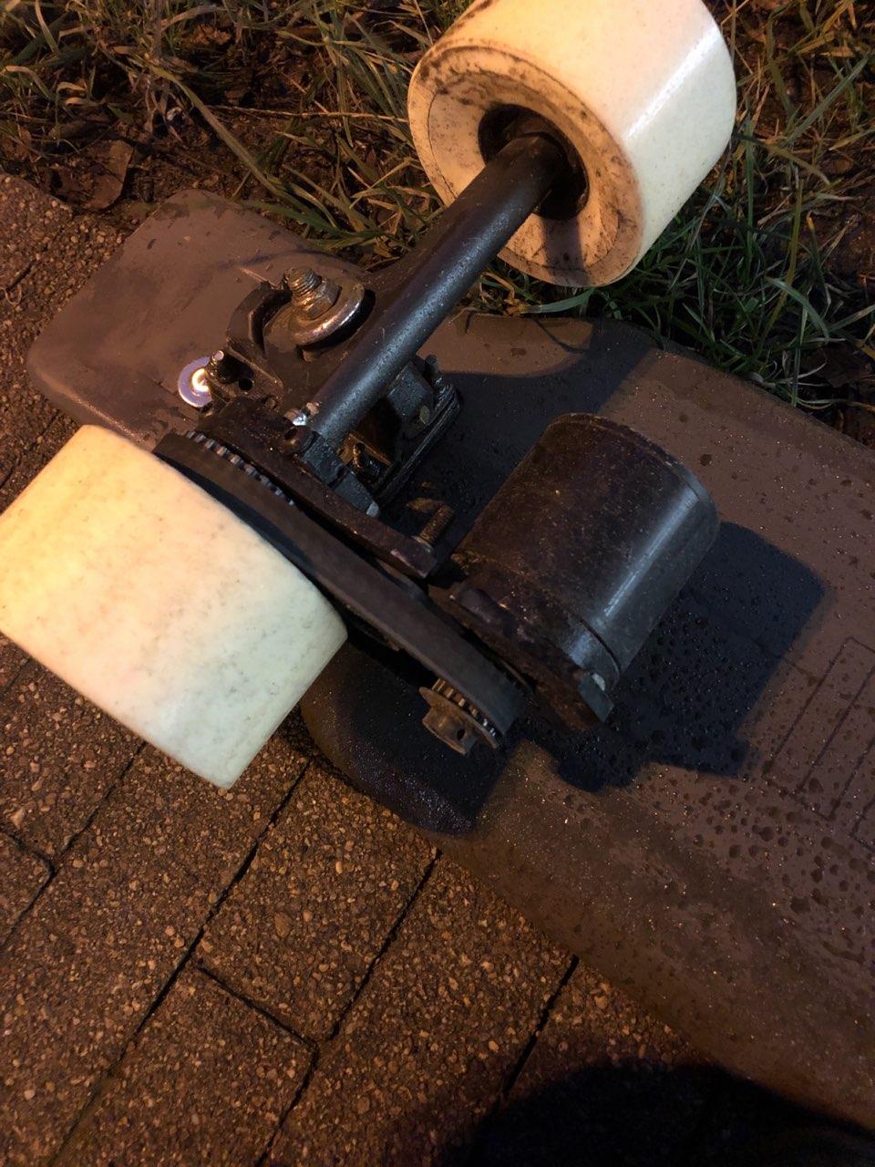

I have a question!
So I’m using this Boardnamics mount with an idler:
and I’m pretty sure that the belt actually manages to get caught by the wheel, and the wheel pulls it over the idler! Like this:
It happened once before, but I thought it was partly because my motor pulley was loose. But now it’s definitely not loose, so it really is just the wheel catching the belt I think. Has anyone else had this happen? How did you fix it?

I don’t know how you secured that mount to the truck, but swap the side its on if you can so you’ll have belt run-off towards the baseplate instead of the wheel. Also you’re not using the close ended sides of your motor pulley to limit belt movement which is why your belt is getting caught on the wheel.
Edit: Either buy a 15mm belt, a 12mm motor pulley, or move your motor mount towards the baseplate.
The mount is not symmetrical, so that is not an option unfortunately. I also think the same could happen to a 15mm belt :confused:
Besides, I’d like to upgrade to dual idlers later on, so that could still be an issue I think.
