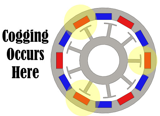

My understanding is that it’s related to reluctance, and the geometry of our stators. Basically if you’ve got magnets lined up with the stators like this: image
then the magnetic field lines have the shortest airgap to cross before reaching steel again, so those magnets don’t want to move. You could even say that they’re reluctant to move :smirk:.
Conversely if the magnets are exactly centered on the gap between two stators, then the field lines have to travel farther sideways to meet steel, which “stretches” them, storing energy like a spring. Hence the magnet wants to move away from that position.
In a perfect motor with zero cogging, you basically want the magnets trying to stay still, and the magnets trying to get away from their current position, to cancel eachother out.
This is why motors with more mutually prime magnet and stator numbers generally have less cogging than ones where they have a closer common divisor.
One way to completely eliminate cogging is to ditch steel stators altogether like inrunners do. No variation in reluctance means no cogging.

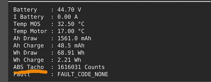

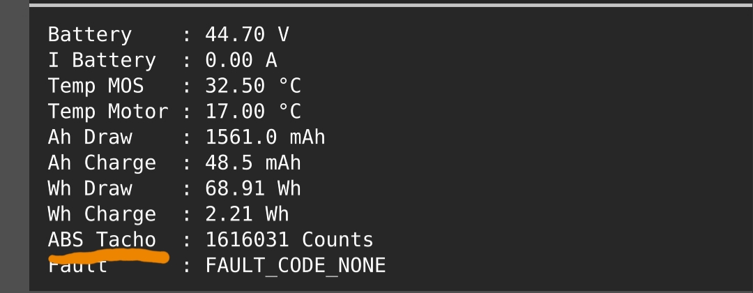

Can anyone tell me what abs tacho is?
absolute tachometer, whatever that means.
It’s the number of erpm elapsed since bootup. Similar to “distance traveled” except only in regards to motor poles and disregarding gear ratios, wheel size, or wheel slippage
thanks man

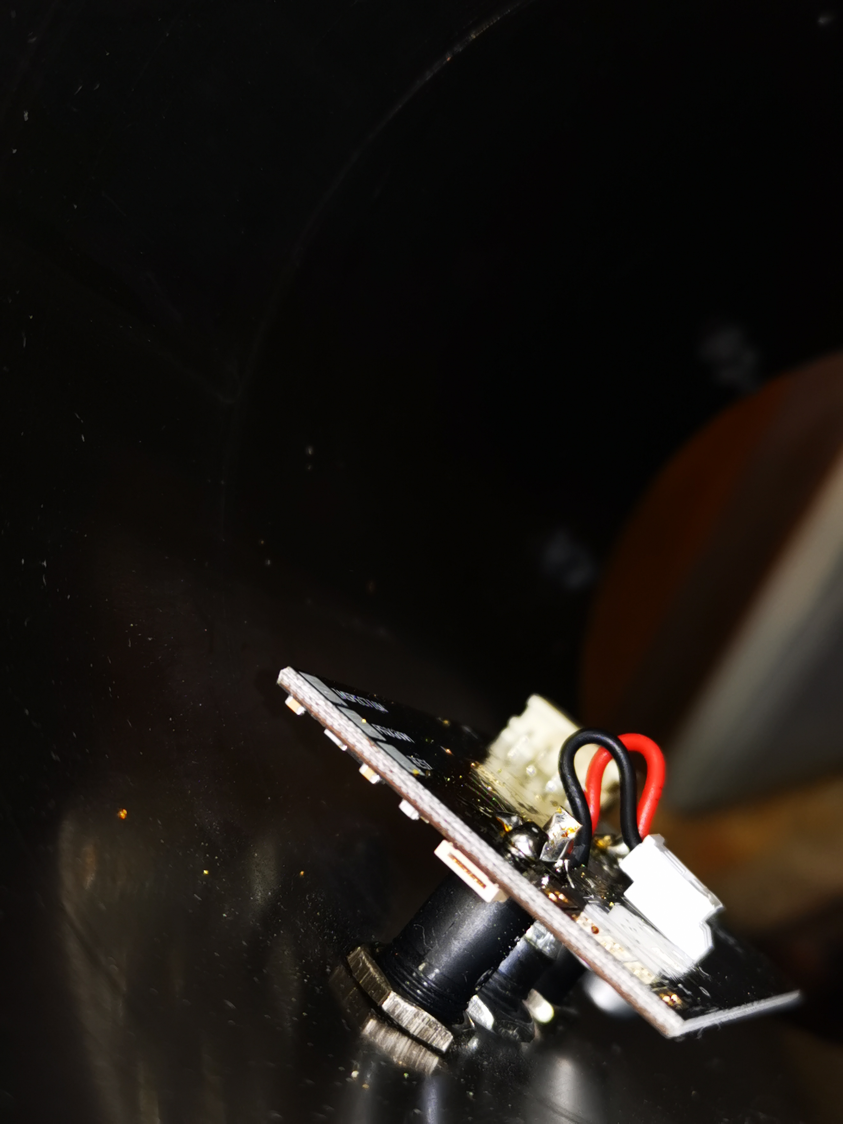

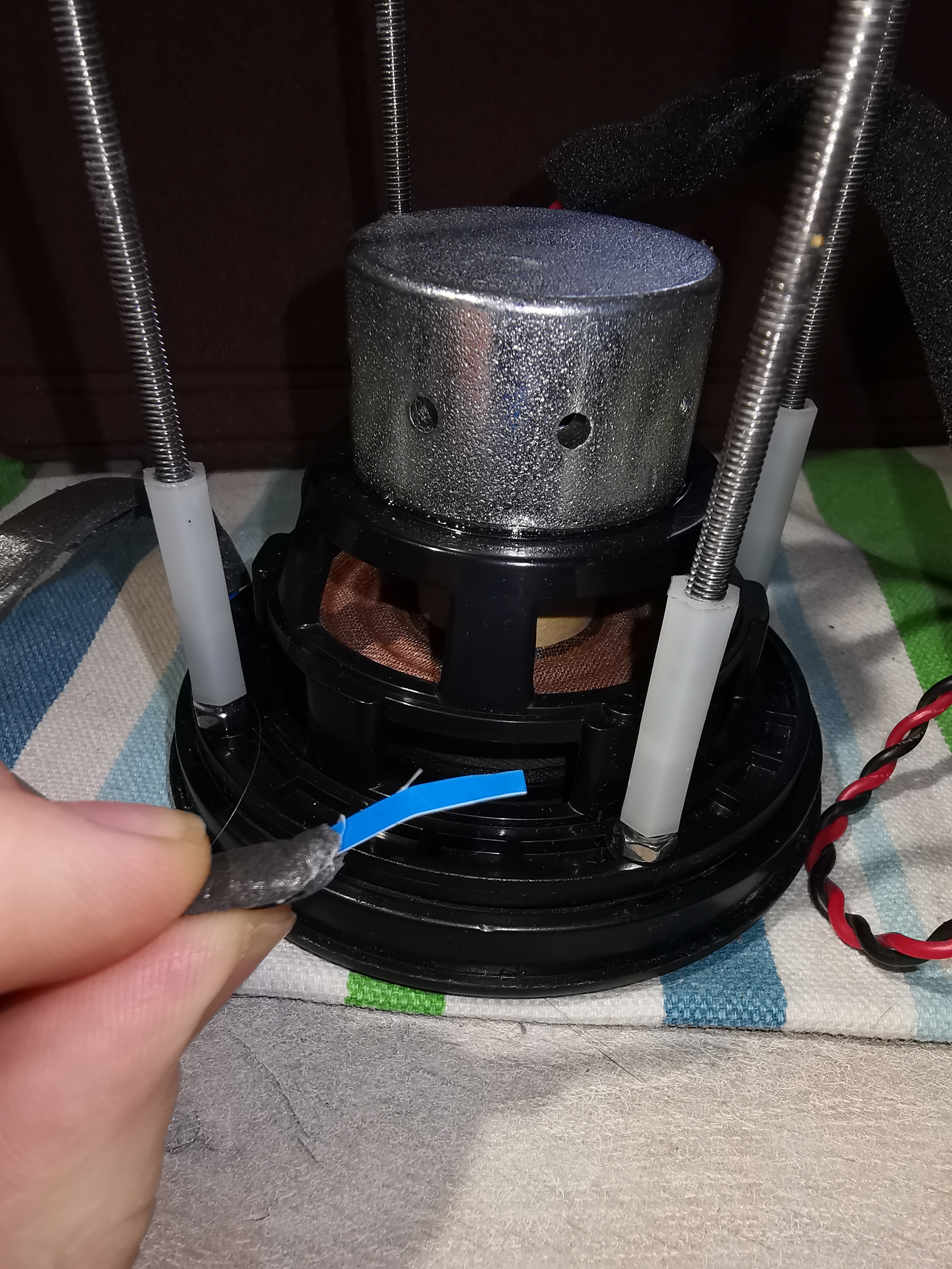

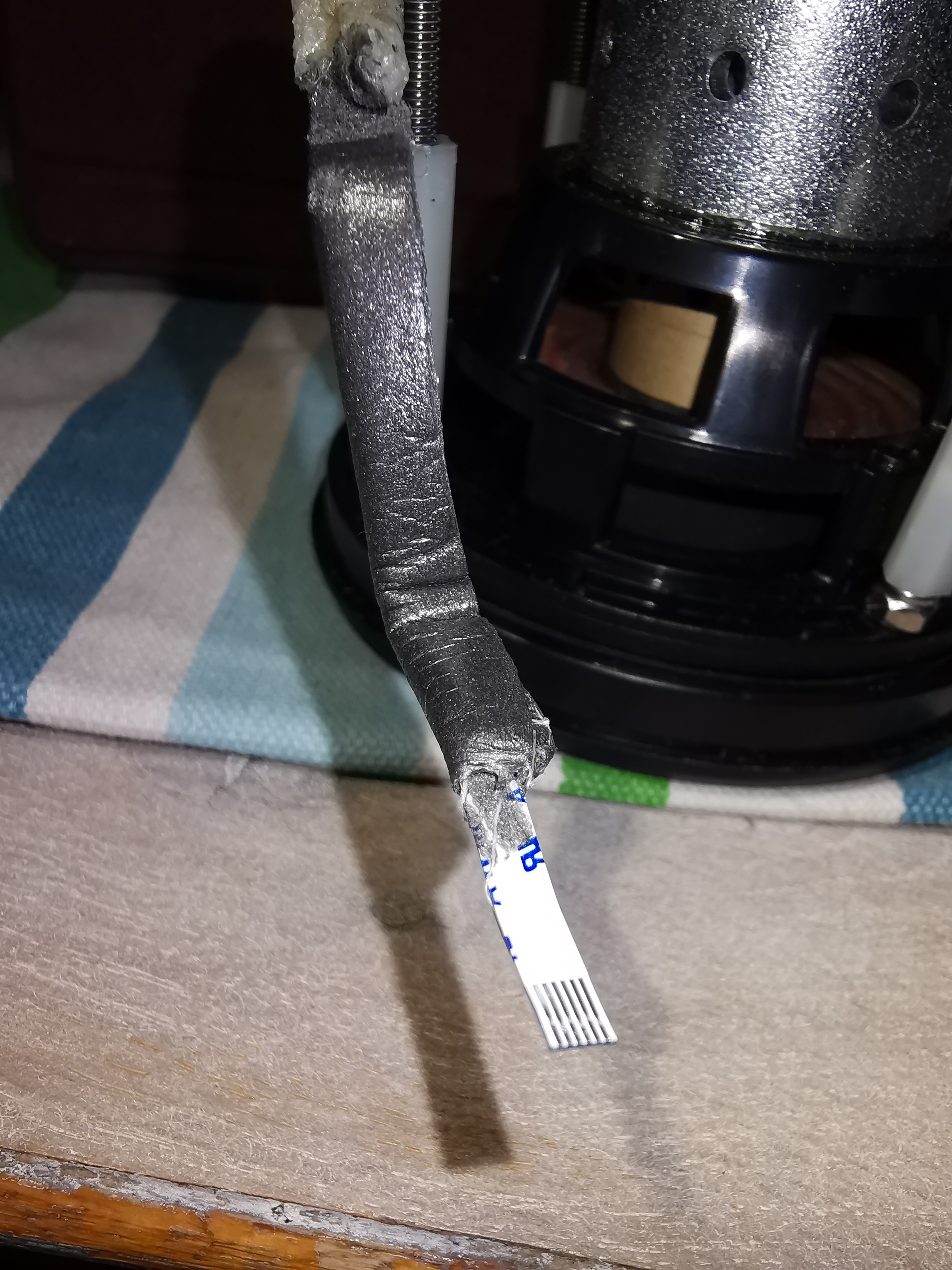

Unrelated but i have small electronics problem.
I pulled this cable out of the… Motherboard?.. Of my speaker (minrig subwoofer 1 gen)
I don’t know what this connector is called but how do you plug it back in and which way does it go?
Calling speaker guys @SimosMCmuffin and @Pedrodemio
It still happens via my bluetooth module
Just stuff it back in, it’s a friction fit. If it doesn’t work, flip the ribbon over and try again.
You may be able to look very carefully inside the connector and see if the contacts are on the top or on the bottom, and orient the ribbon accordingly.
