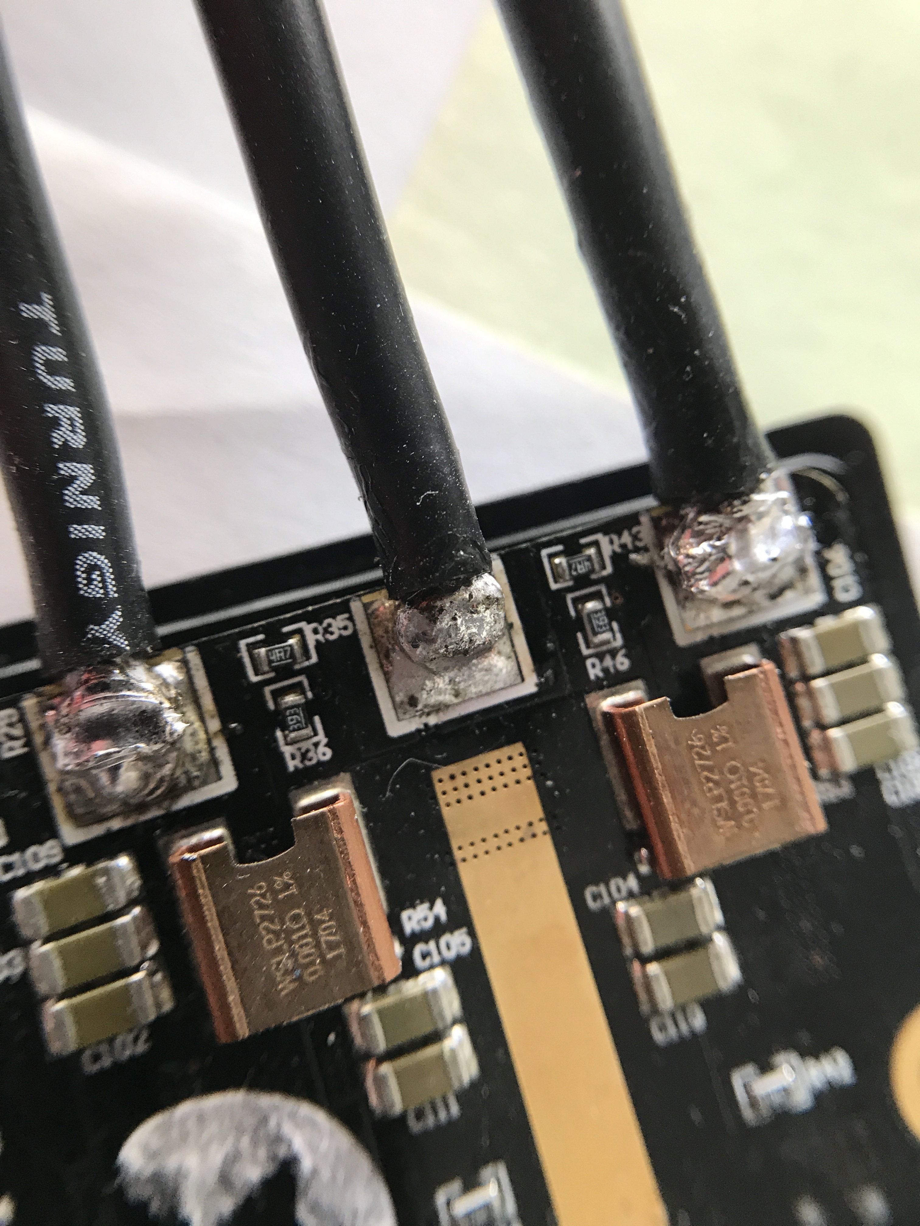

Can someone review this solder job?
Iā€™m a noob at this but it seems to stick on it and not move.
The problem generally isnā€™t mechanical strength with solder joints, even cold solder joints can be very difficult to remove however the resistance at the point of PCB -> Phase wire will be really high and can throw off inductance and resistance measurements. Those solder joints are okay, but try using more flux, more heat for a longer time and more solder.
Left looks good, right okay, but middle looks iffy.
