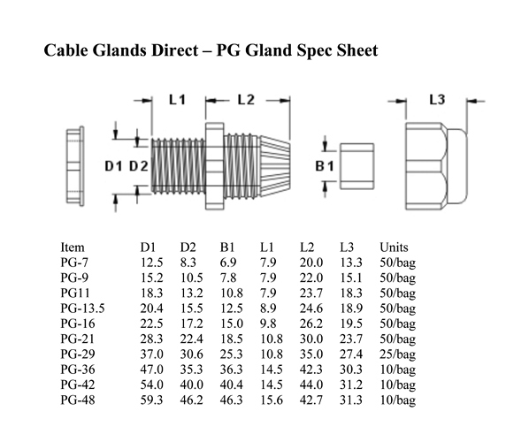

I got 6 phase wires and 2 sensor cables through a pg21 for reference

I looked at the chart @Venom121212 posted, and realized you can get some more space by removing the rubber thing that B1 measures in the pic.
By removing that I could almost get the connector through, but there’s a small plastic lip preventing it from going all the way. Since PG-7 should be .5mm larger, then maybe you could fit it through like that? I’m just not sure how waterproof that would still be.

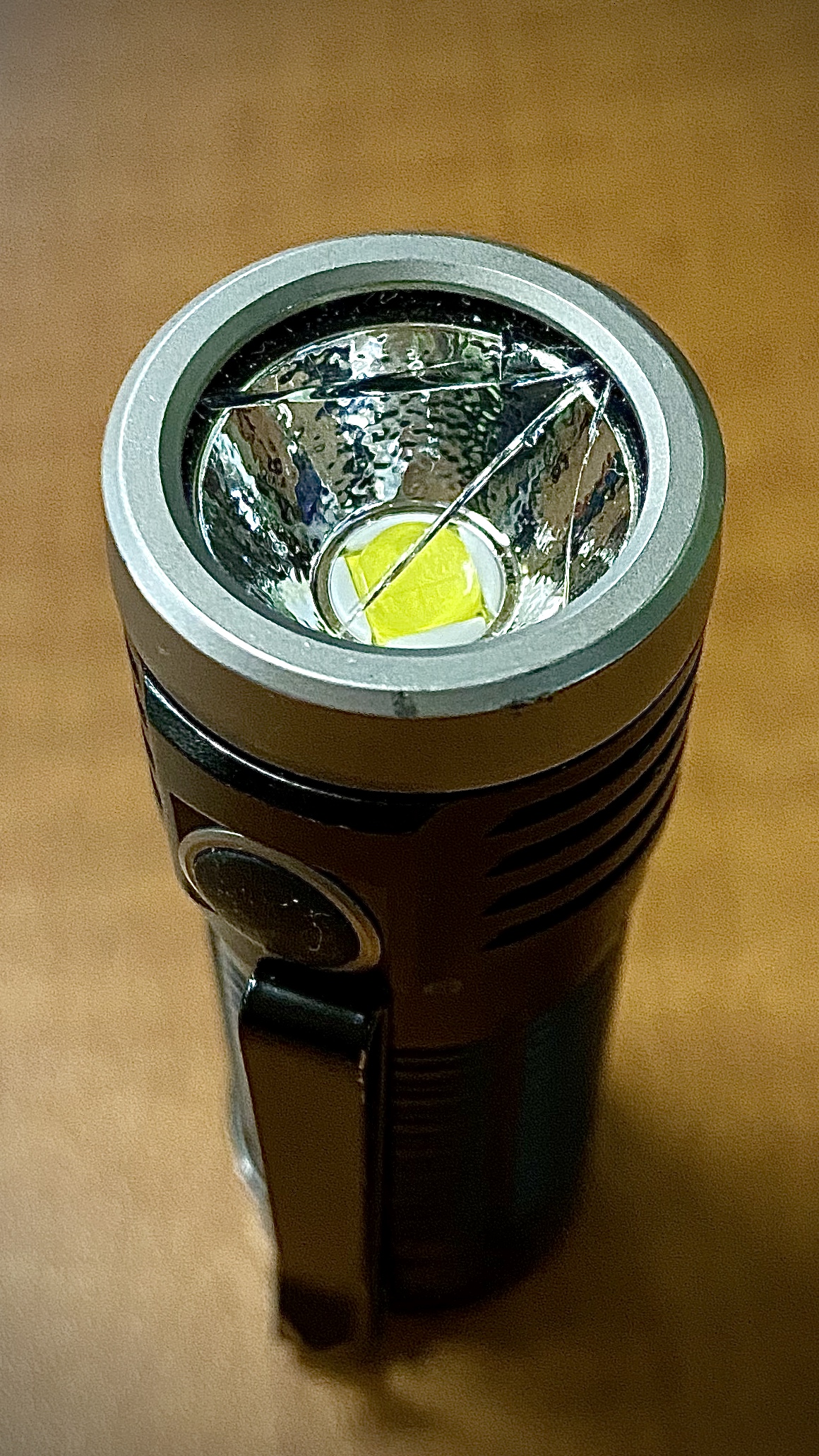

How do you waterproof such a fracture without furthercompromising the optical properties of the lens?
Use UV cure liquid glass resin. Same stuff they use for windshield repair. Liquid wicks into the crack, hit it with UV to cure.
Thank you!
You may also be able to get replacement lenses from various places. What light is that?
It is a ThruNite T1. They already sent me a replacement light, but I’d like to fix this one up because it’s still perfectly functional (and awesome).
If you happen to know where to get a lens for cheaper than a UV cure kit, that would be lovely.
