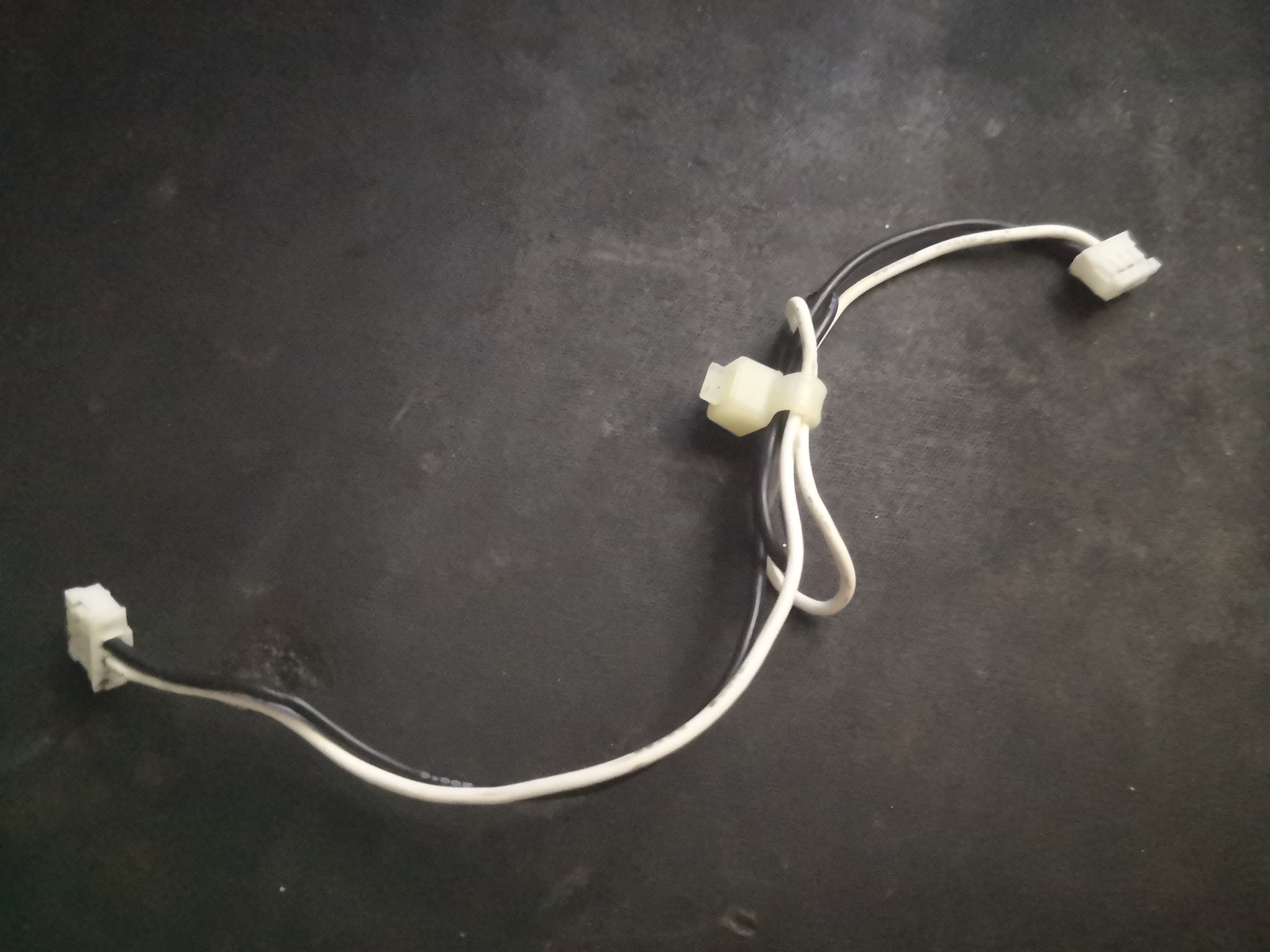

One more query…it looks like i need to buy a can bus cable to connect the 2 FSescs… does anyone know where to buy these in EU?
I do not have one, so unless i can build it, i need to buy it. Thanks in advance!

It’s 2x JST 4 pin 2.00mm pitch cables using only the middle two pins (Can H and Can L) in parallel. If you cant find anyone to give/sell you one let me know and I’ll send one over, but I’m from Canada so it’s probably the least efficient solution.

Thanks so much. I hope I can source that cable more easily but really appreciate your proposal and the clarification.
then why dos the link above have 4?

Canbus.
