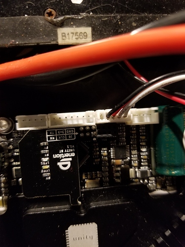

Anyone know why my remote wouldn’t connect to the unity focbox, ive gone through the app wizard twice now with no success
Any chance you have it plugged into the wrong receiver pin channel or its flipped around ?
i don’t think so, but i can look back at older pictures to see, if it were would it straight just not work?

I plug it into the right side 3 pin, I don’t see any other place for it.
This would be the problem part right?
Yes that would be the part. If you’ve never removed that black silicone before, it’s certainly the right pins.
As to the unity shutting off randomly, it reboots after I update firmware but other than that, it doesn’t.
Try spinning the motor every minute or so while it’s connected to the unity to keep it “awake”.
One of the old firmwares didn’t stop it from timing out on firmware updates.
what would the part be called i think i need a new one, it wont connect to my remote, and i have two neither works, i took off the silicone to see if there were any identifiable problems
if it were to turn off while riding what would cause that
That part is called a remote receiver. I’d just look into getting a new remote entirely. The mini remote is dead reliable and battle tested for pretty cheap.
