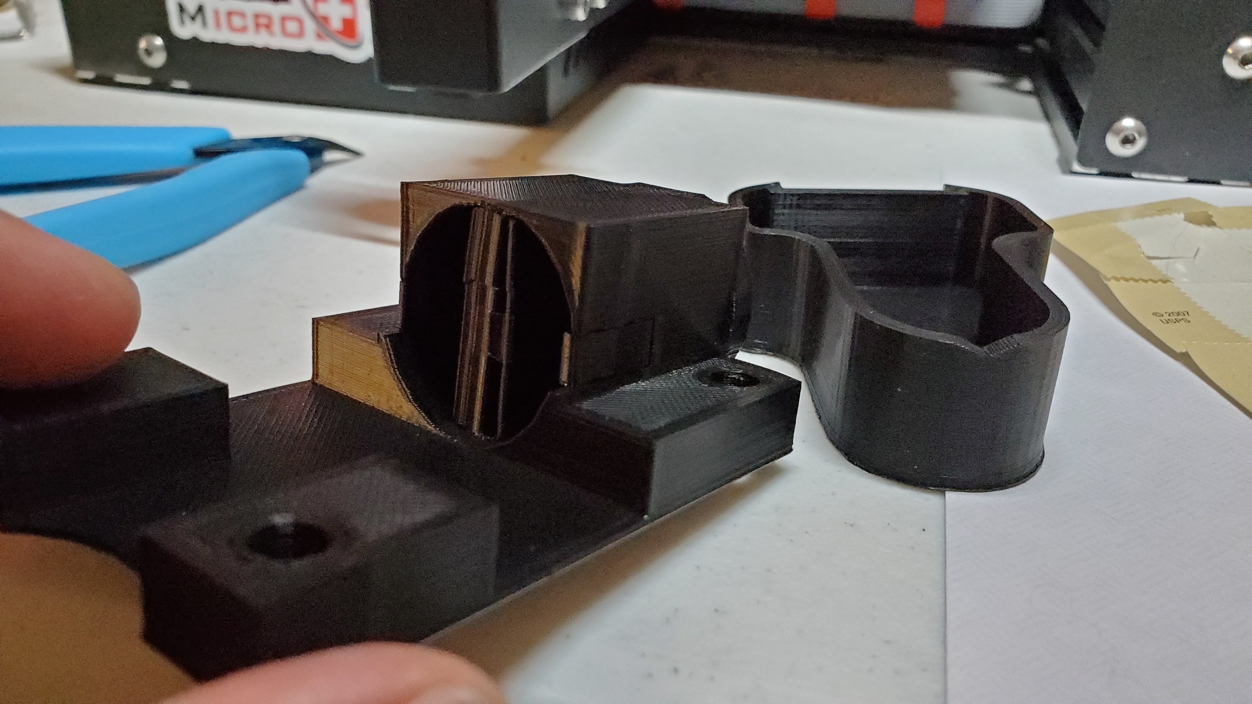

3D printed PETG risers; bad idea? It’s going to be sandwiched between other normal risers
I’d try it and not be scared. Risers tend to not fail very often.
The only riser failure I’ve had, the board was COMPLETELY ridable semi-safely and just occasionally (usually after a bigger bump) it’d jerk to one side and a little counterlean straightened it out. Turns out the whole truck was loose on the deck from a smashed riser.

I’m still using my petg riser with no issue. As long as it’s not super tall, I don’t think it experiences much force other than compression.
The big block on the back holds a tail light if you were curious why anyone would shape a riser like that.
