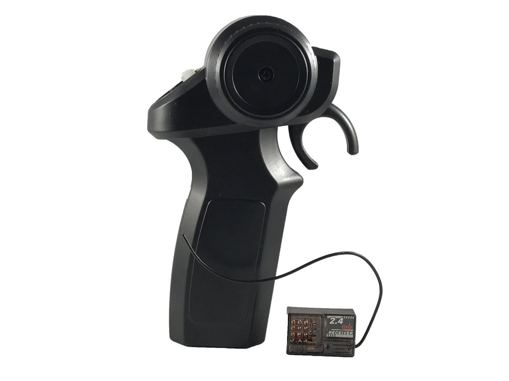

how much is the mini remote, does it come with the part i need
Mini remote is about $20USD and it comes with a really rugged and reliable receiver/transmitter.
Do you got a link I could use I can’t seem to find it, thanks for everything this is lit
Here’s one from @BuildKitBoards, he ships real quick
Sorry I keep tagging you Jared :sweat_smile:
[AU$51.02]Mini 2.4Ghz Wireless Remote Controller With Receiver For Electric Skateboard Longboard Electronic Components & DIY Kits from Electronics on banggood.com
https://banggood.app.link/KLttw3Mrw3
Both are rock solid this is more lowkey if you esk8 laws are suss.

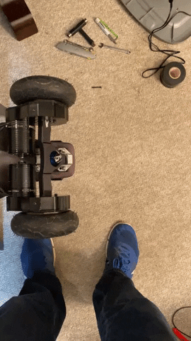

A friend gave me his broken koowheel d3m.
The esc was dead. I found out koowheel used the standard hobbywing esc. Koowheel wanted 160€ for a replacement. Ownboard sells a hobbywing esc for only 50 bucks (including remote) !
I obviously went for the ownboard esc.
While the esc is identical, with only differing connectors, I can’t get it to work, both motors make this horrible noise at higher RPMs.
Here a video of the best possible wiring combination I found (please remove the space between youtu. And be
youtu. be/uIoUmGABAHE
The motors look splendid from the inside (can’t post images :frowning:
Does anyone have an idea? I’m out of options

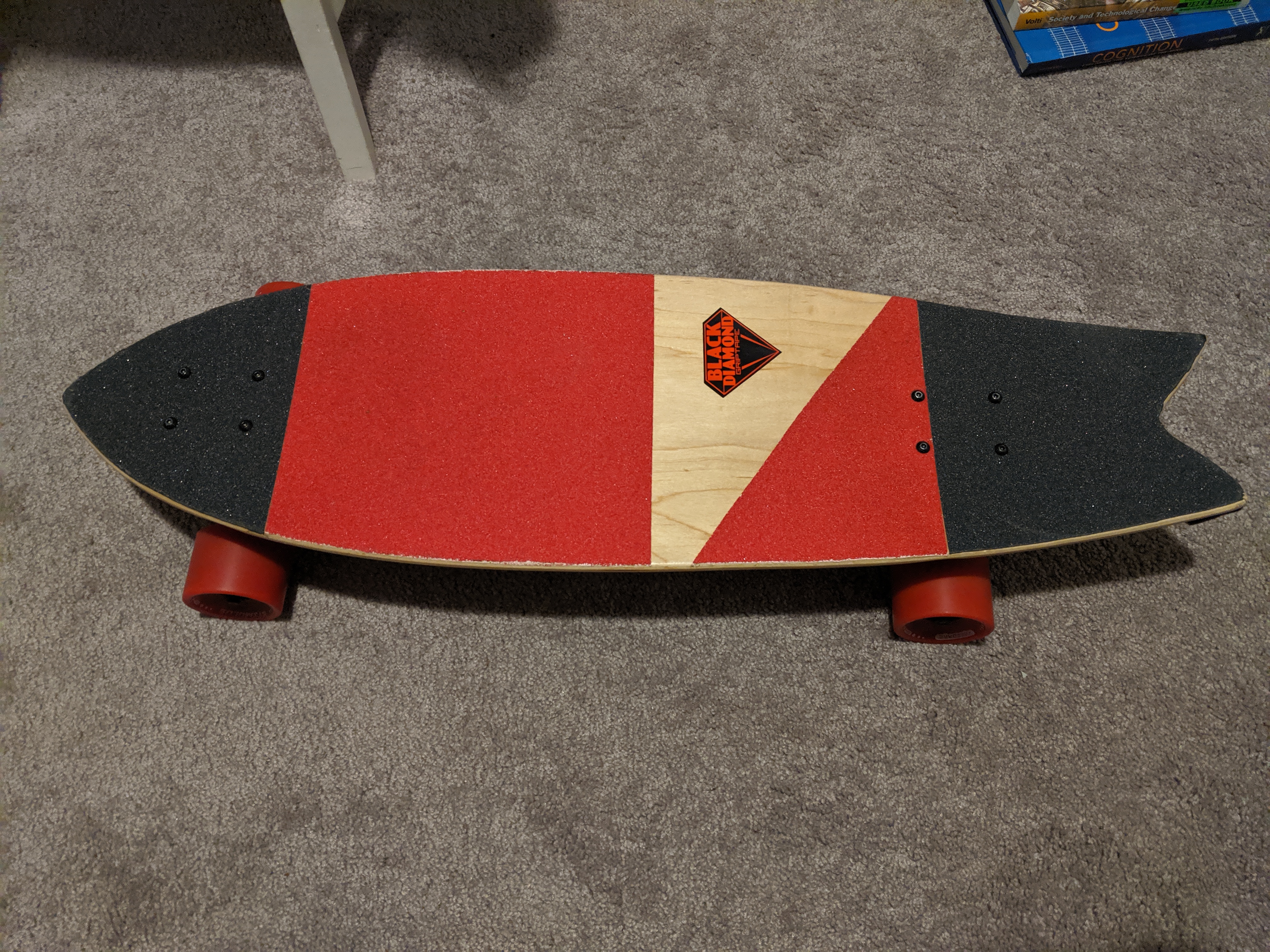

So I just bought some boardmanics mounts (non-idler) and want to build a short board with 85mm cags eventually…
I was thinking some 160kv Flipsky motors, 13s1p A123 LiFePO4 pack, 36t torqueboard 12mm pulleys, caliber 2’s, and maybe a maker-x dual esc + an anti-spark. Thoughts?
here’s the board 36"
