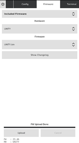

What is latest Unity firmware? Iā€™m on 23.46
Donā€™t know why that replied to you, but Iā€™ll leave it uhhhā€¦ Like that.
