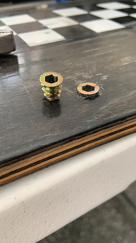

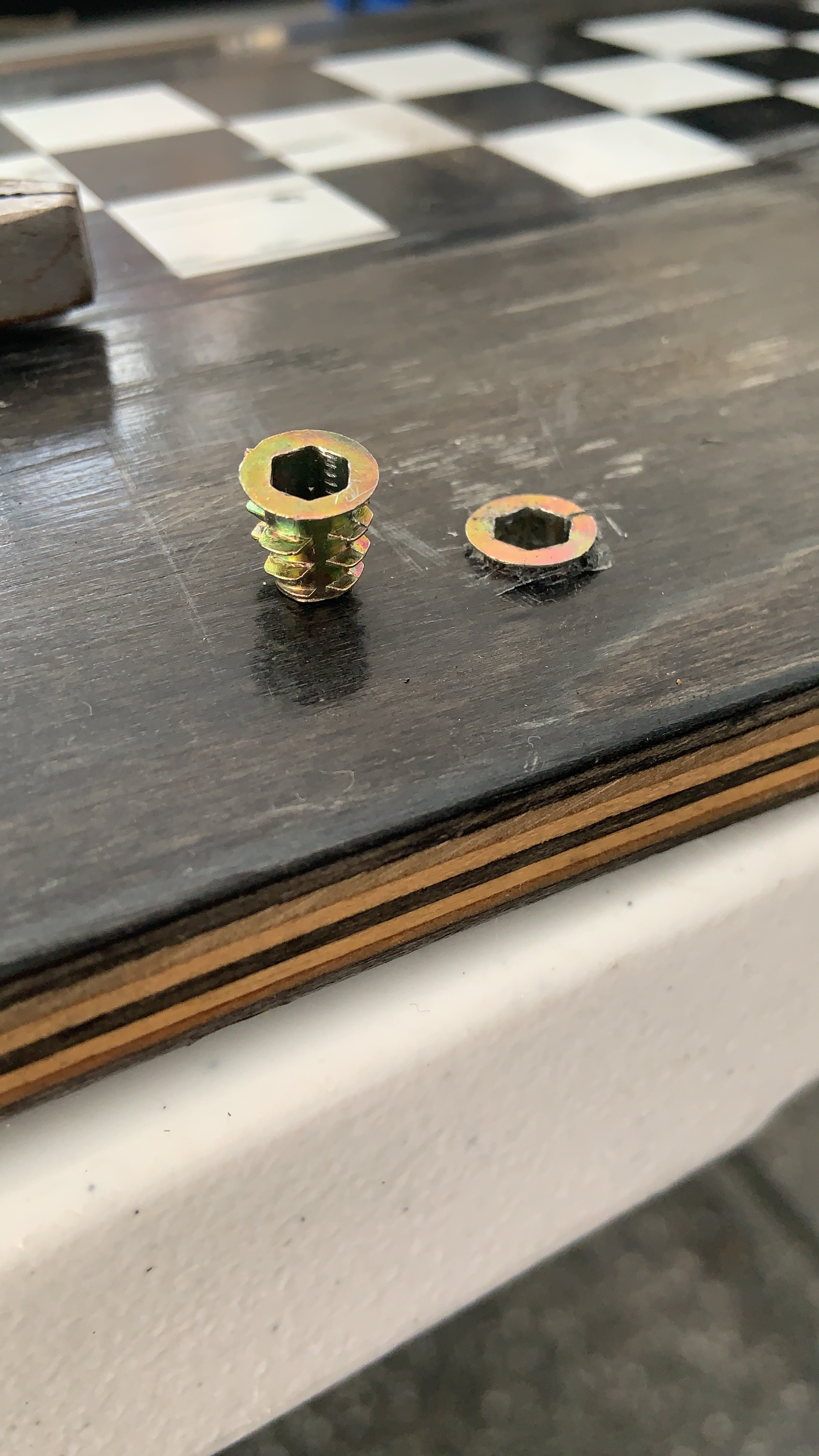

Do these Brass bolt ā€˜plugs/anchors’ have a specific name? @torqueboards?
Probably M5x10mm brass soft wood threaded inserts
This :arrow_double_up:
If you can tell me what size hex key fits in there, I can tell you if it’s m5 or m6
Put a nut onto a screw that fits into the brass insert then screw the nut screw combo into the insert then can turn the nut down a bit so it and the brass insert lock onto the screw threads then just screw in the whole screw nut brass insert together until it is most of the way in and can avoid cracking them during insertion.
Unrelated sidenote - All the ones I’ve run across that look like that aren’t actually made of brass, but rather cast zinc/pot metal.
It’s pretty easy to strip them out when installing.
If their a way to change the modes with a unity and hoyt puck
This exactly so best to use the bolt in method rather than the allen wrench. They are cast furniture inserts a la Ikea and the like.
They do work but can be a handful to install. The good thing though is if you got to Ikea and hit the free spare assembly parts section they cost nothing. I am a cheap bastard.
they actually have that service? awesome… who’d a known… I’m going to check this out next time i’m by their store!
Not sure about the Us but as you leave the labyrinth there should be a wall with those clip on buckets with all the shit you routinely lose while building their stuff. Free inserts.
Pennies off a dead man’s eyes, you.
@Swish Yeah, those are standard M5 Wood Inserts which are typically available everywhere. We have some upgraded ones but I don’t seem to have any photos atm.
