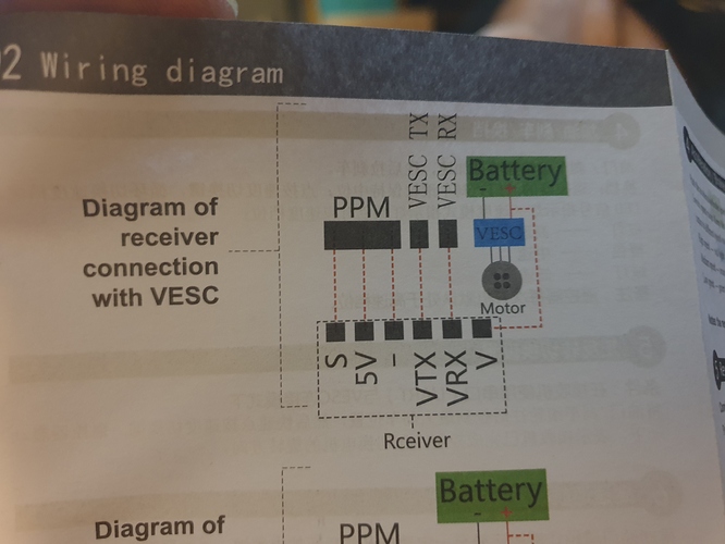

Ok i think I have this vx1 receiver wired up right but it’s not powering on…
I’m using the ppm connector from the esc to the S, 5v and gnd of the receiver (black white and red), and then single pins from the RX and TX ports of the esc to the receiver (red and orange), and positive of vesc power in to receiver (blue).
But the receiver won’t power on… am i missing something?
Edit: I ended up bending the pins because I was lazy. Possible I fucked the receiver? I did it very gently one by one and it seemed fine at the time :sweat_smile:

you’re fucked
Yes I believe so :rofl: i know a guy who got a dead receiver straight out of the box and flipsky will not send a receiver alone. He had to do a paypal claim.
You can get the pair for $30 shipped in the VX1/2 GB, and you’ll have a spare remote if you crash one
I’m not gonna replace a piece of shit with the same piece of shit. Got a benchwheel remote coming today hopefully, will use that instead.
This is officially the last piece of flipsky shit that I ever touch.
