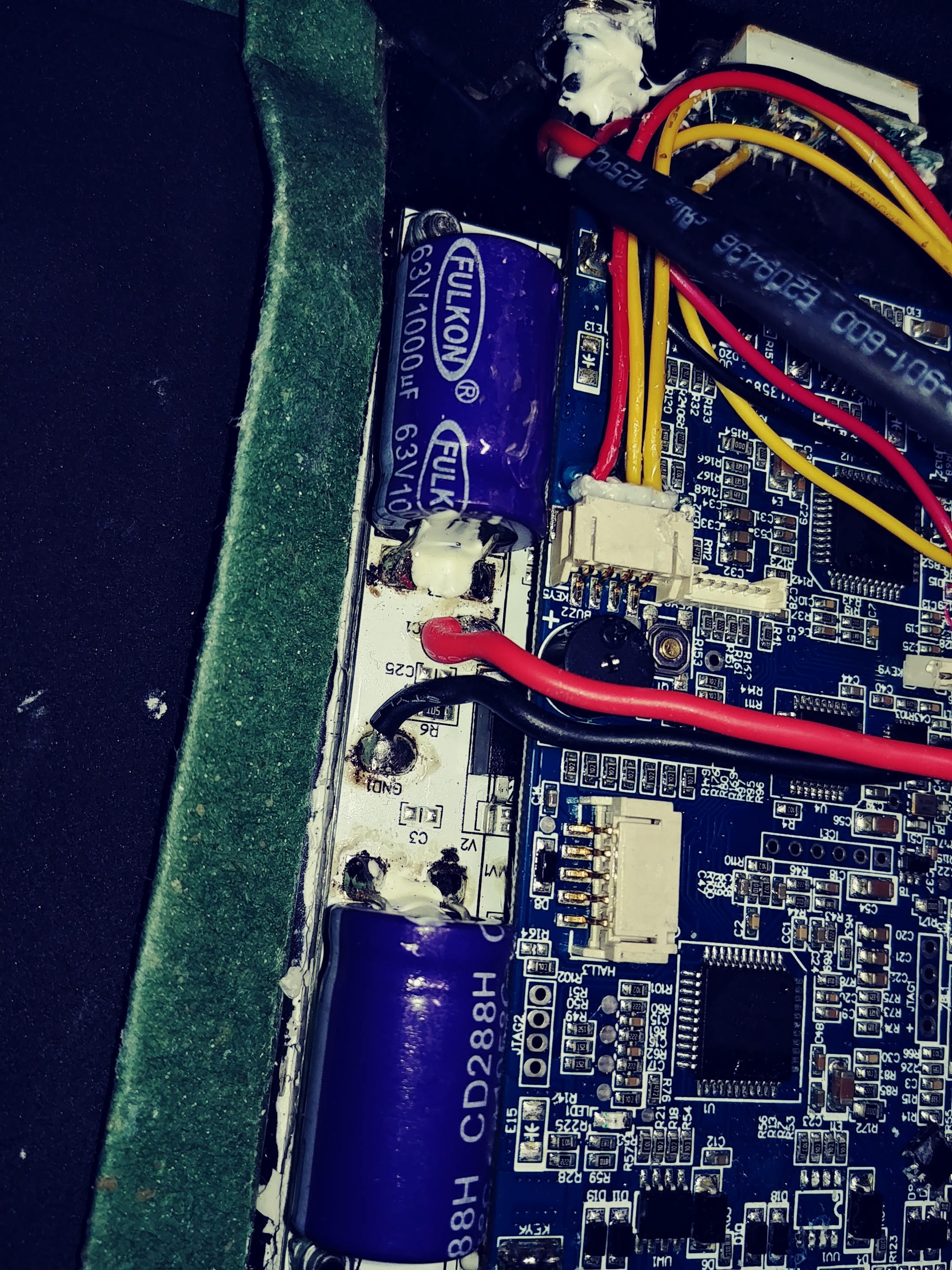

How do you people safely discharge capacitors? (In my case, on a Focbox, before I remove a faulty CAN chip)
Lick it, should taste like a really spicy 9V battery
lmao :laughing:
With a screwdriver really just tap it between the leads is there a problem with doing this? Never noticed one.
Hmm just read online that using a voltmeter is a good way, as you can see the voltage going down. In my case it showed zero when I connected it to the XT-60, so I guess it was safe to begin with lol
